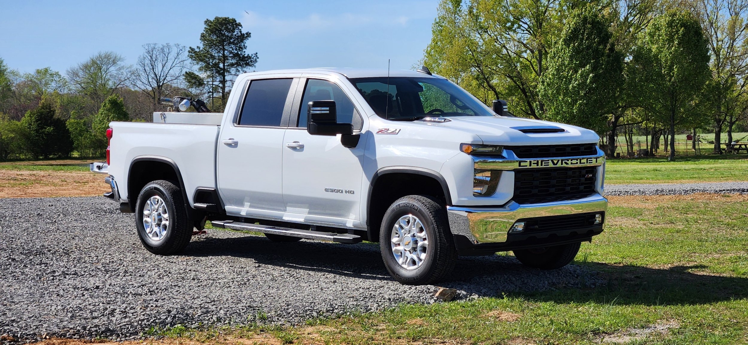

I've had my truck for several months now and have put 15,000 or so miles on it. I got it with around 25,000 miles and am up to about 42,000 now. The whole time I've had it I've gotten around 16.5 MPG empty and around 12.5 on an average hauling trip. I had the dealership change the oil until it got out of the 36,000 mile warranty and I did my own at around the 40,000 mark. Immediately after changing the oil my unloaded average is up to a little over 19mpg and my haul has bumped up to a little over 15mpg. I took an unloaded trip with my wife that was about 600 total miles and we got almost 22mpg. Seems rather odd to me? I used Rotella T6 and an Autozone K&N filter. The immediate change makes me think the oil caused better fuel economy but I have never heard of that before. What say you?

2019 F150 SuperCrew Long Bed w/ 5.0 Coyote, 75k miles.. I drive a pretty consistent route and pretty consistent days and was averaging right at 16.5mpg combined while running my dealership's 5w20 synthetic blend (supposedly). I switched to Pennzoil's Ultra Platinum 5w-30 full synthetic in May, and not only does it run much quieter, the Average is up to 17.5mpg w/o resetting the dash (so the real MPG is higher). I have never had a change from Dino or Blend to Full Synth have such a profound effect before (if at all), but there is something going on here and it shouldn't be the weight change as the Ultra's viscosity is barely in the 30 range, so barely more than a Blended 20.
