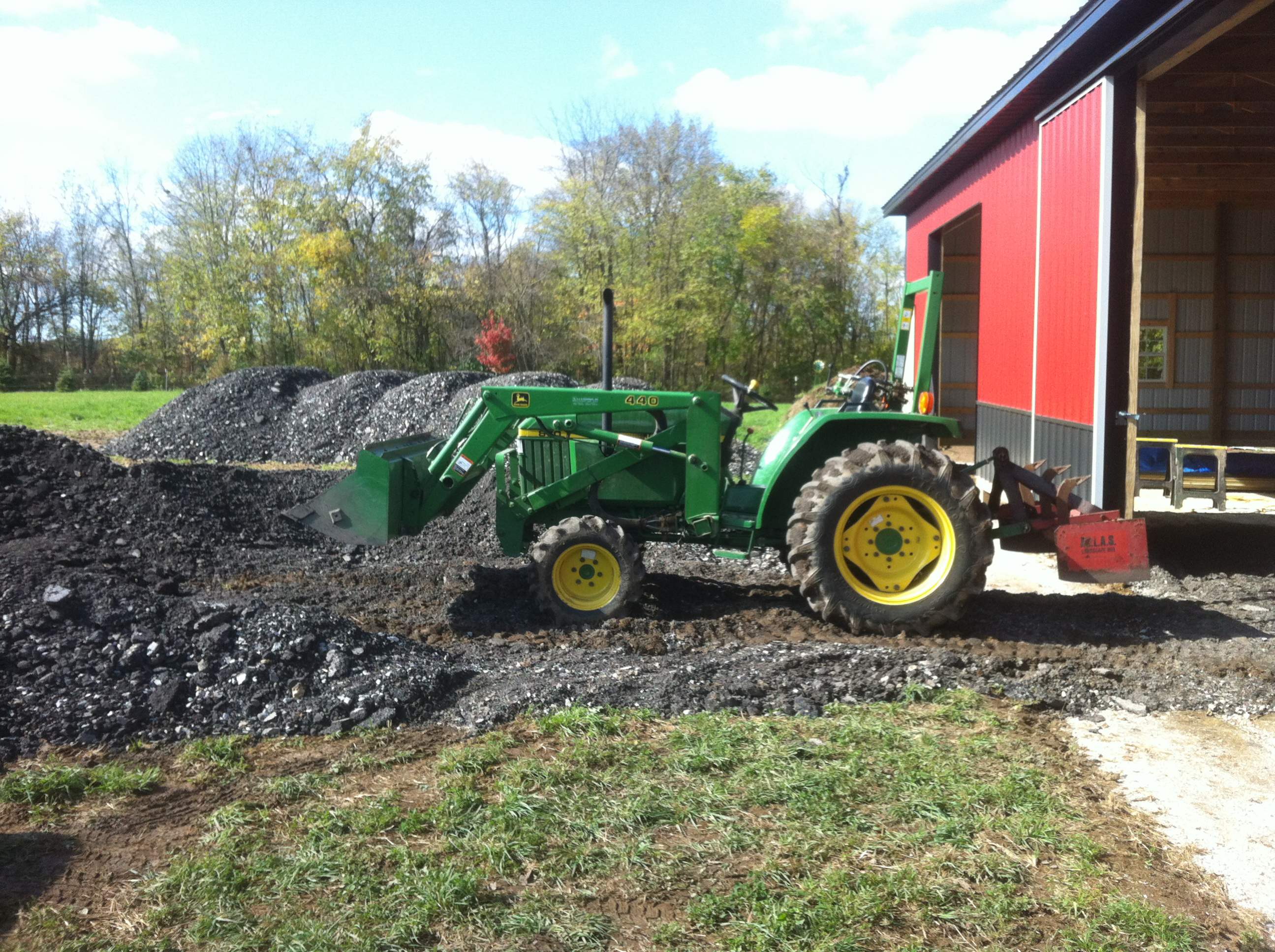

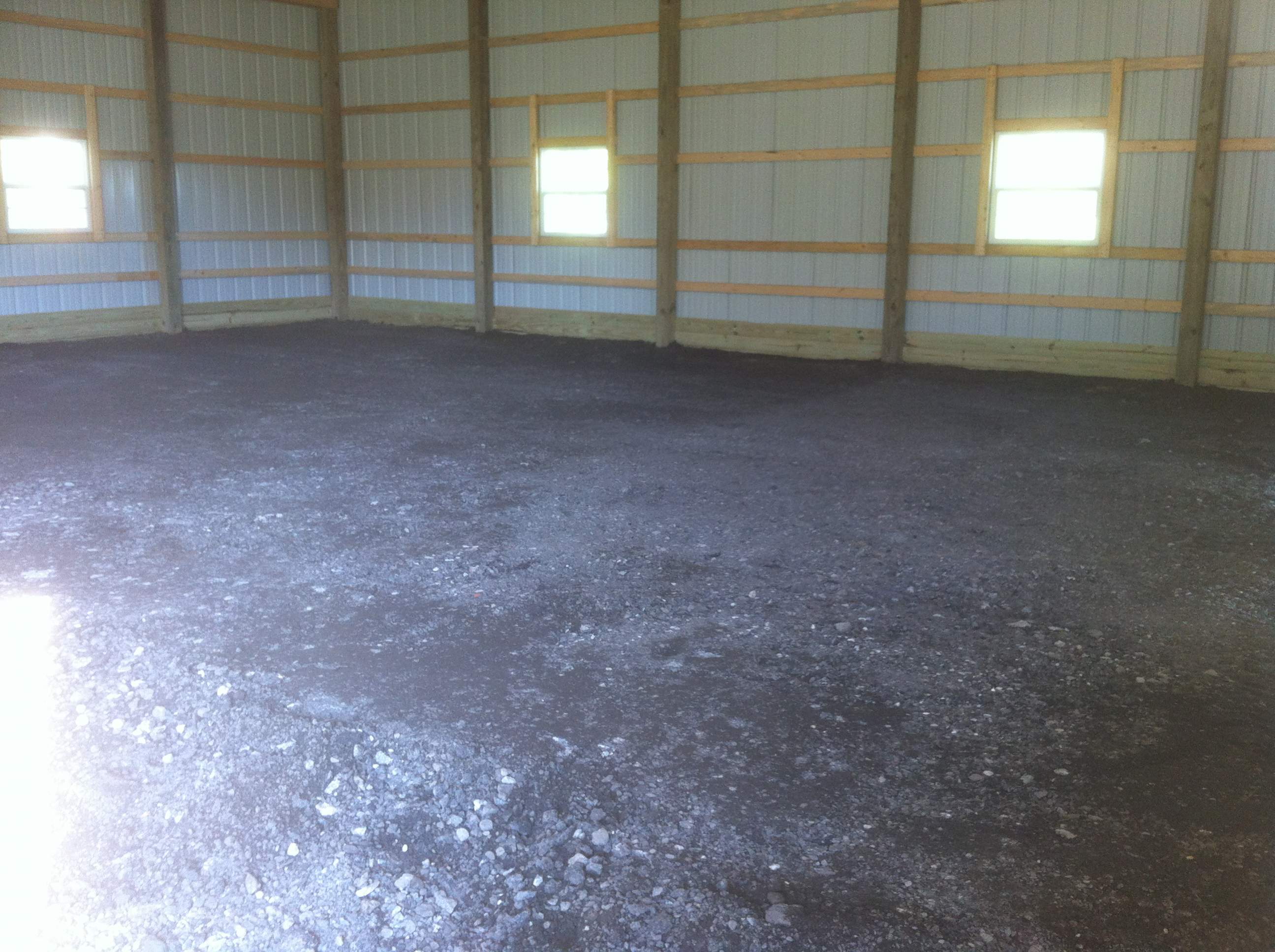

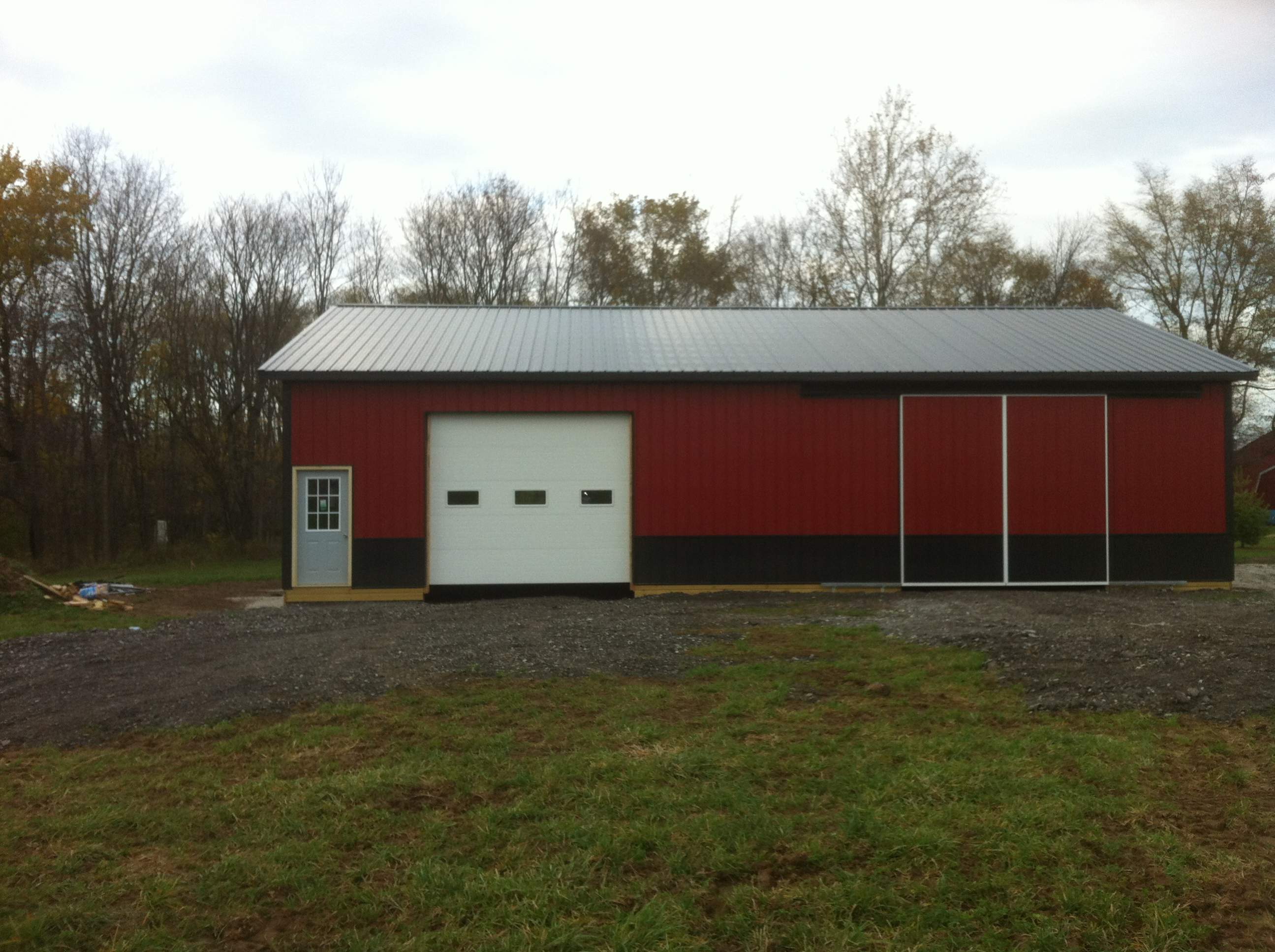

#28
Though I'd update all on the progress of my barn build. After initial 6 day build. Things slowed down with haveing to add LOTS of fill to get to the grade I needed. Fill now complete, waiting on spring to install construction drive for new home build and to pour floor in barn floor and get back to finishing off inside!

   / Indiana pole barn project #29
I have to say, that is a very sharp looking building, I think you did very well.
   / Indiana pole barn project #30
Great looking barn. I am impressed by the gravel floor. How did you get it compacted so smooth and level?:thumbsup:
