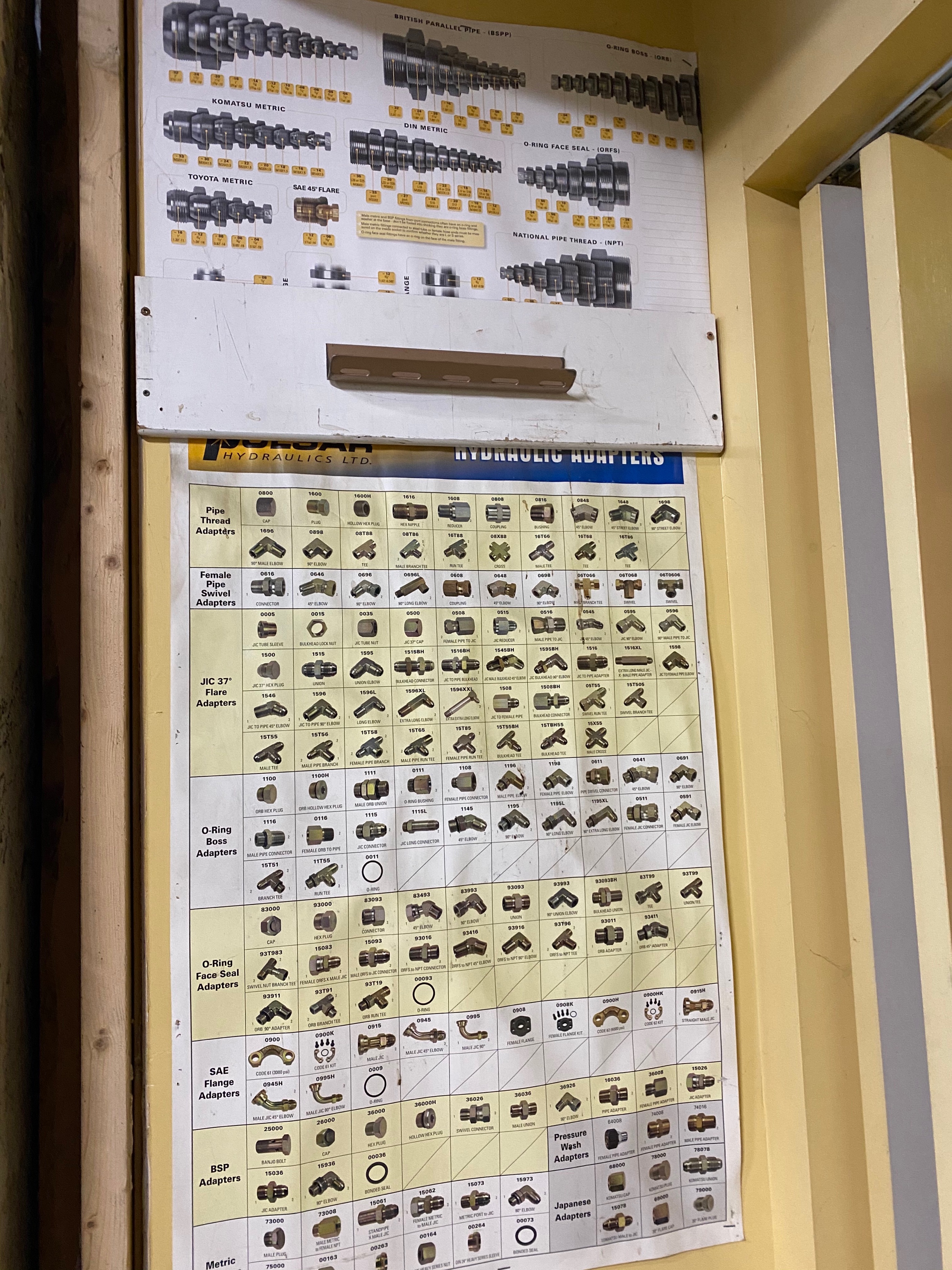

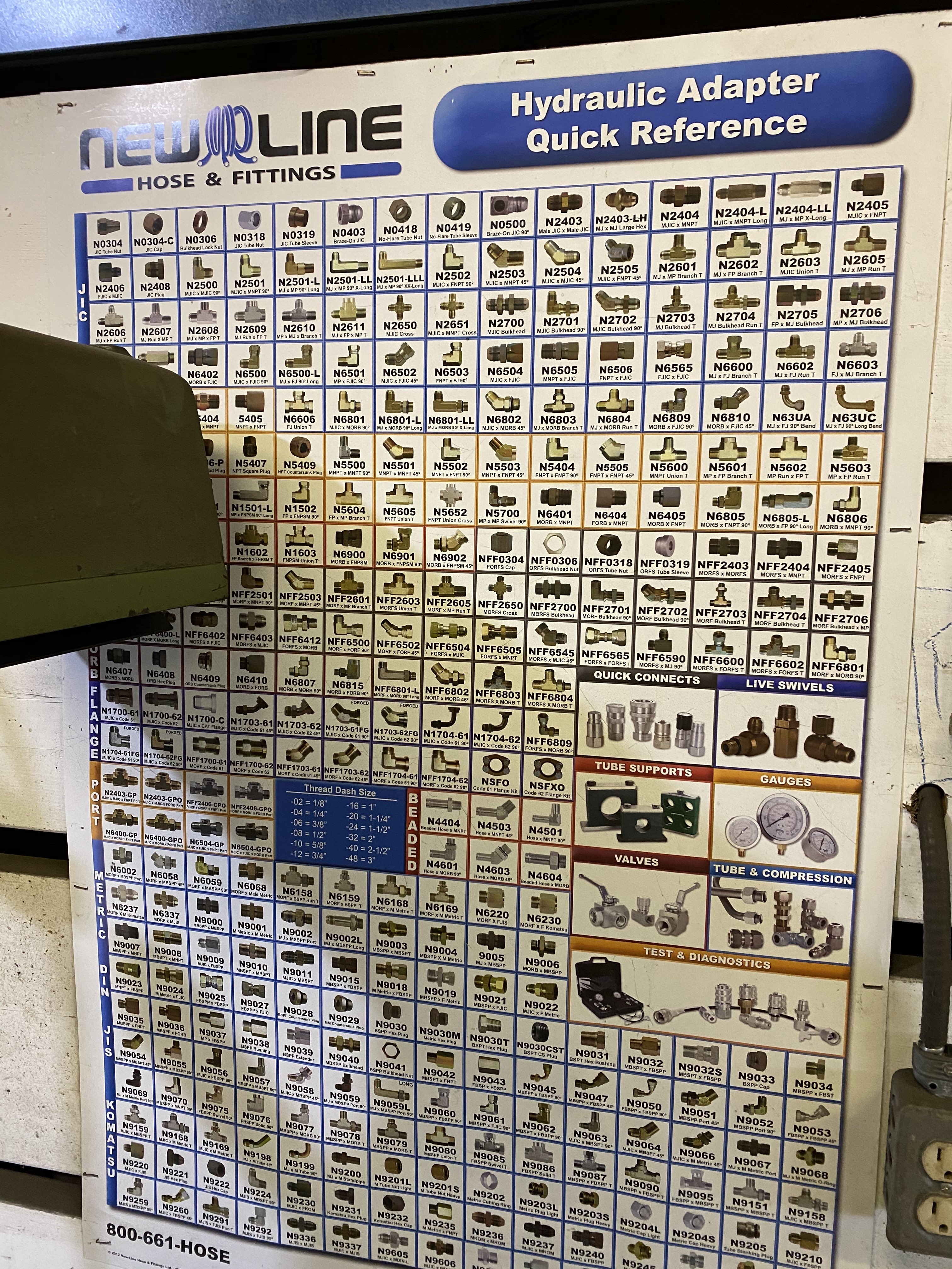

Next time you visit your hydraulic supply store ask them for a quick reference wall chart or catalogs.

I looked carefully at your pictures and did not see the play girls.
