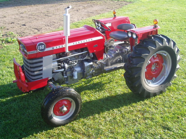

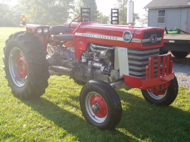

Get to know Big Dean Austin.
Big Dean's Massey Ferguson tips
Get his CD on the 100 series. Visit his website. He'll tell you all the things you need to check.
Get the owners, service, and parts manuals from AGCO/Massey Ferguson. Skip I&T manual. Not very good on Masseys.
Watch the front axle center pivot. Loaders on 135's will wear that out quick.
If you're interested, I've got a couple good connections with folks that specialize in Masseys that live not too far from you. PM me if you need their names.
LOVE THOSE MASSEY'S!!!!

FWJ: are those photos of your recently repainted MF-150? Sure looks great.
   / Info & advice needed on a MF135 #5
I still have to re-paint the hood. It didn't turn out like I wanted on round one. I've also bought a NOS grill off of EBAY. gonna install it when the hood is off. Then it's time to mount the ROPS and canopy, then re-install remote hydraulics. After that, ?????
Not done yet.........
Will it EVER be done?
