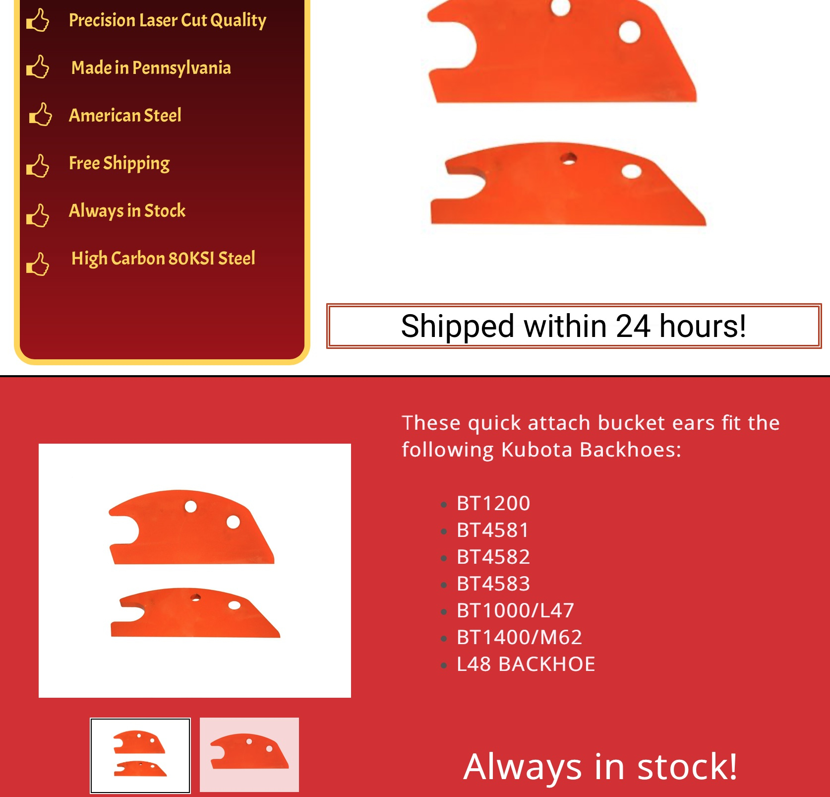

BACKHOE BUCKETS:
1. did you decide on pin or QA for the bucket attachment method? The buckets are not interchangeable because the ears are different. Your dealer will sell ears that can be welded onto any bucket. If he doesn't, there are plenty of places that only make ears, and others that only make buckets.
2. There are a several small quality US manufacturers that make custom buckets to fit any hoe. Cost is less than dealers charge, or at worst no more.
3. One bucket will do to start. I rarely change my BH bucket & prefer the 12" wide one. It works in our soil best. lThe size depends on your hoe and your soil type. I'd say don't go over 18" or under 12" width for your everyday bucket.. If you have clay in your soil it can be hard to empty a 12" bucket. Sticks to the sides... And at 24" bucket we are getting too wide for cutting through soil if there are many rocks. I'd say 14 to 20 wide is the sweet spot on a small hoe. I lean more toward smaller rather than larger.

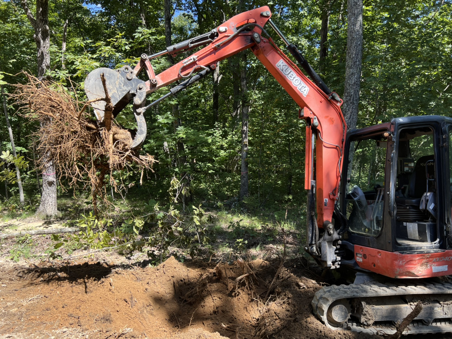

The first serious thing you should do is rent or lease a FECON track drive mulcher
to save yourself thousands of dollars, and hundreds of hours of work and
do all your land clearing FIRST.
