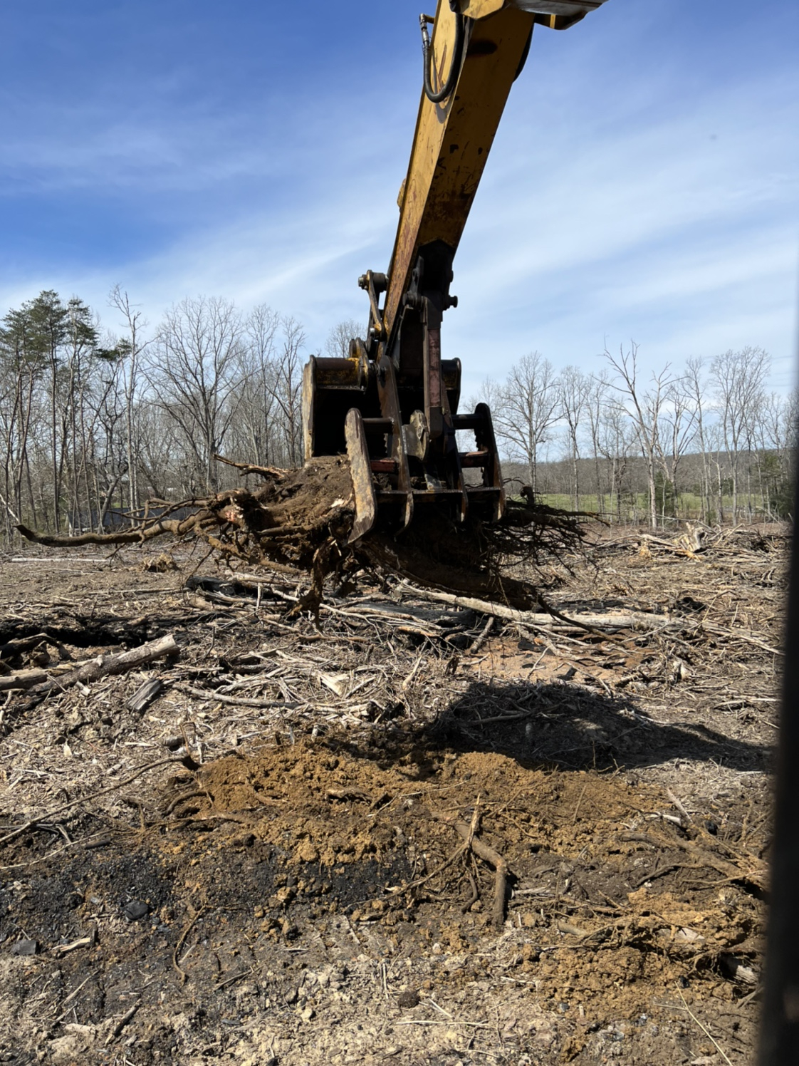

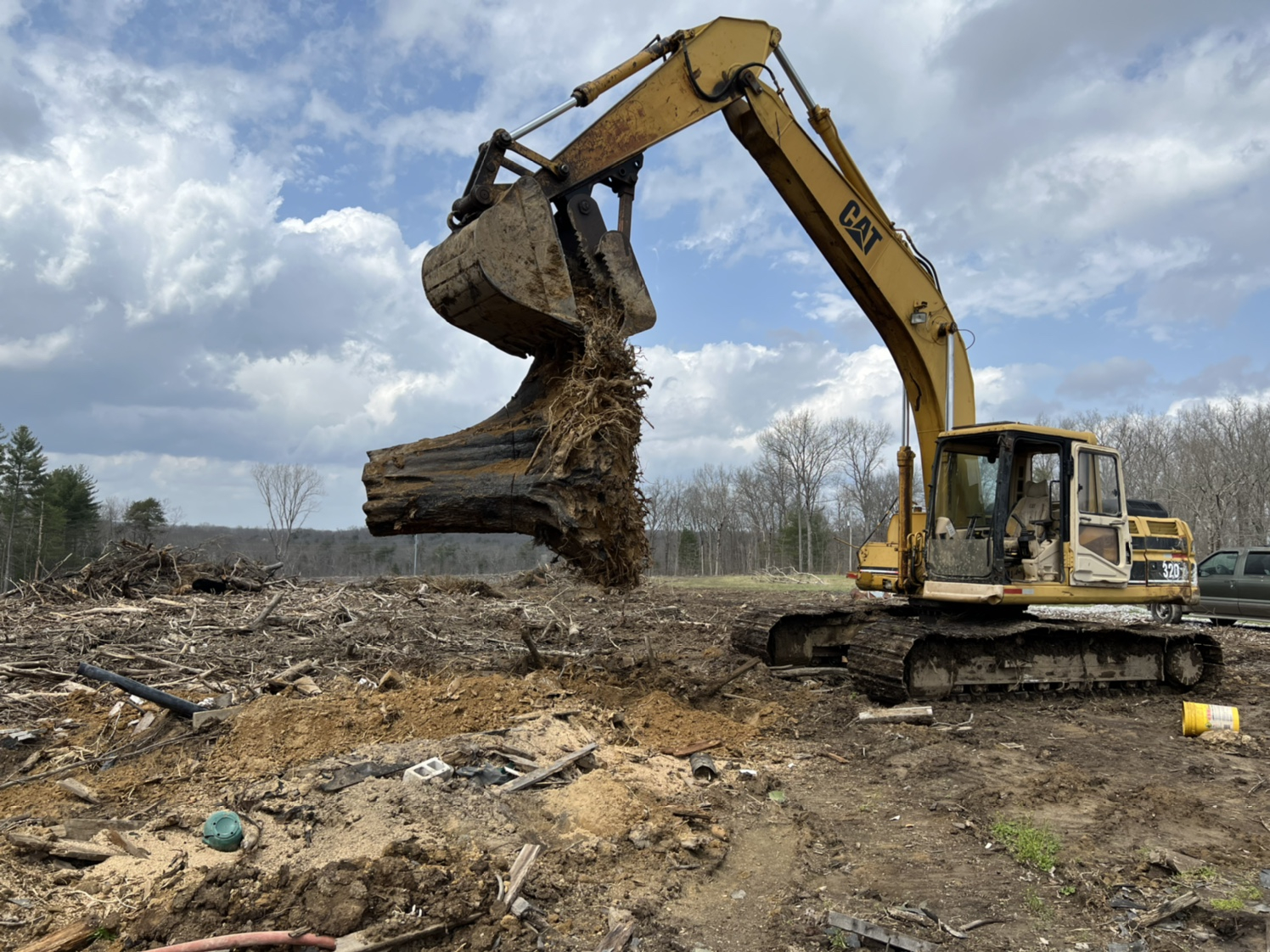

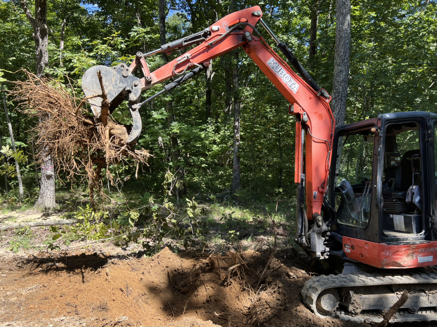

The only time effective way to deal with stumps is park the KX-040 and get on something bigger.

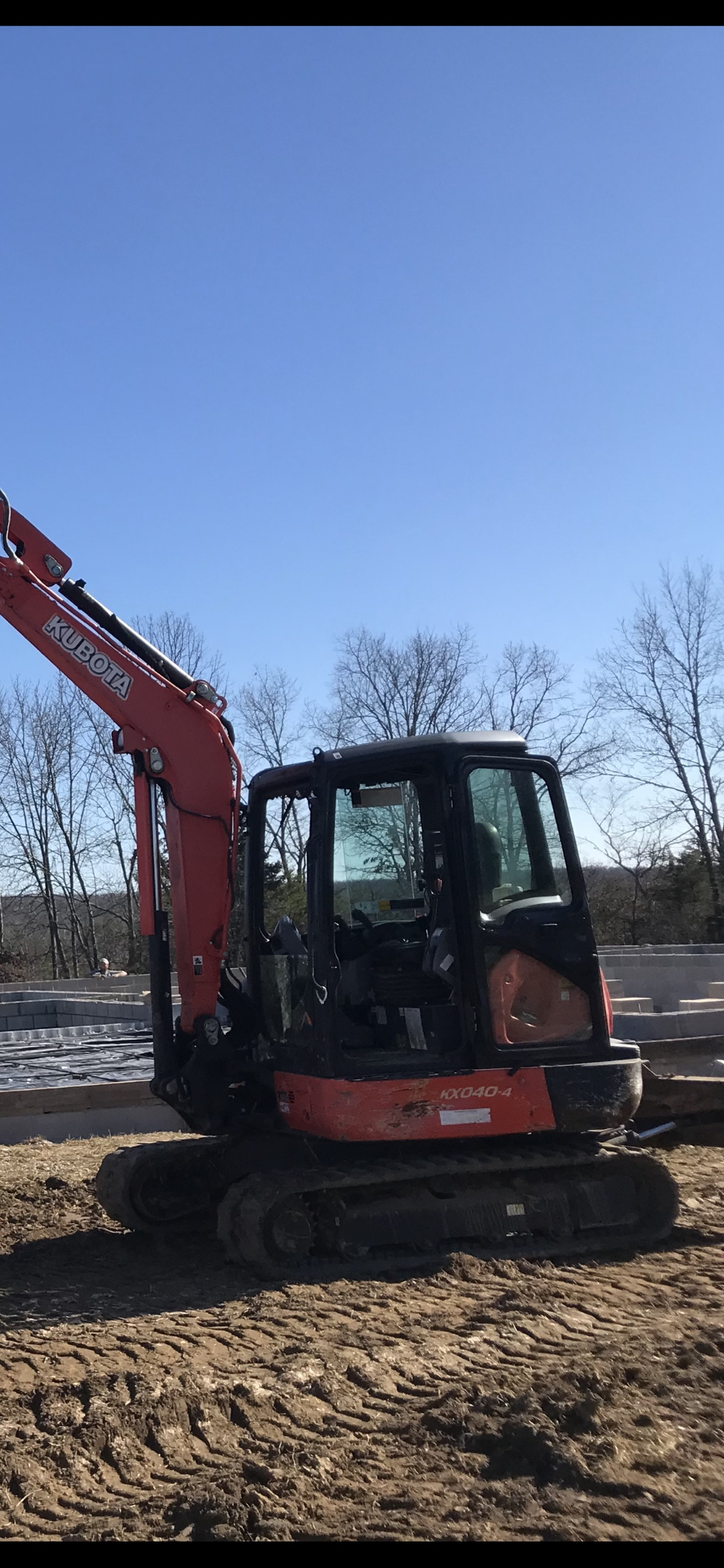

Man what I would not give for another 15 ft of reach with the boom! Is that your 040? The steel panels below the operator station really are beat to hell!
I bought it like that. Here’s a picture from the first job I had it on. They took fairly good care of things besides that.
