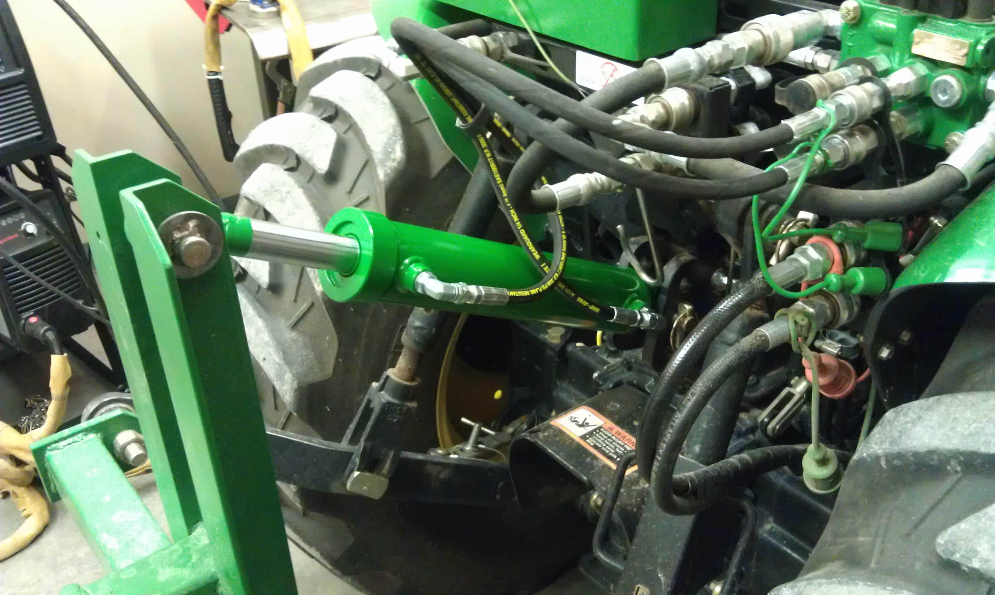

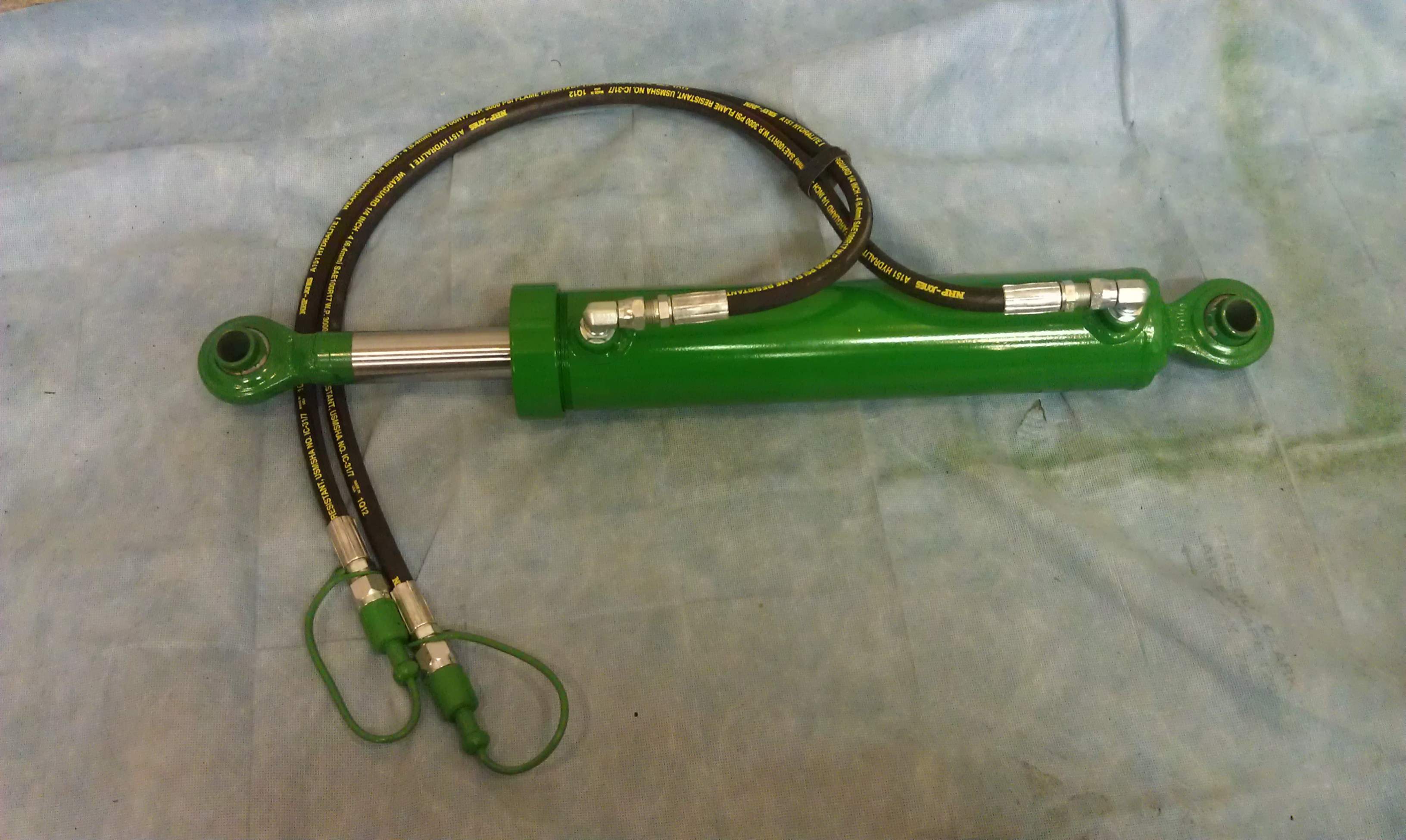

I made one a couple years ago. find the size bore you want and the stroke length you desire then weld extensions on to the length you need to make it work. important that you have enough of an extension that the cylinder doesn't bind against where it connects to the tractor. Toplink side.jpgToplink done.jpg

Larger rid on a rolling is not always a good thing.
I used a 3x12 cylinder with cat II eyes for my MX. And IIRC, it's 22" closed or there abouts, and goes to 34" extended.
It goes plenty short enough to load implements on my deck over trailer. I haven't found a need that would require it to go shorter. I do not think I would be happy with a 20-28" range. Under normal operation, im 26-28. So I would basically be out of travel.

I made a hydraulic top link for my JD 4410 out of a standard 3" x 8" stroke agricultural cylinder. The stroke was a bit longer than I needed so I cut part of the barrel off and put everything back together. I welded a three point hitch top link eye to each end and I was in business. I used a splitter that I had lying around and ran 1/4 inch hoses so that the cylinder speeds would be slow. All in all my cost out of pocket was about $130.
