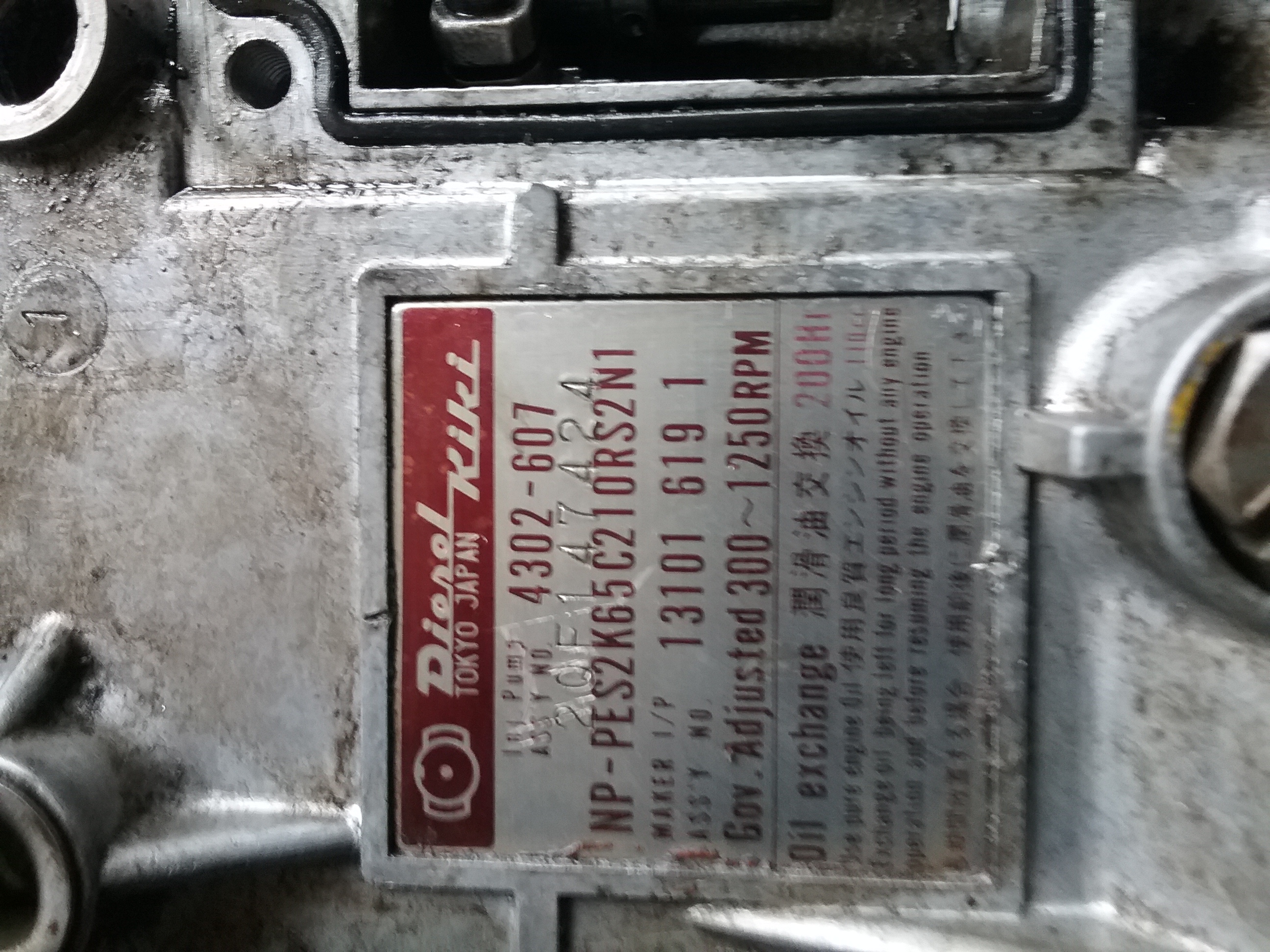

I'm not sure what yours looks like.?? Any way for u to snap a pic or get any #'s off the pump.??
Theres no such thing as NOT REBUILDABLE.. it may not be "cost effective"..
How about shipping your pump over, once we figure out what it is{Zexel} & then we can use your NY contact..
IF its what I think it is.. look at the base of the pump, left or right of the inlet bolt.. there should be a set of 5 #'s..
U might have to get the paint off first..
   / Injector pump #10
I figured out what it is.. its a Diesel Kiki INLINE 2 cylinder..
They ARE re-buildable.. unless the main pump housing is broken..
The pump# is>>KIKI>104302-6071

It is a kiki pump 2 cylinder the assembly number on the pump is 4302-607
I will put up some picture's shortly

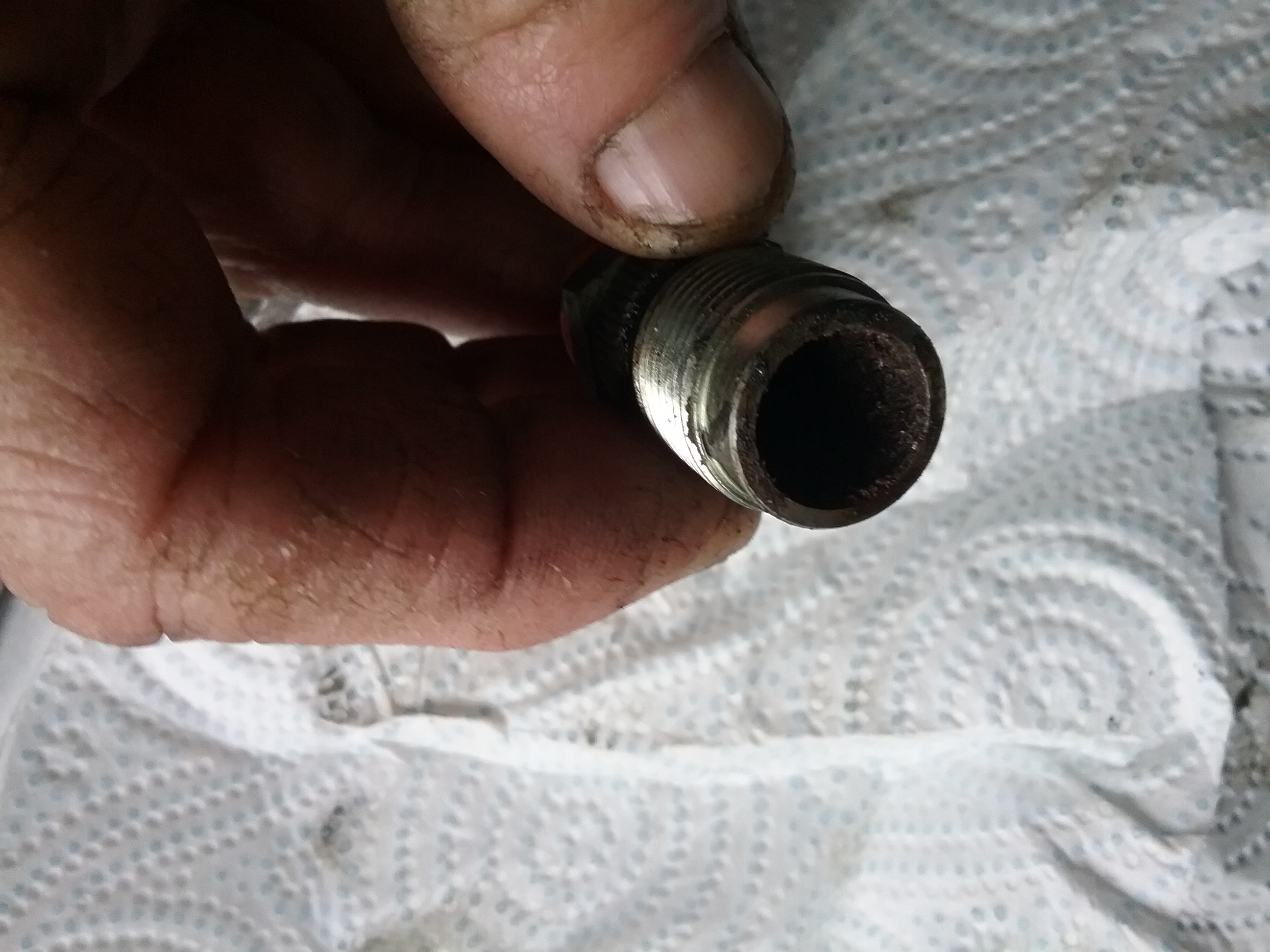

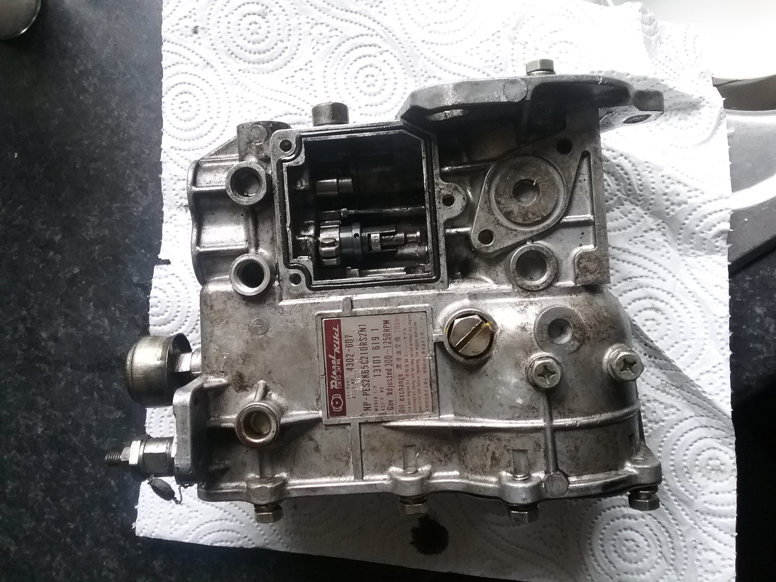

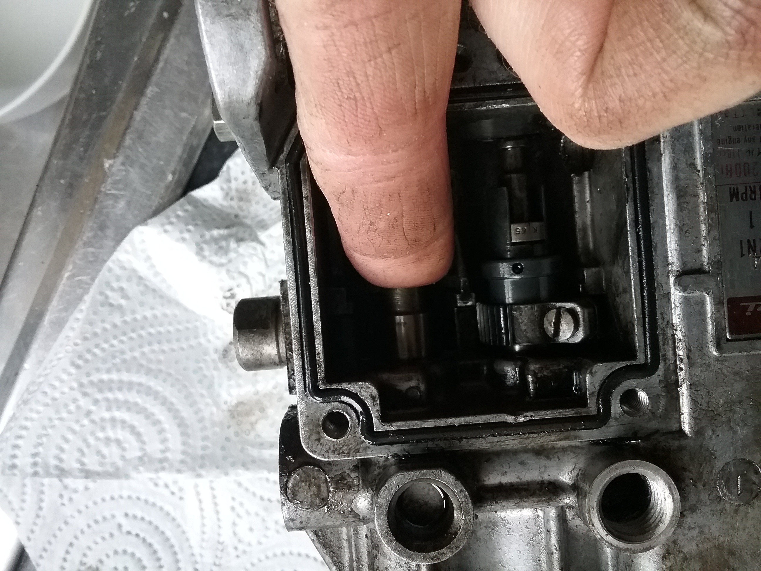

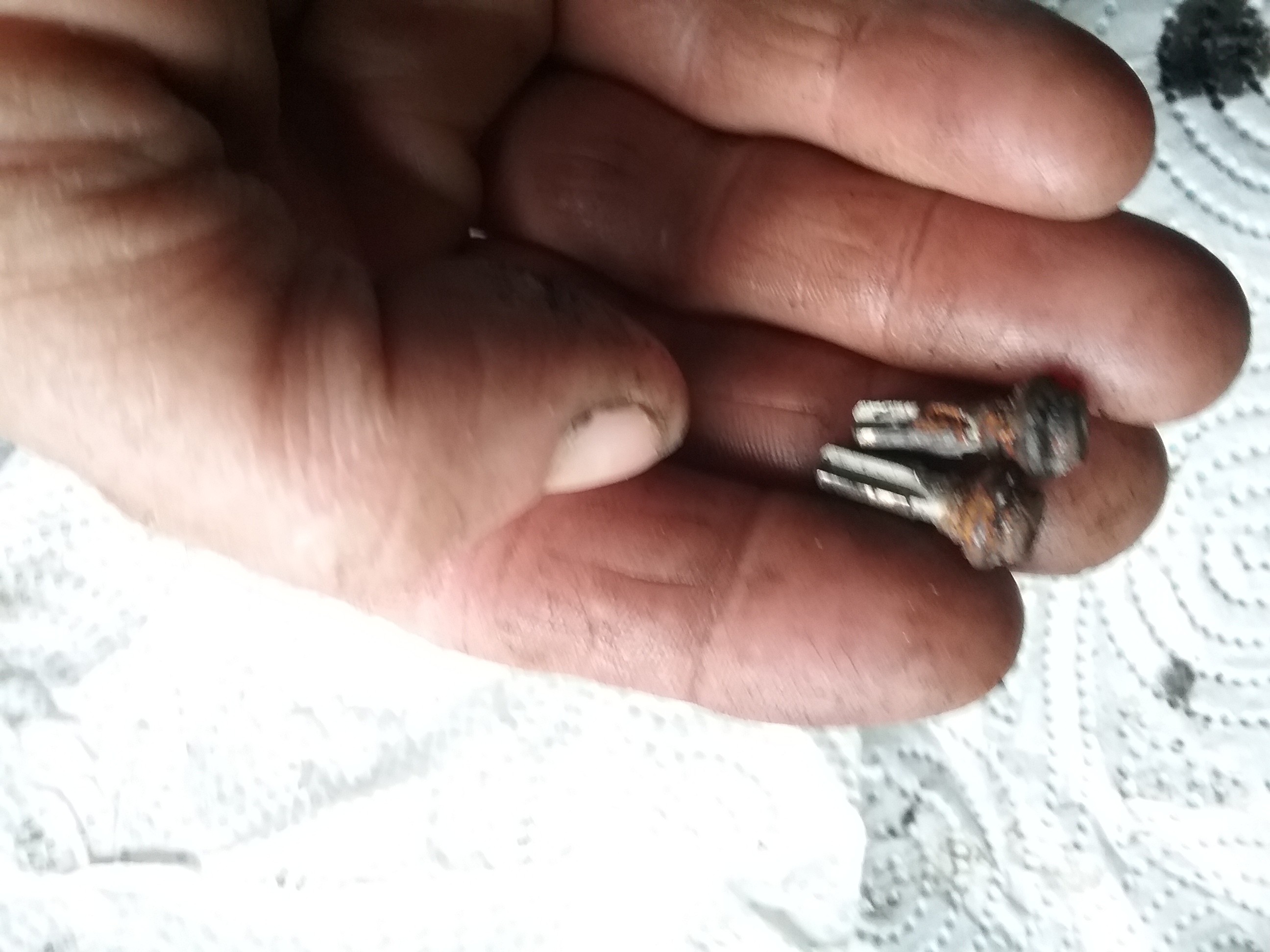

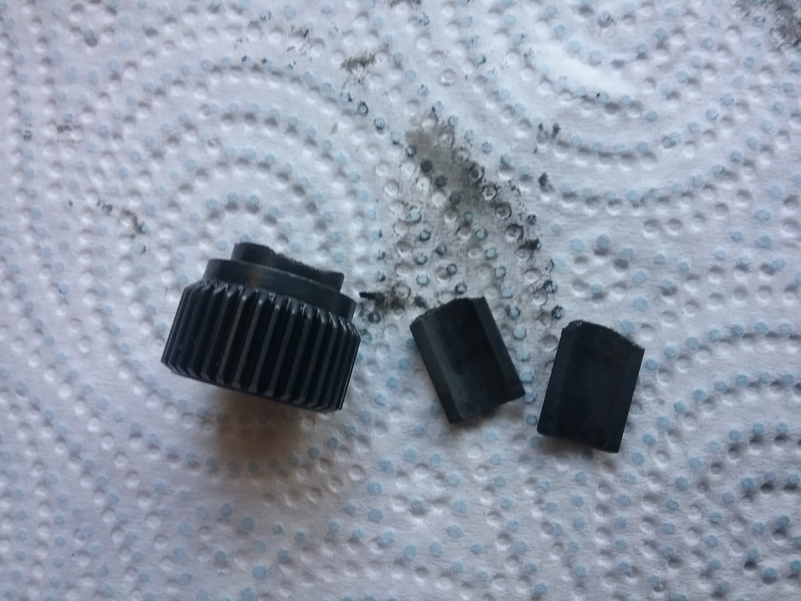

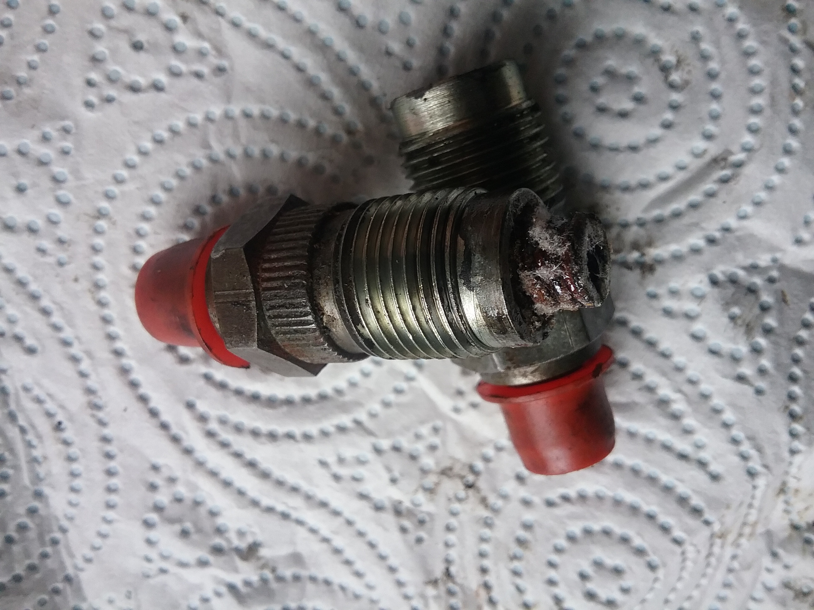

Sent some pictures of components of pump you might be able to see the rust
The piston that I have my finger against is stuck solid as is the other he said it also has damage to the cogs on the rack
You may not be able to see in photos

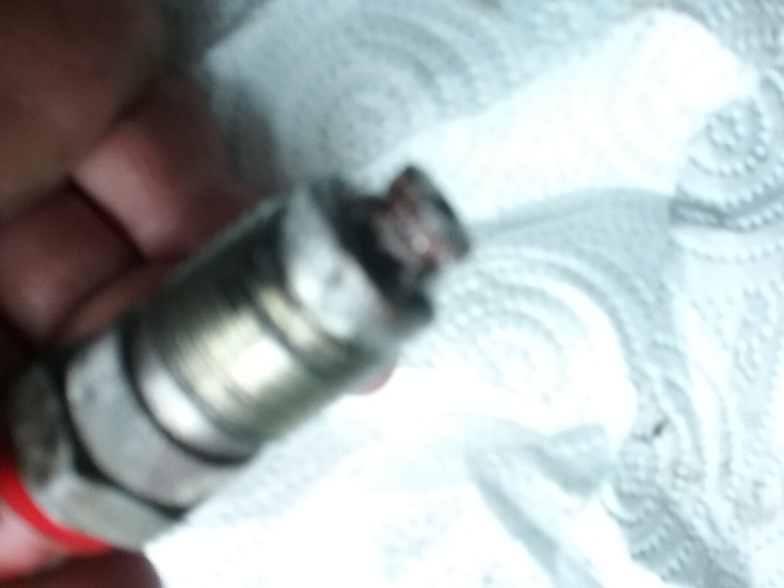

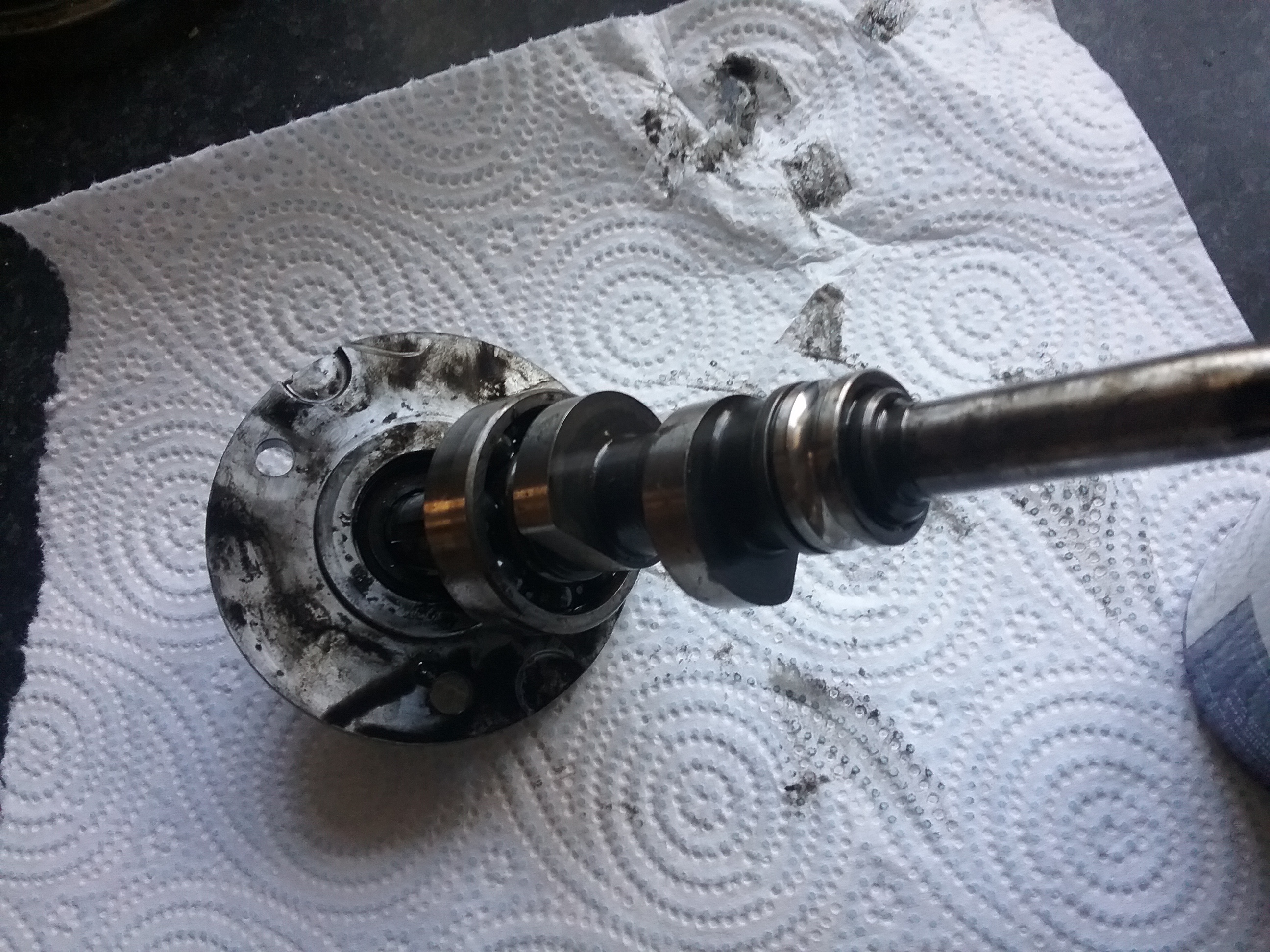

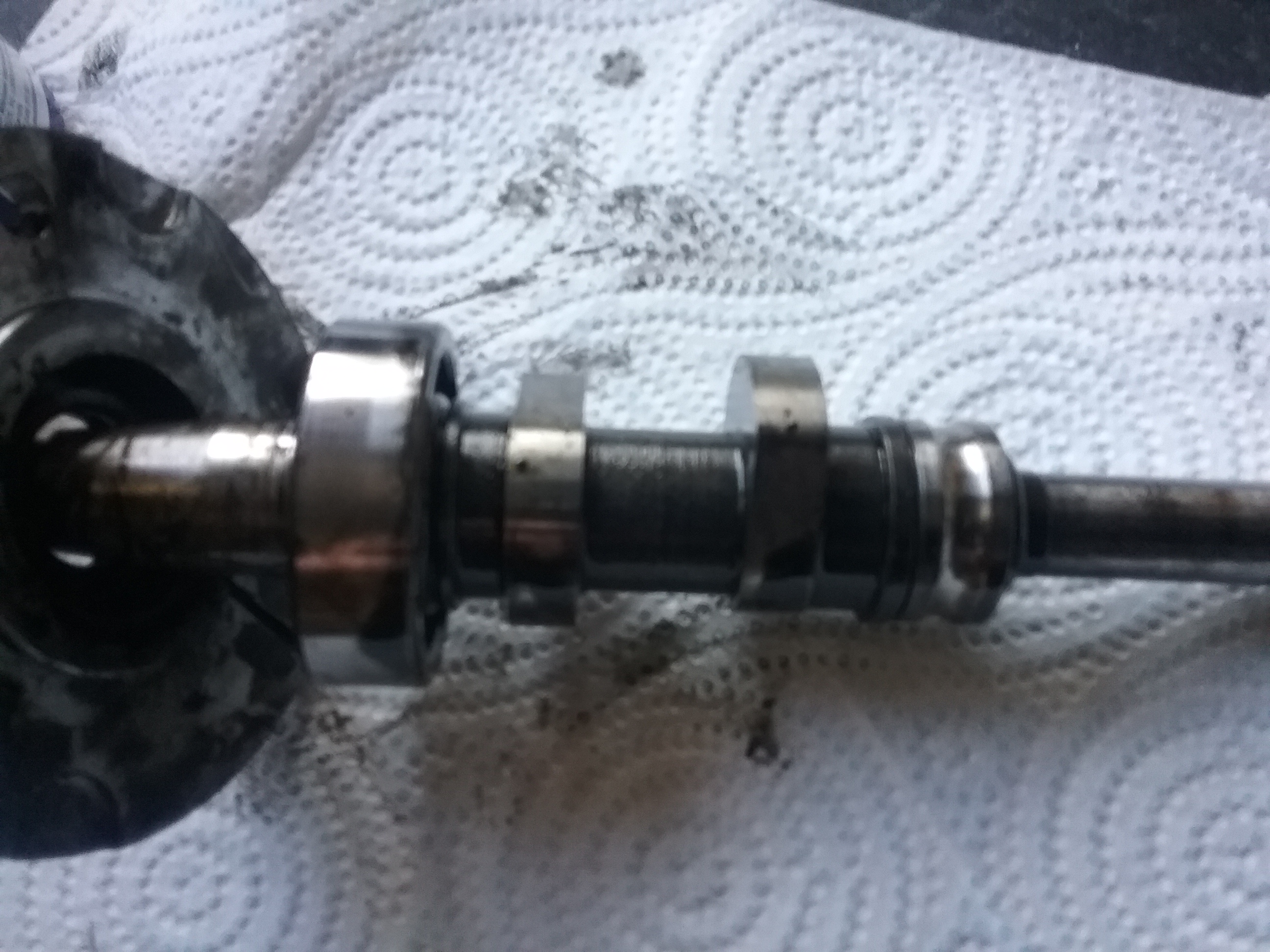

   / Injector pump #14

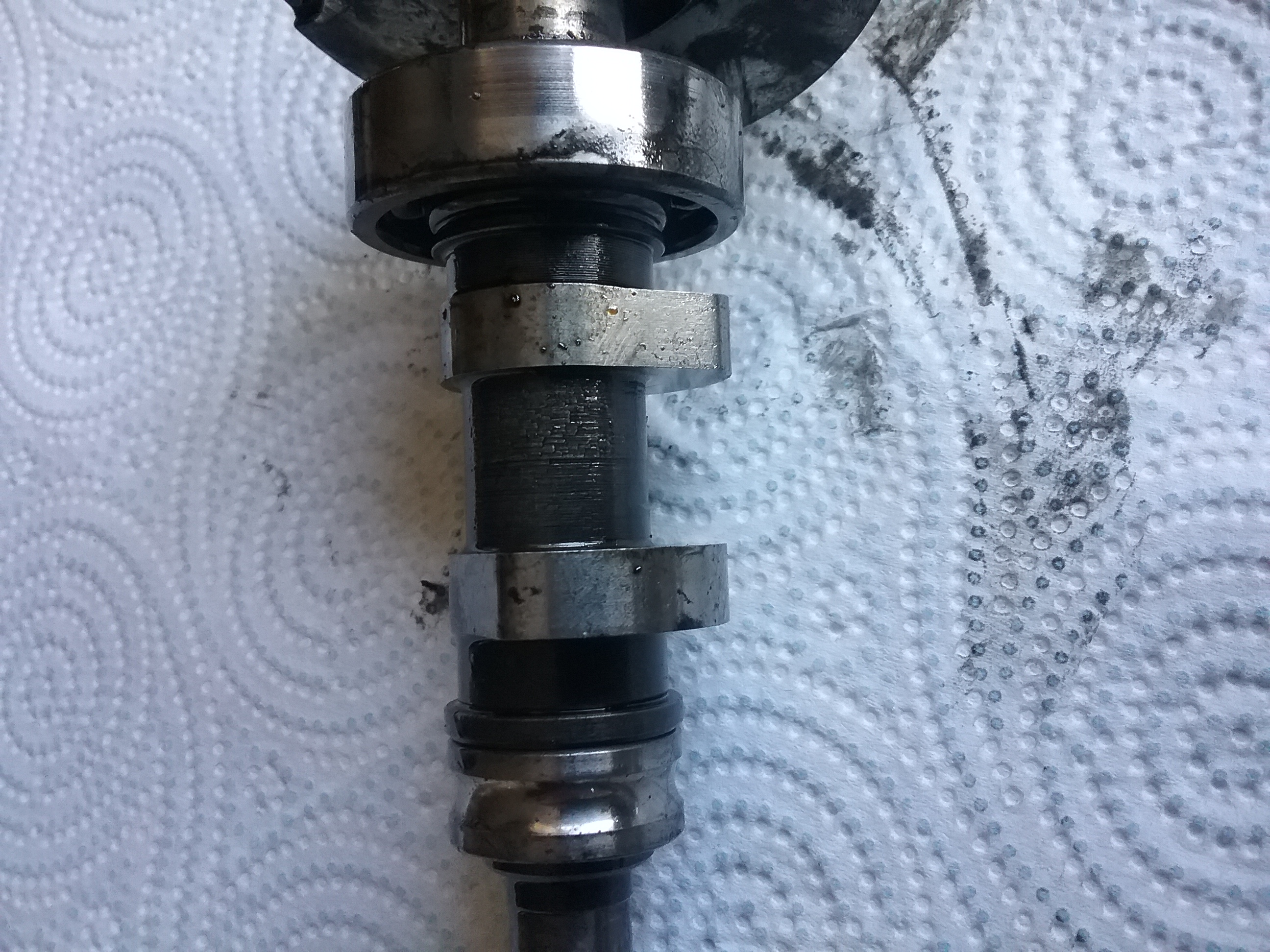

What does the cam shaft look like?? are the lobes still there?
I've seen & rebuilt worse.. All u need are 2-plunger & barrels, 2-delivery valves & a couple of segment.. & maybe some dv holders.
& a good sand blaster..Nuthin to it.. all it takes is money..
   / Injector pump
#15
Hi thepumpguysc

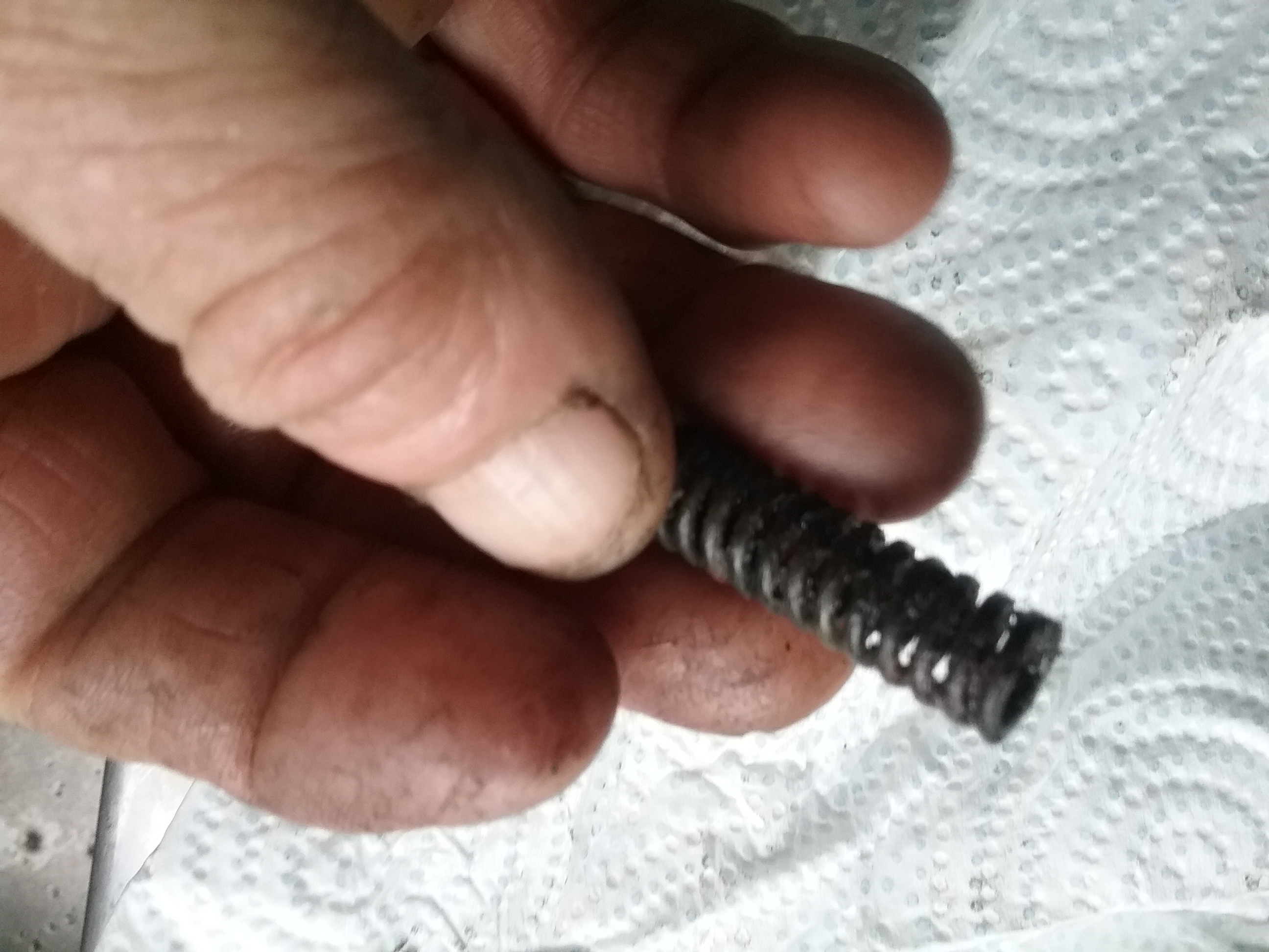

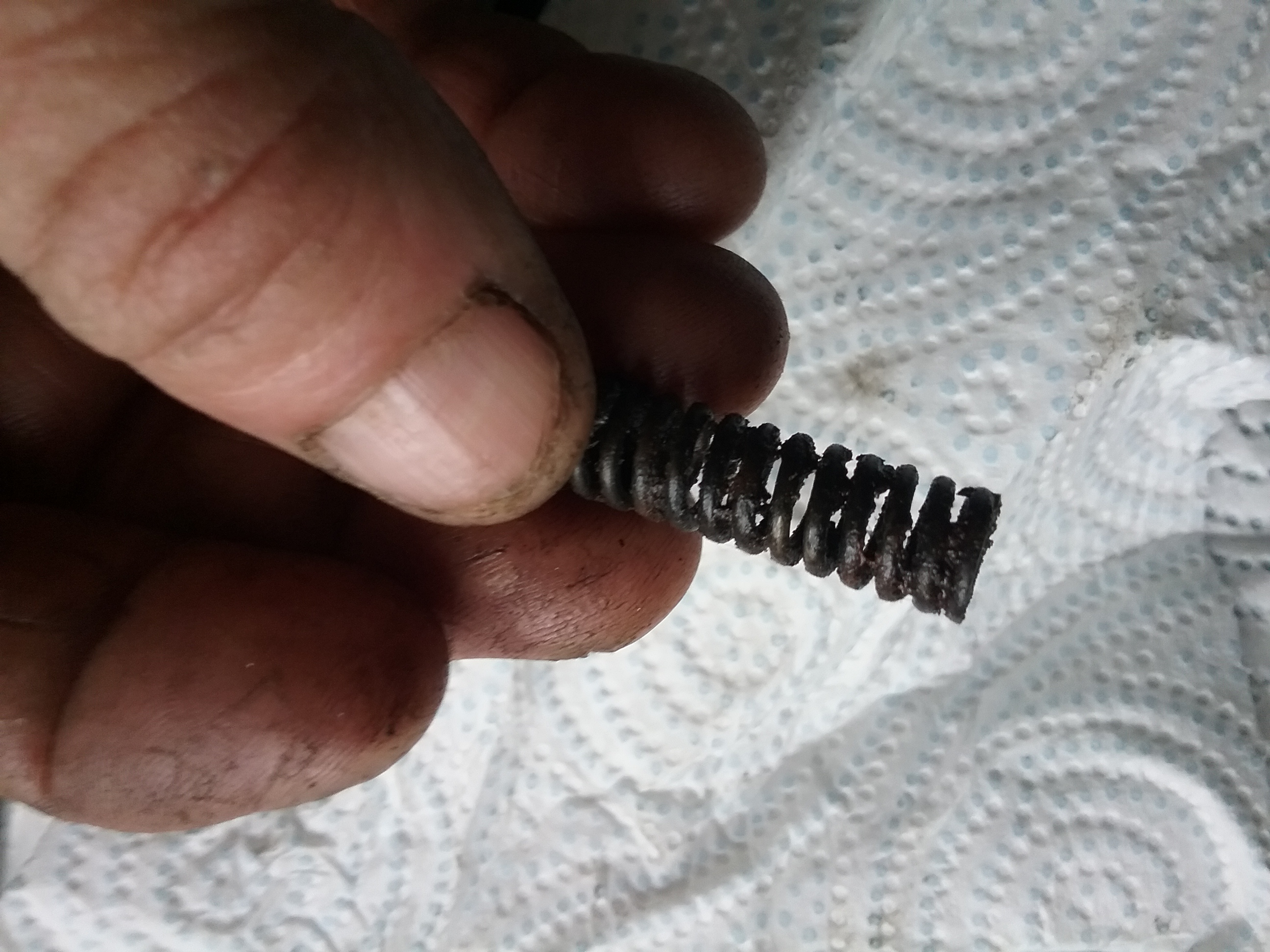

The cam shaft looks ok it's the upper part of the pump is seased, barrels and plunger stuck solid also another small piece snapped it looks like it was at the bottom of the plunger it has 2 little wings on it there snapped off can you get all the parts for a 're build provided you can get the broken part I would say it snapped when he was trying to take out the plumber?
But in saying all that
May be nothing to it if it was possible to hand it to you, unfortunately my arms are not long enough :chimpanzee:
And if I were to send it to you the shipping would cost more than the repairs
So would probably do better locating a good second hand one,, or a rebuild one
Can you locate one ? Or supply all the parts I need ?
