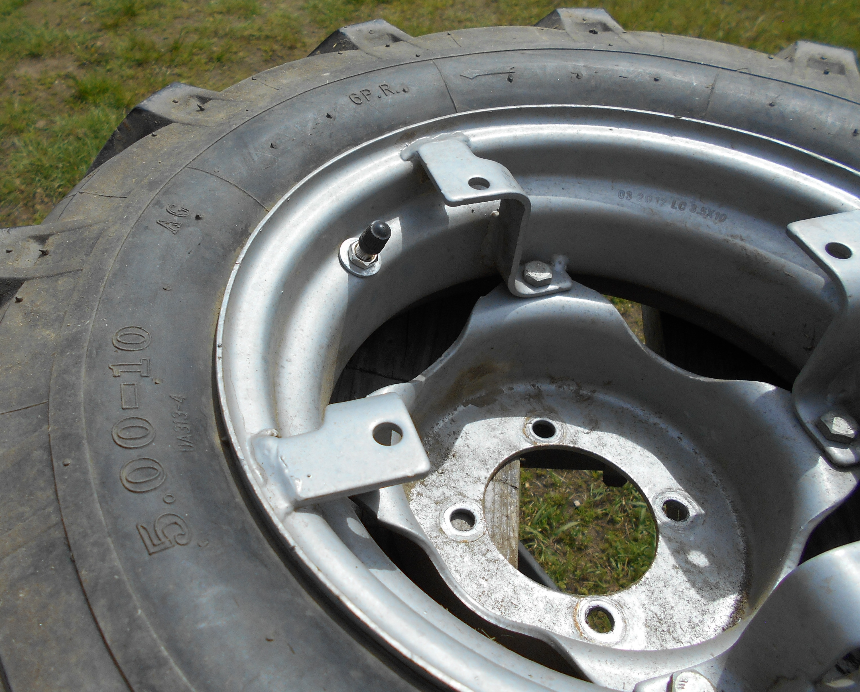

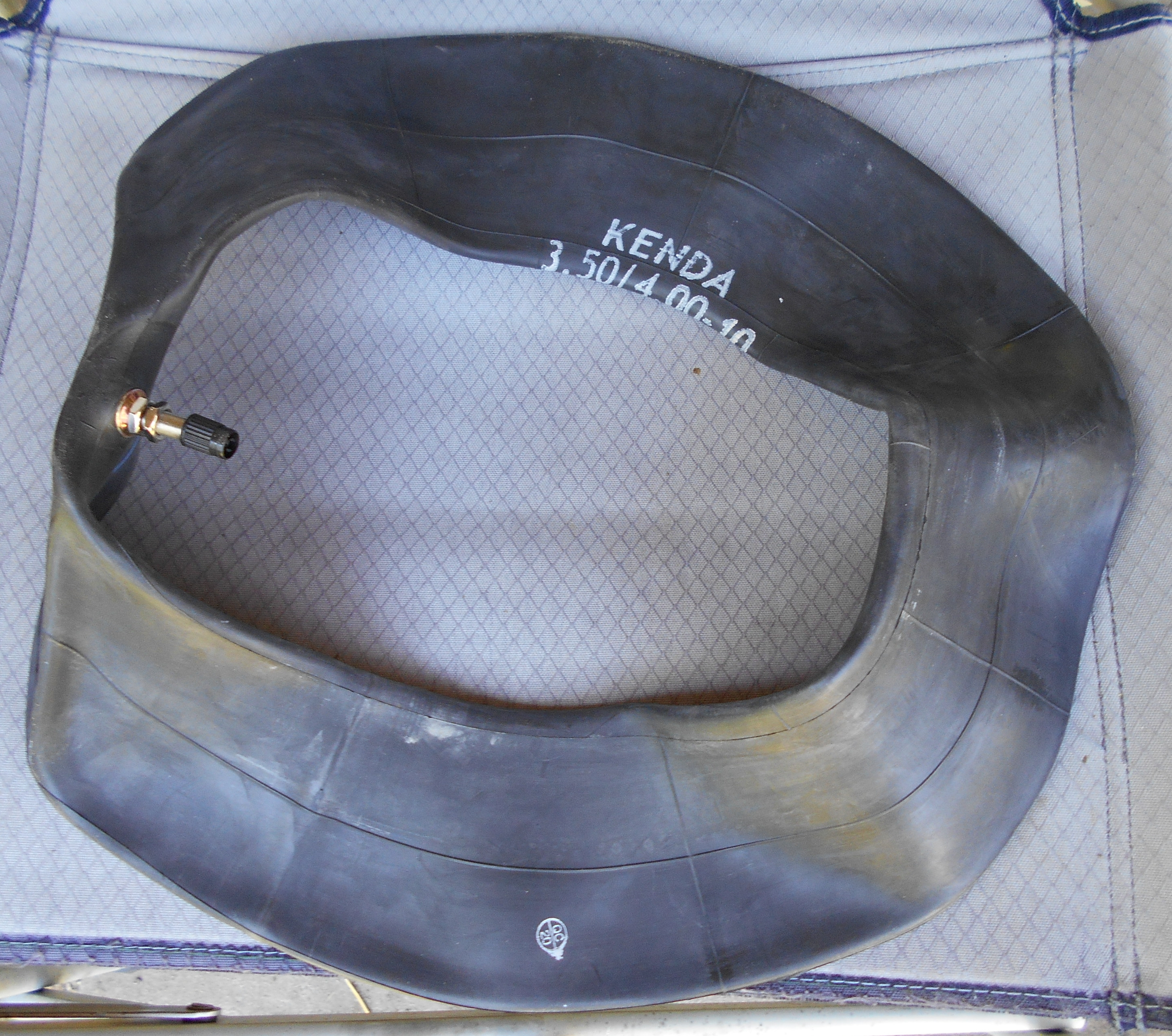

So, the new tubes showed up from an on-line motorcycle supply place - apparently this size is very common for European scooters like Vespa, Lambretta etc., around $13 CAD.
This is one of my original tubes, always slightly over-inflated but still ready to rip off.
And this is the new tube installed. The lock-nut was almost the same diameter as the hole in the rim so I added a galvanized washer.
Seems like an improvement to me? Time will tell.
:drink:

How much is "slightly over inflated"? I forget now what mine were supposed to be, but it was low (10 psi maybe). I ended up keeping them around 20 psi to stop the tire slipping on the rim. It doesn't matter what kind of valve stem the tube has, if the tire slips and spins on the rim it will pull the tube with it and tear the stem eventually. At least that's what mine did.
   / Inner tube woes
#16
15 psi is recommended, I run 20.
You are correct, if the tire slips it will eventually tear the stem, I hope these tubes will help.
To be fair, these tires and tubes have survived 8 years of heavy use and abuse without a problem.
There was a suggestion to use bead sealer, I meant to do that but my 70+ brain forgot. :confused:
Cheers :drink:
