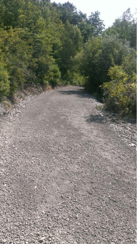

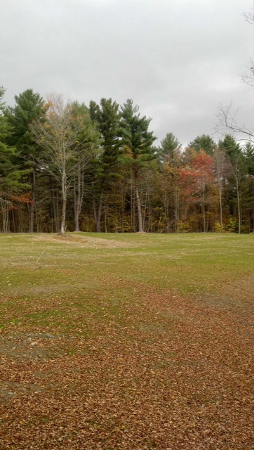

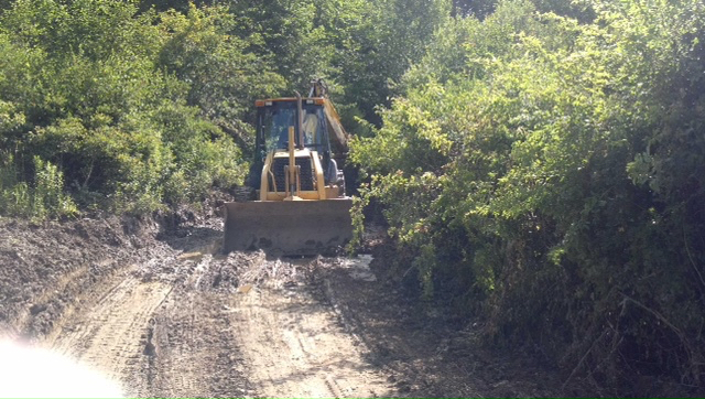

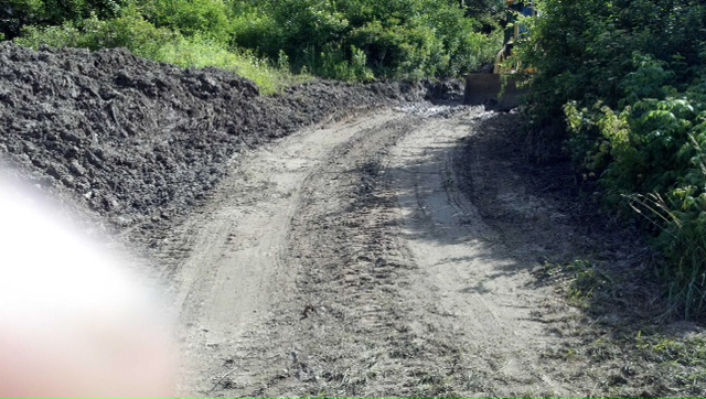

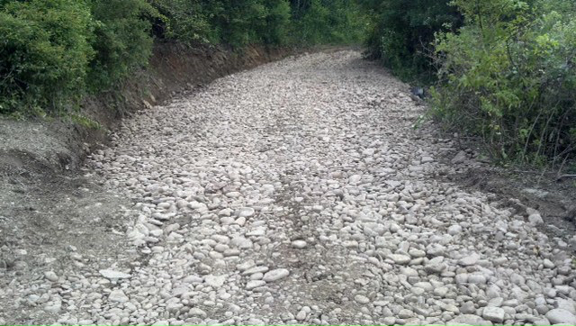

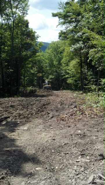

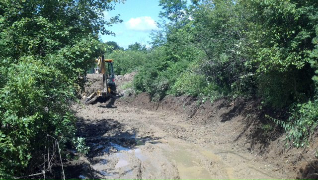

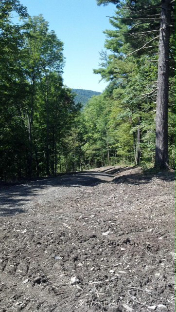

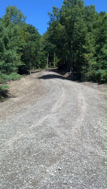

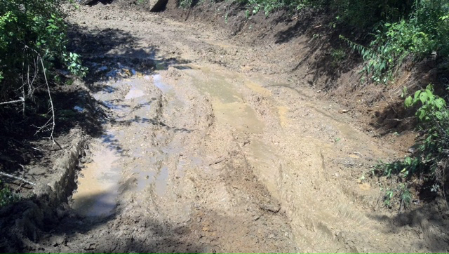

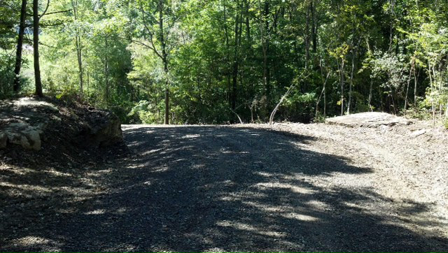

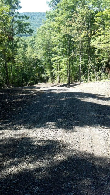

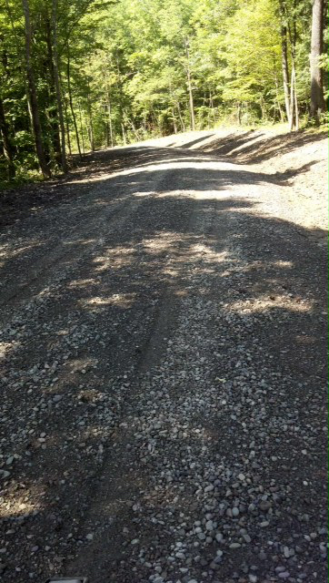

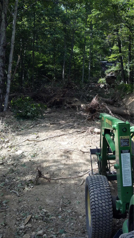

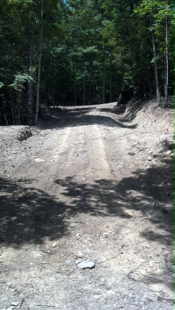

Last year I did the same type of project on my property. I used the same type equipment that you have. I rented a larger ex to clear 4 acres of wooded area where I had to clear 500+ stumps. But overall, if you have the time, the equipment you mentioned should do fine. Here are some pics of the project.
These are of a road at the base of a hillside with a swampy area just below. Same as you describe.
These are of the road through the wooded area.

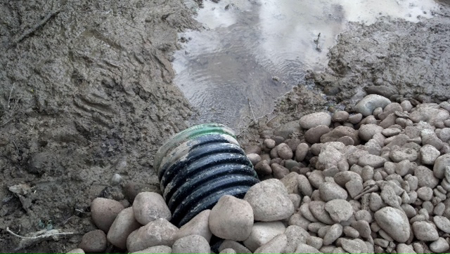

Make sure you get the water under the road and not over it and you will be good to go. I have had to tweak the ditches a little over the year to accommodate the water but overall it's looking good. Good luck with your project

Don't clear stumps, dig around trees cutting roots, then push the tree over, cutting the stump off after you used the leverage of the tree to take it down. MUCH easier, and you can get by with far smaller equipment.
Woody, we're practically neighbors. I grew up in East Meadow, and dated this hot chick from Northport back in the day. The property I'm going to put the road is in Windham.
Nice job on the road!! Really nice and smooth. What did you use for a base, and did you add any geotex to keep it from sinking into the wet areas? How long did all that work take?
Great advice Andy. I've been looking at Youtube and have learned a lot about stumps. Till now, mostly used my Ex for trenching and landscape work. Stumps are a whole nother animal, which is why I may move up in size. I'll know better when I get started on all this when the ground unfreezes.

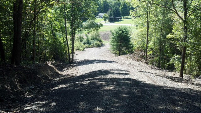

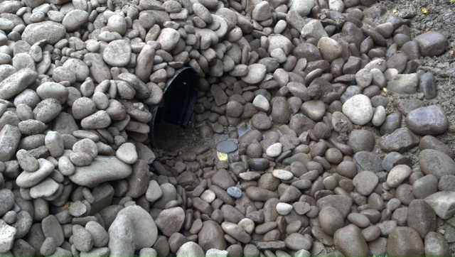

In the area where it's on a hillside, I dug a trench on the high side of the road with a gentle slope into the culvert. In this area I used smooth large road base stones instead of the typical base. It was recommended to me so that any excess water can pass through the stones since they have small cavities within the base to allow the water to pass. I needed about 24" of base in this area. Didn't use any geo textile fabric. Topped it off with 3/4 minus. It has held up very well. No issues with water, erosion or sinking. The rest of the road was built using your common road base and 3/4 minus on top. It's not totally finished as this road will be used by all the larger trucks to get materials to my building site. Once I get my pole barn built ( this spring), and the home built, I will finish it off with fines and a final grading.
The area that was on the hillside took about 2 days to do. It's about 100' long. I removed a lot of topsoil to get down to the clay where the road would have a decent base to build on. It was all slop as you can see in the photos. The rest of the road was pretty straight forward and took about 10 days to complete.

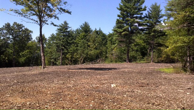

This is where it leads to. It was all wooded. Cleared, graded, seeded and covered in hay. Came out pretty good for an amateur.
