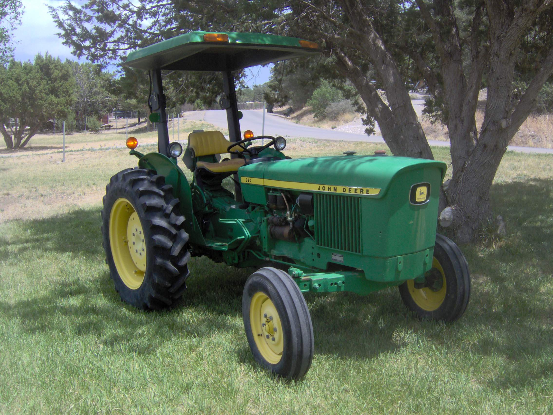

Tractors if kept simple don't cost much to own over a ten year or longer period imo. As an example I bought my used Deere 820 for $3,500 in 1997 and fixed it up with new clutch, tires, battery, seat, steering wheel, fluids and paint. In 2005 added a rops and canopy for safety reasons. After buying the newer tractors I found the 820 wasn't being used and decided to sell it. Sold it in 2014 for $6,000 so after buying the tractor and fix ups totaling $7400 I used it for about 17 years for $1400 and two weeks of my time for labor. Having a good little tractor available in good shape for $82 per year is about as cheap as it gets. Yeah those John Deeres are expensive alright.
