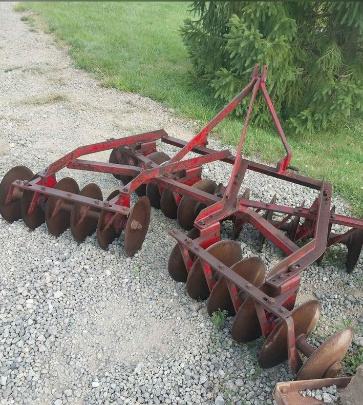

All,
This disk is available (as of right now) within a somewhat reasonable distance. See linked thread for more background detail.
In short, 42hp International 444 2wd gas. At 5hp/ft - 8' of disk is about the max for this machine. Tractor track width is about 7' so 8' would cover tracks.
I came across the disk in the picture - 8' International of some vintage. It appears to be in good working condition. The seller is asking $875. For what you see - does that sound like a reasonable price? That sounds a bit high to me. But I think this is the ideal size and it is available.

if its in good shape I would say yes... the combination of I need it and it is close to me is worth some money... I have a pull behind with a hydraulic axel its a 10ft I only payed $1500 but I had to put in a other $3600 in parts in it (rebuilt the whole front end)

I have something similar that I bought for food plots. I found that it's too light to really do much to ground that has never been disked before. It also makes a big difference in how much moisture is in the ground. Dry ground and it just bounces along the surface. Another concern is if there was grass there that will stop it from getting to the dirt.
My experience with mine was that it takes a very long time for it to start working. You go over the ground, over and over again, and then it starts to break it up just a little bit. So you keep going over the same area, over and over again, and evetually, it will break through and start to work.
I put a milk crate on mine and filled it with sacks of concrete. The extra weight helps, but that's on an area that I've disked twice a year, for over a decade.
Now that I have a bigger tractor, I want to get a pull behind disk. In my opinion, from what I've read and seen on YouTube, they work a lot better then the 3point systems.

We had a lead on a 12ft drawn with hydraulic lift wheels for $400 a while back, it sold. This one is more than double the price and 3pt, not drawn. Just trying to weigh the math. New is $3000-ish.

I agree but these disk are design to break previously plowed ground and not virgin ground ... there are advantage with the 3 point disk and as you pointed out there are also disadvantage. and yes the pull behind are better to break ground but if I am going to have a pull behind I would want a axle to lift it off the ground. I have a 10ft pull behind and it weigh a like 1800lbs and if the vegetation is dense with these reed canary grass it wont break the ground even if its mow raw... the notch disk are more effective to break virgin ground.

the draw are a lot more expensive new, then the 3 point, I don't think you would've been able to pull that 12ft... I have a 10ft and with my 60hp hydro it is taxing on it, at times I have to put it on low gear or even lift it.

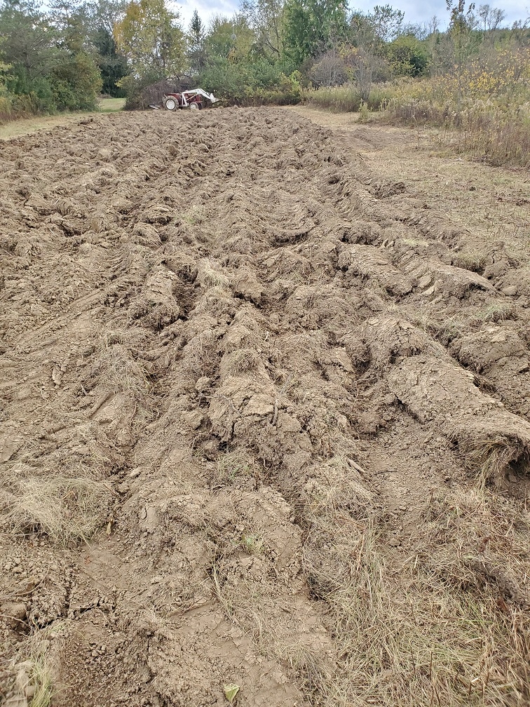

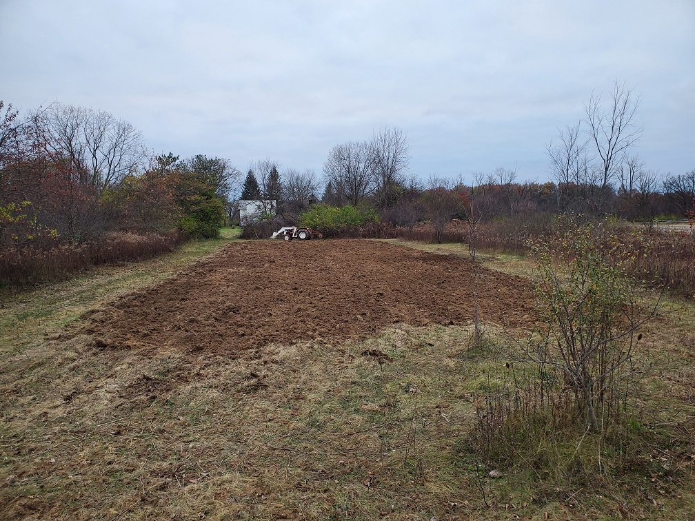

We got the disk and ran it yesterday before the sun went down. Since we were running over already worked ground (plowed, see 1st picture) the disk was able to work pretty quick. With as messed up as the ground was, though, it took several passes - maybe 4-5 - to get it where it is now.
However, I think we need to add some weight to the disk. Any ideas on how much to add? Maybe 1000lbs - 500 per side? Or would that be too much? I am guessing the disk weighs around 500-700lbs as it sits. It doesn't seem very heavy - I can shove it around on the ground and on the trailer by hand without too much difficulty.
As for weight - I am thinking of making some concrete blocks to fit on the disk frame. Maybe have them encased in an angle iron frame with some welded on rigging points to be able to move and use other places, also?
This is the plowed ground mess from before:
Results after disking last night:
