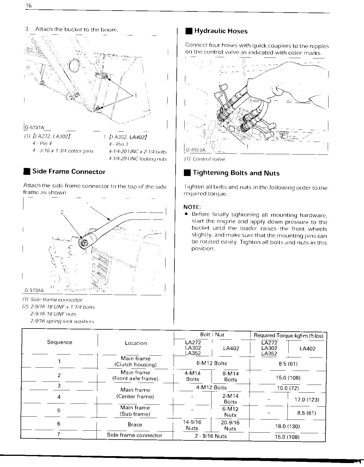

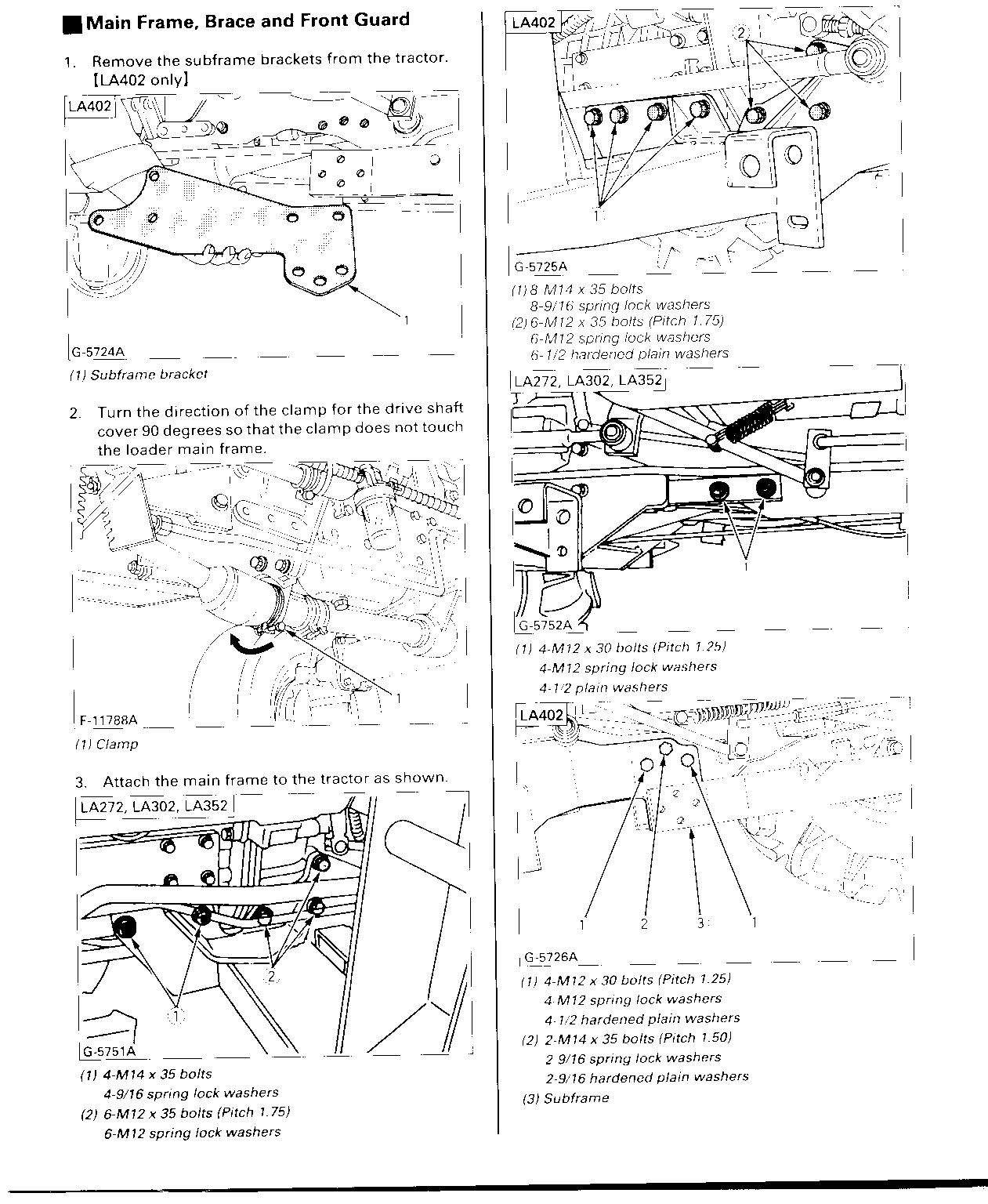

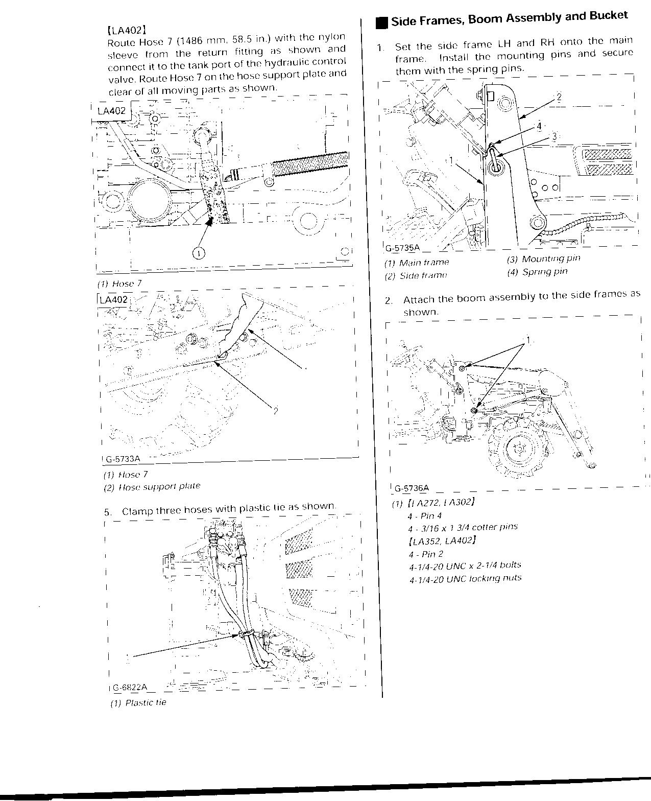

allenp....My B7800 came with the LA402 already installed. I just looked at the manual and the very first thing to do is indeed the tractor hydraulic lines. Attached is a scan of the installation section of the manual (6 pages).
Good luck with the install.

The Loader arrived today as promised, and with any new toy, I had to get started with the installation. I was able to get the main frame installed, and hoses routed. All the bolts in the frame lined up perfectly, and was able to start all bolts by hand.
It was piece of cake to install the return fitting (item 10), but I did have to remove the plastic cover under the seat to gain enough access to tighten the fitting for the return line.
Now for a Question; How do you tighten the hoses that connect to the hydraulic block (# 40)? The block is installed with the fittings (per the manual as well), the hoses are connected to the fittings (#20) and are finger tight, but space in this area is at a premium. Does it take a special wrench (short stubby, or a unique socket). I can't believe that I need to remove part of the dash just to tighten 2 fittings.
Any thoughts or suggestions will be appreciated.
