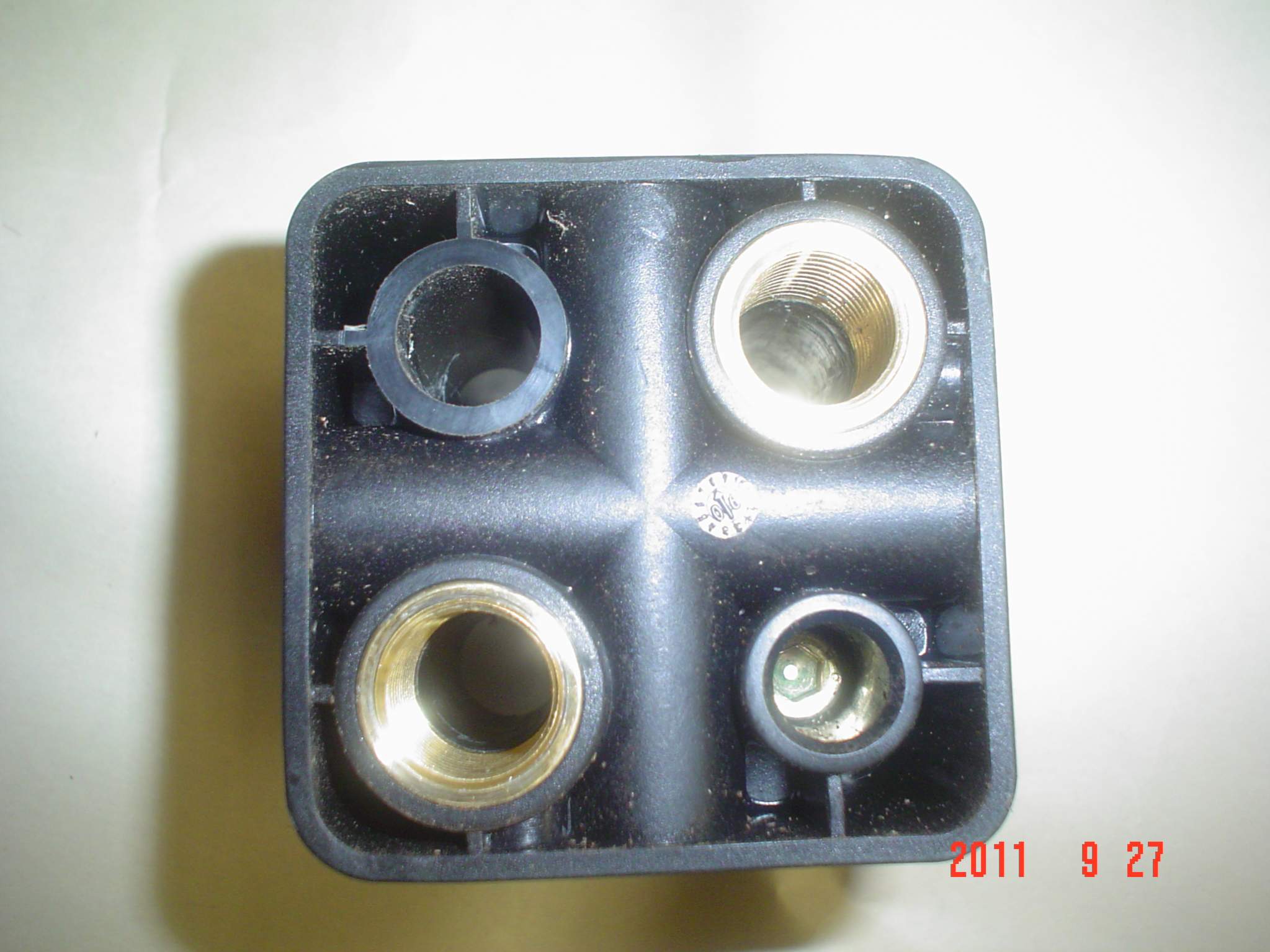

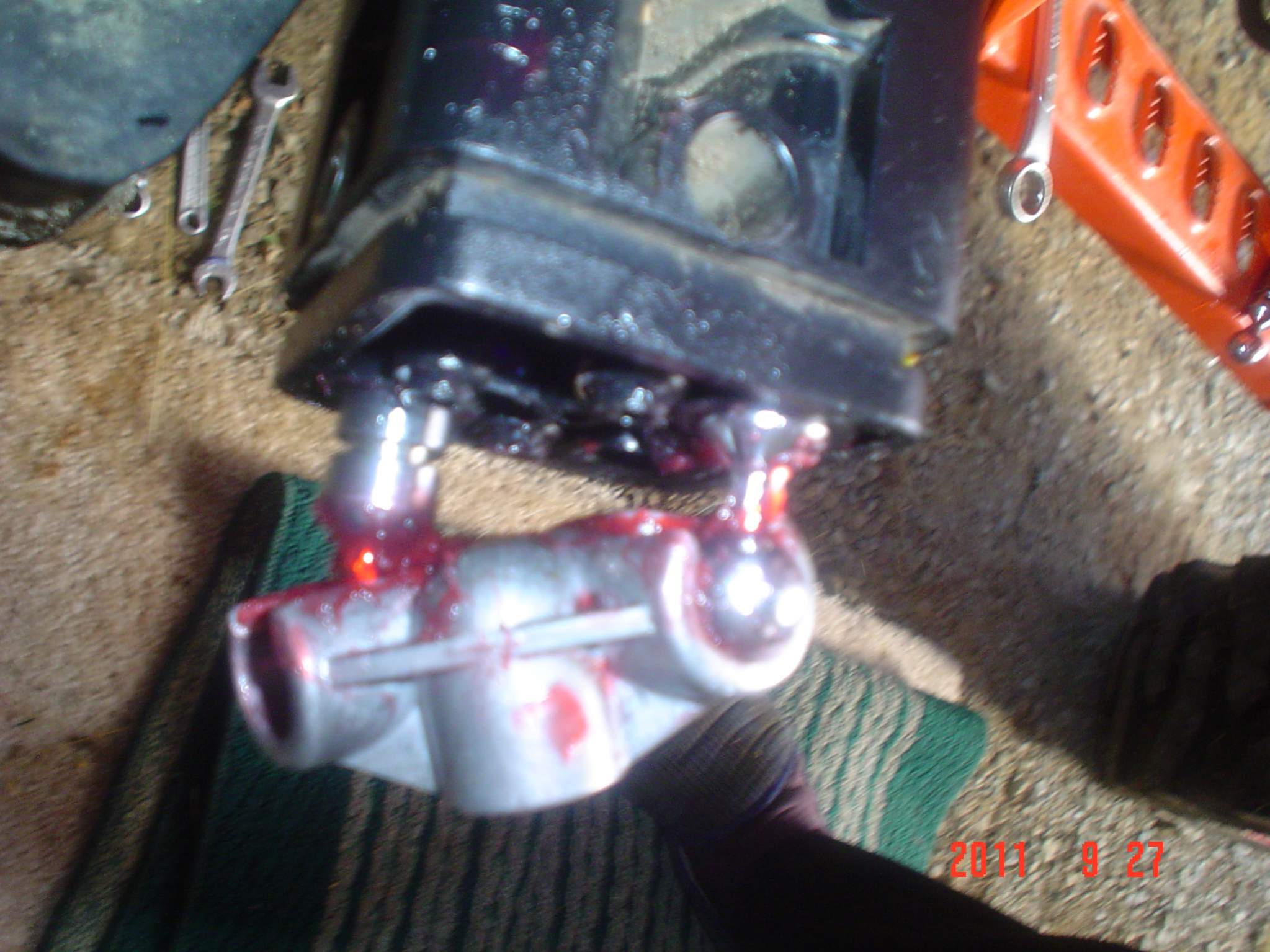

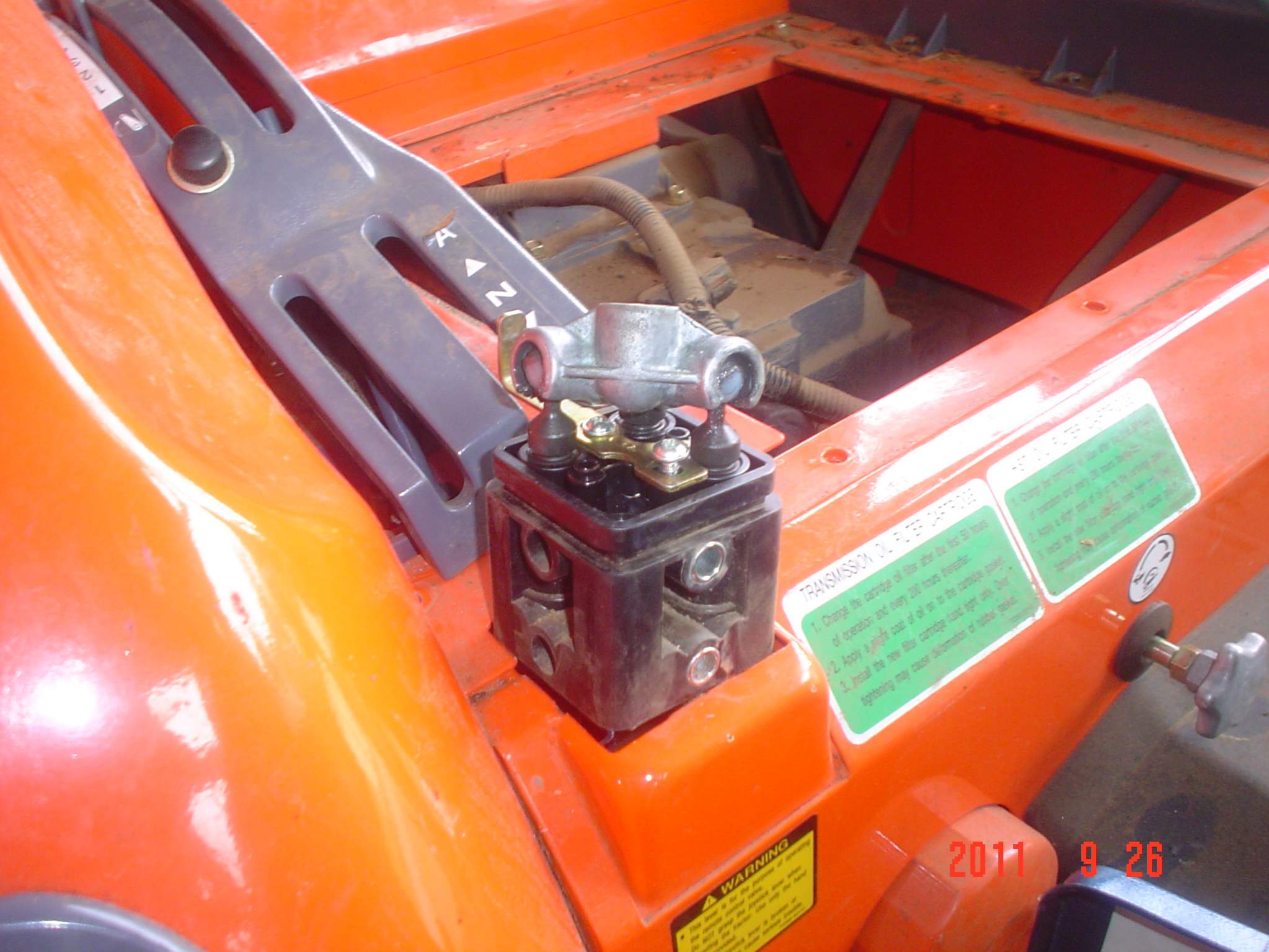

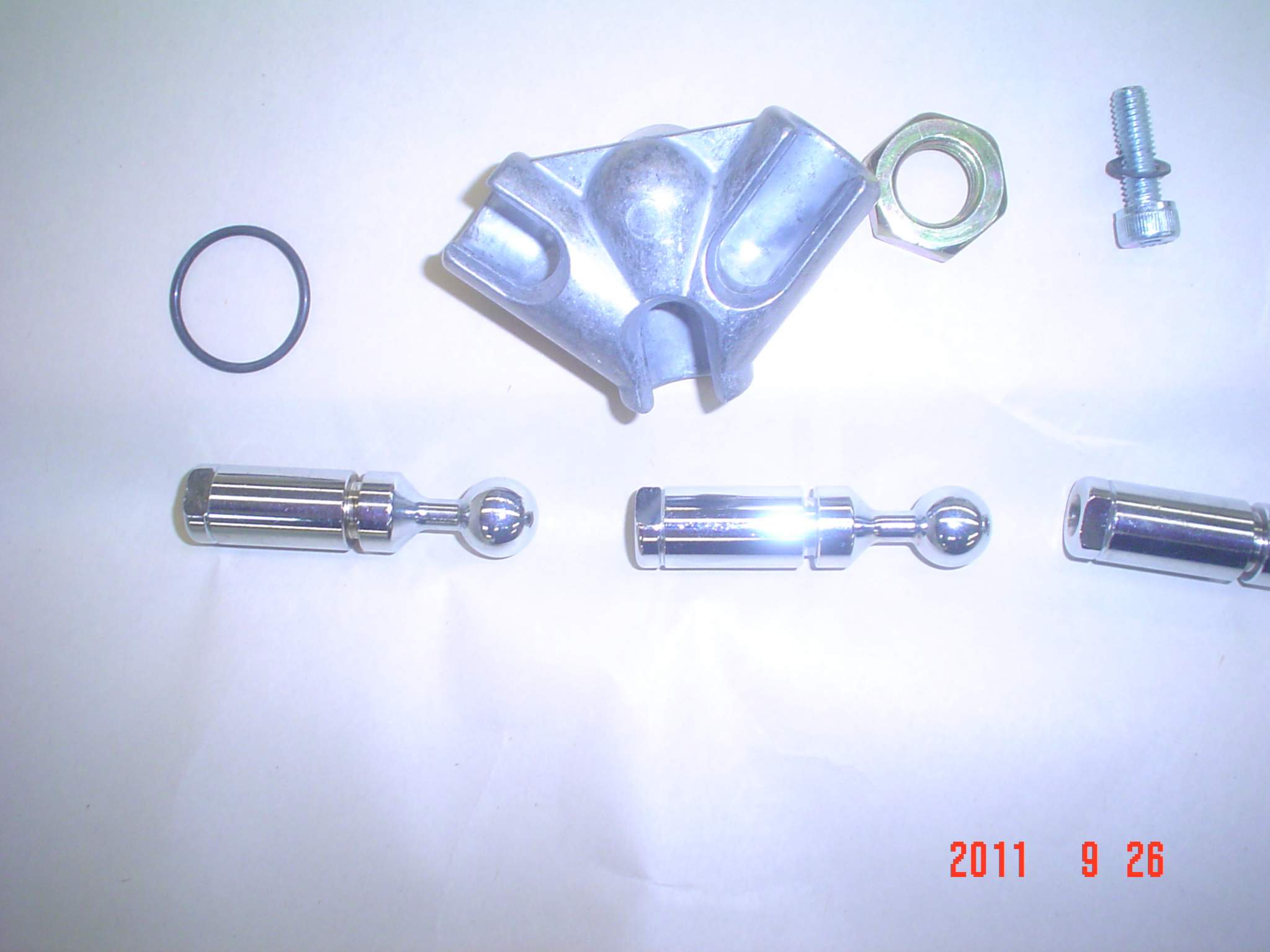

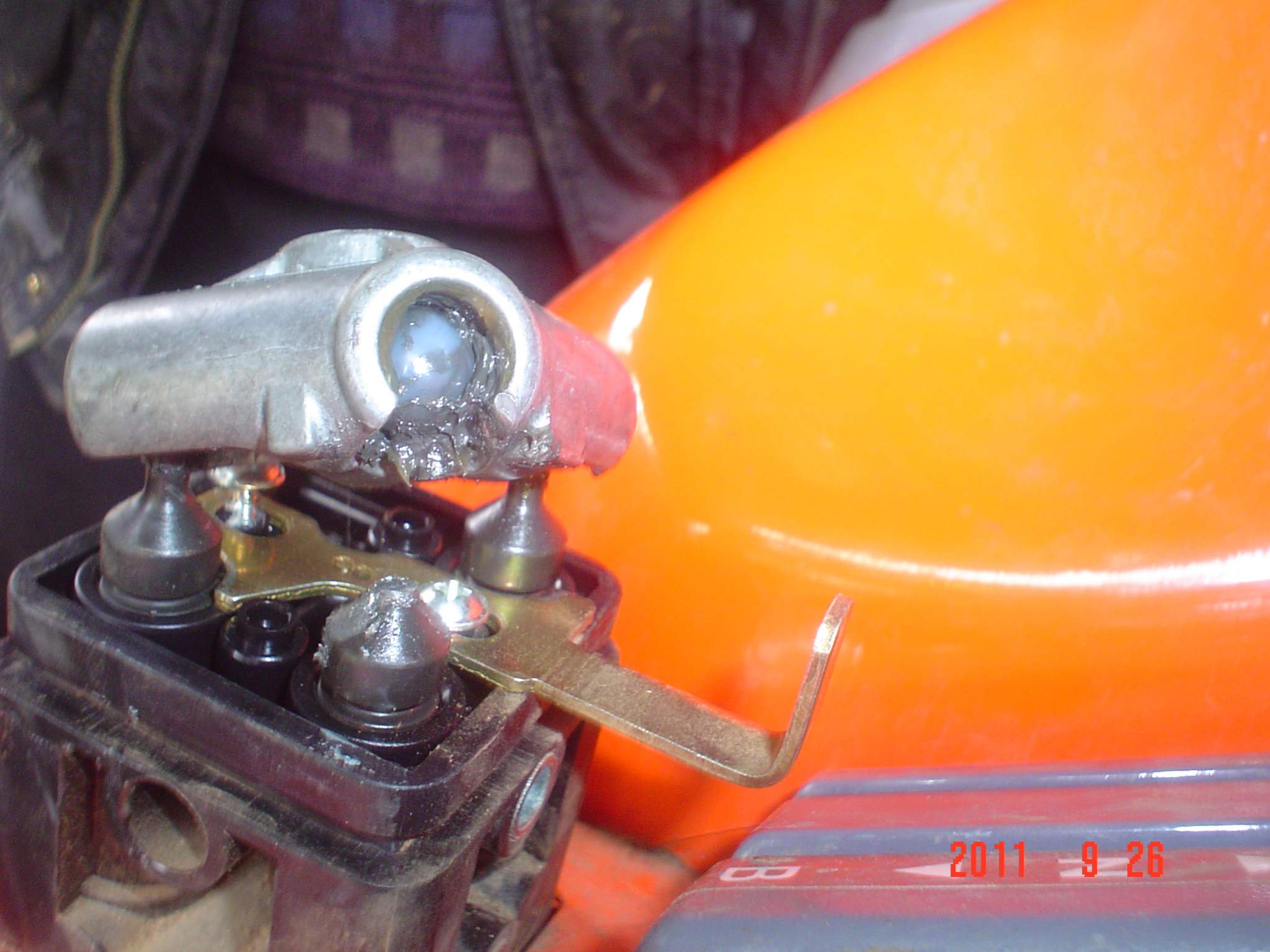

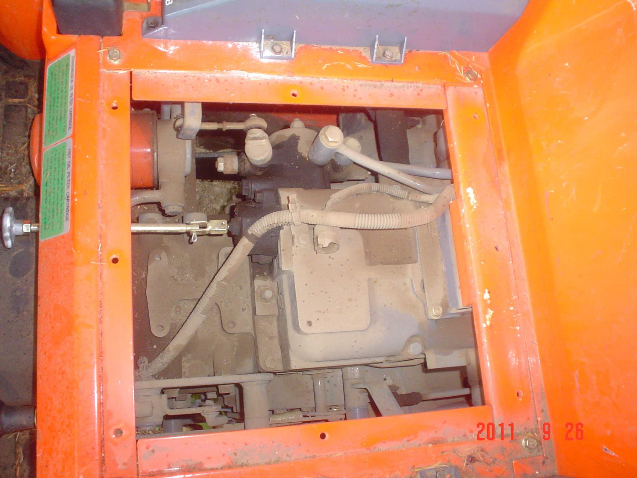

Well it turned out one of the 3 plastic balls had broken off. Took the seat off and loosened the Grey control cover nest to the seat as well as the steel plate this cover is bolted to. Raised the rubber boot at the bottom of the joystick enough so I could unscrew the joystick. Then unbolted the the 2 bolts holding the joystick control box to the tractor. Then pushed the joystick box with the two cable still attached below the tractor. I was able to work on it as you can pull it in front of the back tire. Took the two cables off and then took out the three ballshafts. Found it a bit tricky getting the new ones back in, ended up screwing one of the cable all the way up and the other almost all the way out, this was the only way to fit the 3 ball/joystick housing onto the 2nd ball. Then had to screw the 2nd cable all the way up so the 3 ball/joystick housing was as far away as possible from the black square housing, only then could you put the 3 ball/shaft in. Took me over an hour :ashamed: :confused2: :confused: just to figure out this one step. Made sure the new steel balls had lots of grease. Then reassembled it and works great.
1st pic is the new kit. 3 pic shows the broken ball. Last pic shows the angle needed to get the 2nd ball into the housing.
