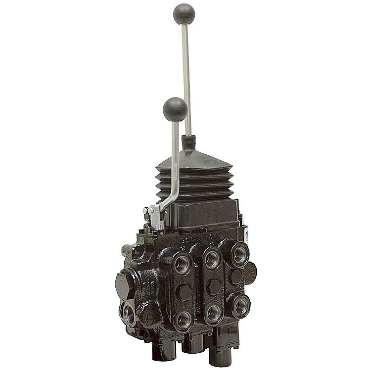

J.J.
What do you think of this? Is it overkill?
/ Installing 3rd Function Hydraulics - Electric over Hydaulic #42
I believe that valve is designed for use with a grapple.
PRICE: $381.95 , and 25 GPM
Does it match your flow.
/ Installing 3rd Function Hydraulics - Electric over Hydaulic #43
PRICE: $381.95 and 25 GPM
I'm doing all this for a grapple, but my hydraulics pump is only 5 gpm. I knew the valve was too much in price and GPM, but I thought maybe. Thanks for all your help and sorry for the ignorant questions.

/ Installing 3rd Function Hydraulics - Electric over Hydaulic #45
J.J.
I used that valve when I put 3rd function on my Kubota L4400. I liked it. Modified the levers so I could get ahold of both at the same time. Worked great, although it's a bit pricey.
