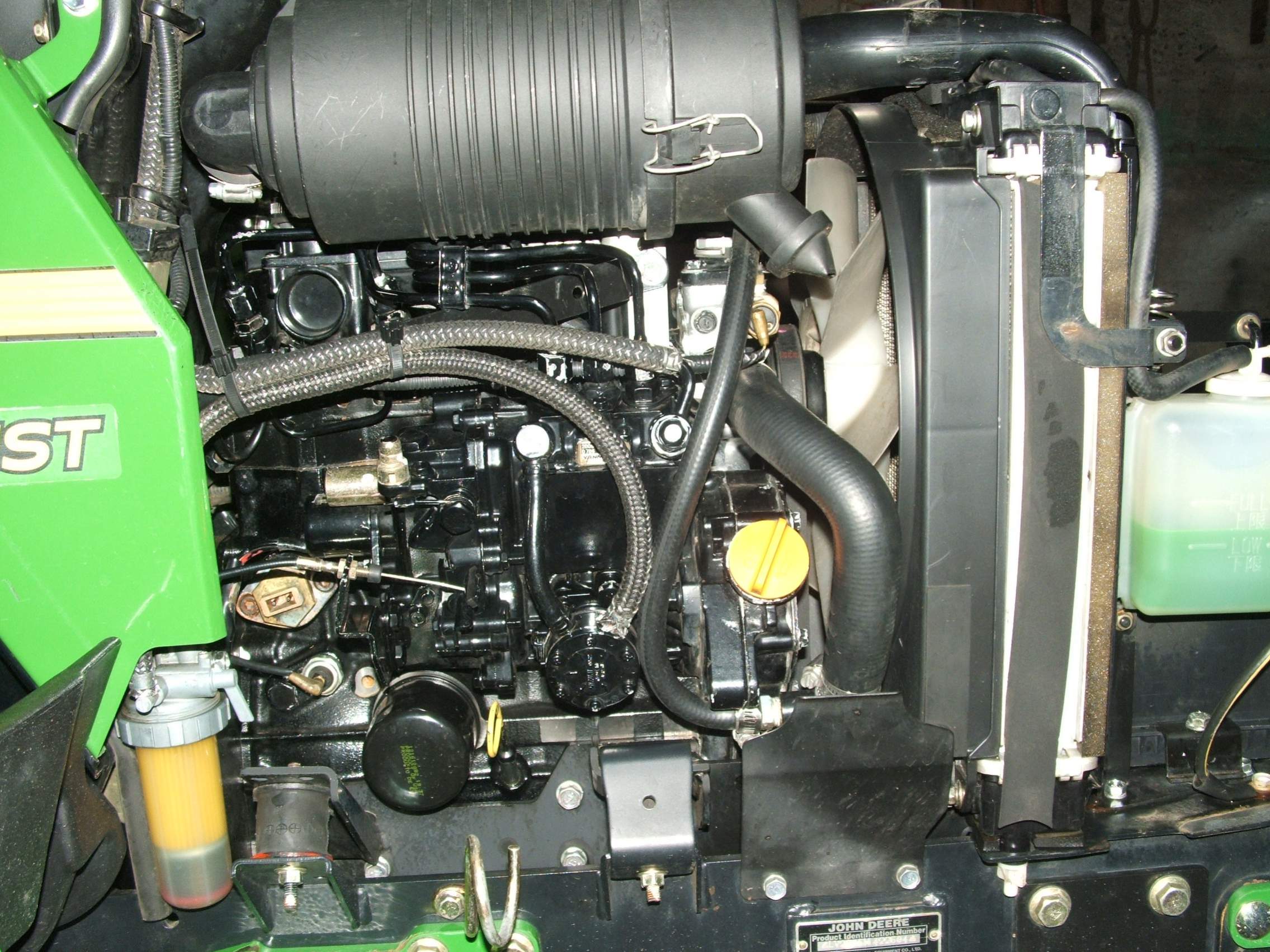

/ installing a block heater #4
Look on the left side of the block, in the middle, kind of behind the exhaust pipe. You should see a 1" NPT pipe plug in the block. Remove the plug and thread in a Zerostart 3100003, plug in the cord and route it to a convenient location keeping it away from the exhaust pipe.
Sometimes the plug will come out easily... sometimes not. I twisted off my cheap 1/2" drive extension and had to remove the exhaust pipe to gain direct access to the plug. Used my impact wrench directly in the plug and it came right out. I used a 1-3/8" socket to install the block heater. The Zerostart block heater can be sourced for less than half the price of the JD block heater.

Can someone post up a photo where it installs at
Thanks
I don't know if this will help. Mine is a 2305 with a 1.1L Yanmar. If you click on the pics it should enlarge it. The power cord is not install.
