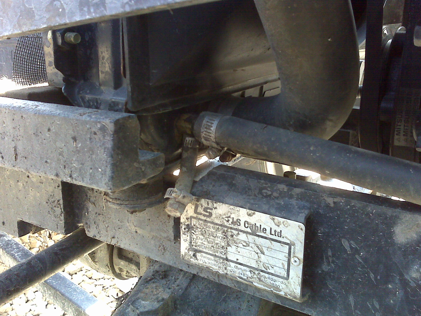

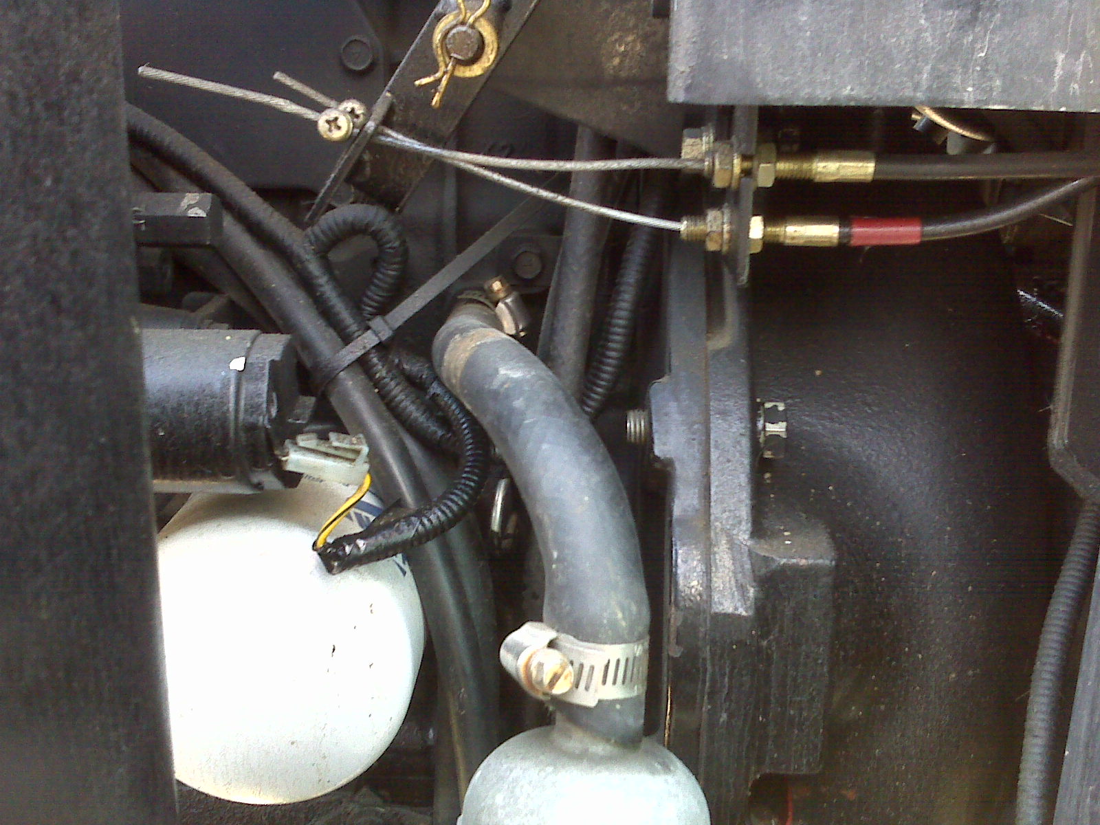

Hi AMPA, sorry for the delay I got into a bunch of overtime at work and this morning was my first day off. I took 3 pictures, the first 2 are of where the bottom hose goes into the rad. It is just plumbed in with a brass fitting. The third pic is where the top hose comes out of the heater and goes into the block. The height differential between the 2 would prob be 6". Hope this helps a bit. I see I forgot to take a picture of the overall heater, you can see the top of it in the third pic. It is just bolted vertically beside the block with a piece of plumbers pipe strap. If you need I could try for a couple more photos. Again sorry for the delay.
Brent

Thanks ever so much Brent, the engine of your ISEKI is a way different than the engine on my G-174, it would seem like the ISEKI Company, goofed on mine and put the oil filter in the way of the engine drain plug, I went yesterday to a place called FluidLine and I was able to look at every brass connecter they had in bins setup in their show room and they had 100's, so I told the sales guy that I needed to look over and choose a number of brass fittings and if I needed help on finding certain connections to mounting this h/pump of mine, he told me just to look over his stock, and if I needed his help for anything that wasn't displayed was no problem as this is what he was there for, so after spending $ 80 I figured I had everything I needed to install this h/pump of mine but forgot all about the rad connection and went back in and the boss served, and he gave me what I needed no charge, which was a bonus, anyhow I brought all these fittings back home and started to install the first fittings to the block drain, this is where it gets nearly impossible, the fittings except for the 90 degree elbow fit okay, but on the other connections seems the oilfilter was in the way, yours mounts to the side of the block mine has the oilpump externally, I ended up usin' the stainless steel connector that came with the h/pump, with this fitting connected I was able to just clear room for the oilfilter, only because the rubber 5/8 heater hose was soft enough to give a little, but still I might have to add plastic elbows as it's a bit kinked, anyhow I was goin' to take the rad plug out and put a brass fitting for the input and the output of the h/pump into the engine block drain, but after readin' the h/pump instrutions this is *** backwards, now I must take the block drain for the heaterpumps input, and run the output of this heater pump to the cylinder head water jackets, the only thing I can see here is they must mean the small bypass hose from the thermostat housin' that connects to the waterpump, or I could maybe remove the temp sensor switch and put in a brass fitting with two openings, the nicest thing is that all these connections are standard pipe threads and not metric, one other thing was the engine block drain plug had a 1/4 in. braided rubber hose comming from it and connecting to the bottom rad tank, I have no idea what this is for, but I put in the supplied plastic "Y" connector, and connected the 5/8 heater hose to one end and reduced the other end to recieve the 1/4 in. with doing this adds bulkyness to the setup and my h/pump bein' 2 or 3 times larger, has me intalling it outside the engine compartment, which is infront of and below the grill, anyhow when I get finnished and it works proper, anyone that needs to install one can by usin' my work around on this same hard to work on G-174 ISEKI tractor, the pump instruction also mention that the output from the h/pump must be as short as possible so maybe I will have to keep this heater pump inside the engine compartment, but where??? I'll keep you up to date Brent on my progress, I know this is long and winded but I needed to explain my mistakes and many problems ....take care.......Ampa:D
