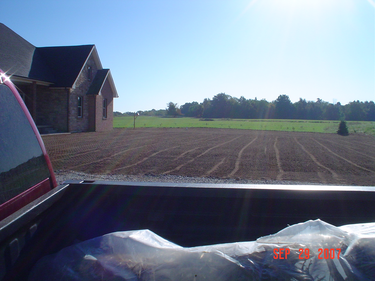

If you want professional results...go rent a harley rake and landpride primary seeder for the weekend. ( I used to install lawns on the side)
