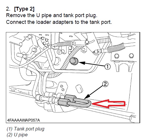

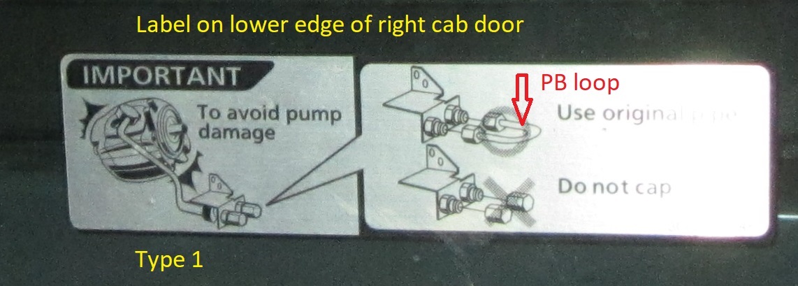

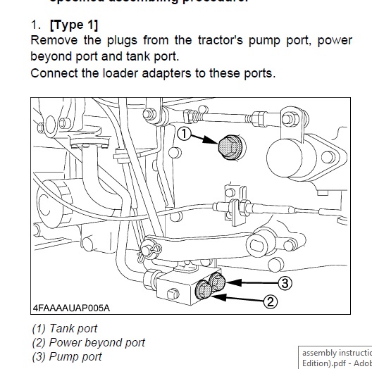

There are two possible hydraulic situations on these M series. Kubota calls them Type1 and Type 2.
Type 2 tractors have the following label on the lower edge of the right door.
The Power Beyond loop I referred to in my previous post is this loop of metal tubing seen on the warning label.
Type 1 tractors have a rectangular metal block. To connect a loader valve into the circuit, the regualr plugs in the rectangular block have to be removed and replaced with special fittings. Think of these fittings like a power beyond sleeve fitted to a regualr hydraulic valve.
Dave M7040
