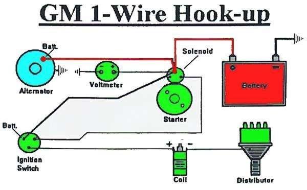

Has anyone every installed a alternator and replacing the generator on a YM146 or simular tractor? The reason I am thinking of doing this is because the voltage regulators keep going out I have replaced it 3 times.

I looked for a link to an older post but couldn't find it...and I still don't know if anyone has actually made the conversion, but here is a simple attachment of the GM 1 wire alternator popular on street rods and customized applications.
If I remember correctly a 60+amp alternator listed for $79.
mark

I am installing a GM CS130 alternator on my 2000BD and was going to make a conversion kit.
I guess I was not fast enough.......
http://cgi.ebay.com/ws/eBayISAPI.dll?ViewItem&rd=1&item=250157160479&ssPageName=STRK:MEWA:IT&ih=015
The CS130 has several advantages over the 10SI. It has better cooling, is smaller, and has better low rpm performance (important on a diesel engine).
It can also be hooked up with a one wire configuration, but since I already have an alternator light, I want to keep it.

I am looking at using a racing alternator with a 3.86" 93mm case made by Denso. It should work great I can rotate the alternator up. I will make a mounting bracket and it will sit under the air intake pipe and above the radiator hose exchange pipe. I will post pics latter. The only problem that I have been warned about is the charging voltage on one unit is 14.9V and on the other it is 14.0V. I was told that the 14.9V unit will boil the water out of the battery.
   / Installing Alternator instead of generator on YM146? #8
I'd go with the 14V model as the 14.9 will over charge the battery if engine is run very long.

Thank you I have ordered a mini alternator from db-electric that charges at 14.2V and is very small 93mm diameter 3.86" and about 4.5" long. It is a 3 wire hook up.
