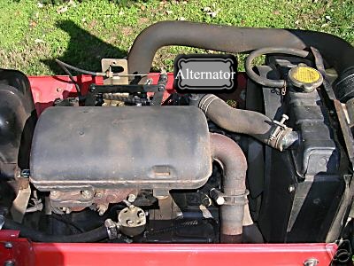

I am getting the alternator tomarrow 9/27 I will post pics and show you the area that it will fit in my tractor. I am rotating it upward so the alternator fits below the air in take hose and above the radiator bypass hose. Here is pic that I found online to simulate the position of the alternator. I will post good pics tomarrow.

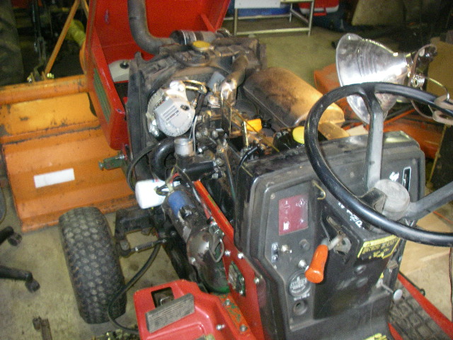

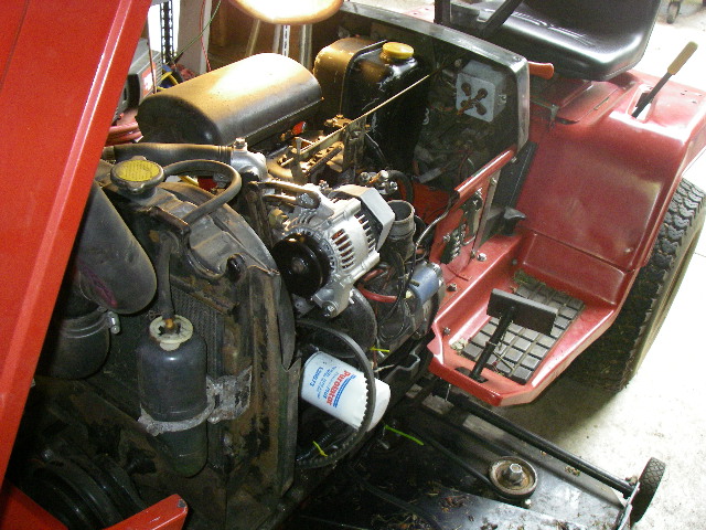

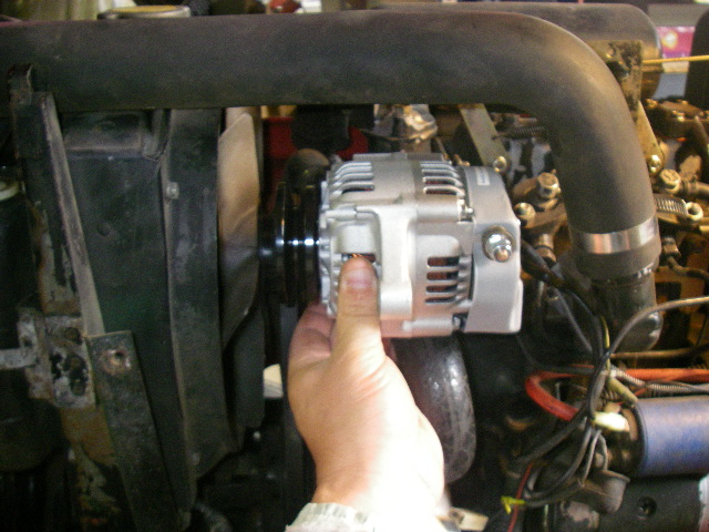

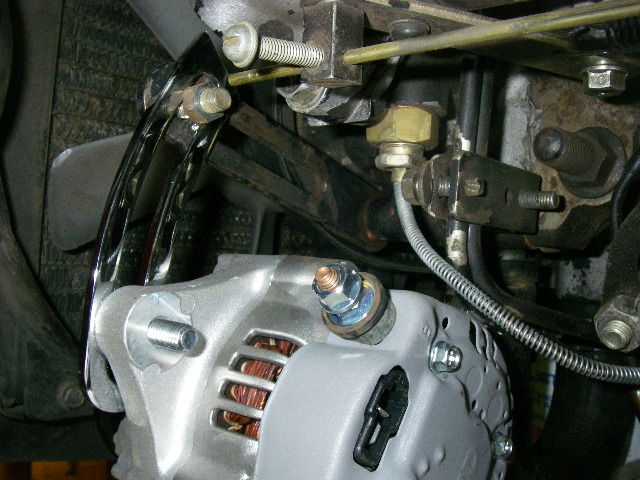

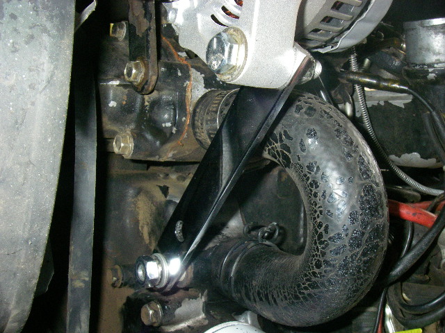

Here are the pics to the unit. I made a bracket by cutting a curved alternator bracket and using the exsisting one. My first attempt at the belt was too small I will pick up a longer one tomarrow.

Finished with the conversion. Charging perfectly even at lowest RPM 14.2-14.5V. I wired it up and now no more regulator problems ever again.
Photo installed from front
Wiring at battery I also used the yellow pigtail to wire the sense wire to the alternator
Wiring from back of alternator
