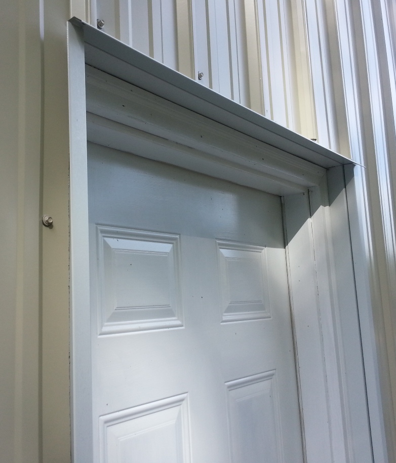

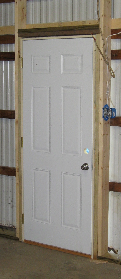

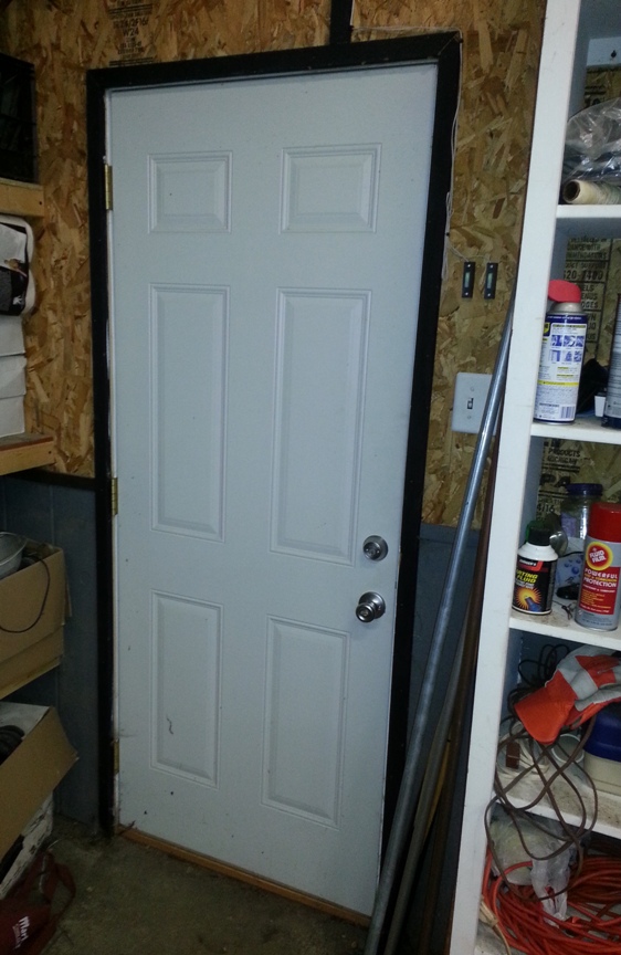

Ok, here are a few more pictures if you would like a little more detail. The first one shows the framing with the 2x4 framing for the door inside the 2x6 framing that goes to the barn itself. I also put 2x6 treated plates on the concrete, anchored with driven nails. The second shows the final trim. A 90 degree angle trim goes just inside the brick mold and over the girts. Then the j-strip on the sides and drip edge goes over that and the siding goes on. I should caulk between the brick mold and trim but I haven't done that yet. The last picture is the finished inside.
