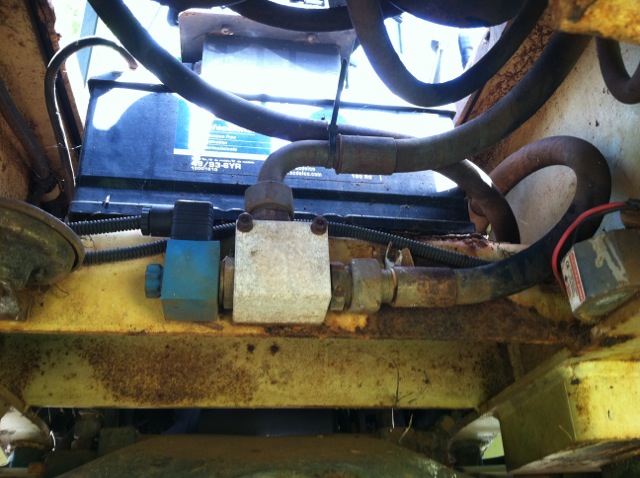

flow restriction? sizing solenoid valve for hydraulic thumb
It is the Ingersoll Rand BL-570 backhoe with 56hp Kubota v2003T engine and separate piston hydrostatic pump for drive system. The steering and loader hydraulics run off a single gear pump so it is open center and apparently has a flow capability of 18 gpm.
I was planning to use the 10 gpm solenoid control valve referred to earlier. But I am concerned about restricting flow back to tank when hydraulics are idling. The hoses and fittings on the original one way breaker solenoid are about 3/4 inch and on the new one the ports are sae -6. I feel like I am squeezing things quite a bit adapting down to this port size. Should I be looking for a 20 gpm valve instead?

Right! so that means returning this which I bought but have not installed, which uses D03 subplate, -6sae ports (as well as returning a bunch of sae -06 to 10 jic adaptors- which attach to jic to 30mm din adaptors):
12 VDC 10 GPM OC DA SOLENOID VALVE
and perhaps getting something like this, which uses d05 subplate, sae -8 ports:
D05 Hydraulic Solenoid Valve 4 Way 3 Position Tandem Center 12VDC | eBay
or if I could find one, something that uses D07 subplate would more accurately match the existing hoses. I know I don't need this kind of flow for the thumb, but I would hate to reduce efficiency of the whole machine by doing a substandard thumb installation. Or is the d05 size going to be enough of an improvement over the D03?
Or, I could go back to the switching solenoid and plumb off the bucket valve. This option would not be as slick operationally, I think, but it would leave the power beyond output flow untouched.
Opinions?

Well this is a new twist I hadn't thought of. Let me see if I understand how this divider valve setup would work.
- Do I put the divider valve's 3/4" input and excess ports in the place where my breaker solenoid currently is; then run the priority 3gpm port to the d03 subplate/solenoid valve; then T the tank line from the subplate and the relief port from the divider valve in to the excess port return?
Then can I do away with the relief cushion valve that I was going to place on the workport lines out to the thumb?
I can see how this would give me the most unrestricted flow back to tank, (which by the way instinct tells me is better but is it a significant concern?).
Cost wise there doesn't seem to be much difference between this divider valve route and the d05 valve route. Setup wise not too much difference either since in one case I need the relief cushion valve and the other case the extra divider valve. Either way I have to return some stuff and buy some other stuff before the installation happens, and wait for stuff to come in the mail.
That leads to this question. Assuming a d05 (not d07) solenoid valve, along with the relief cushion valve on the work port lines on the one hand--
and this divider valve without additional relief valve, and feeding into the D03 solenoid valve on the other hand--
Which is the better installation for overall performance and reliability?
Or if I misunderstood how this installation would work, where did I go wrong?
Thanks.

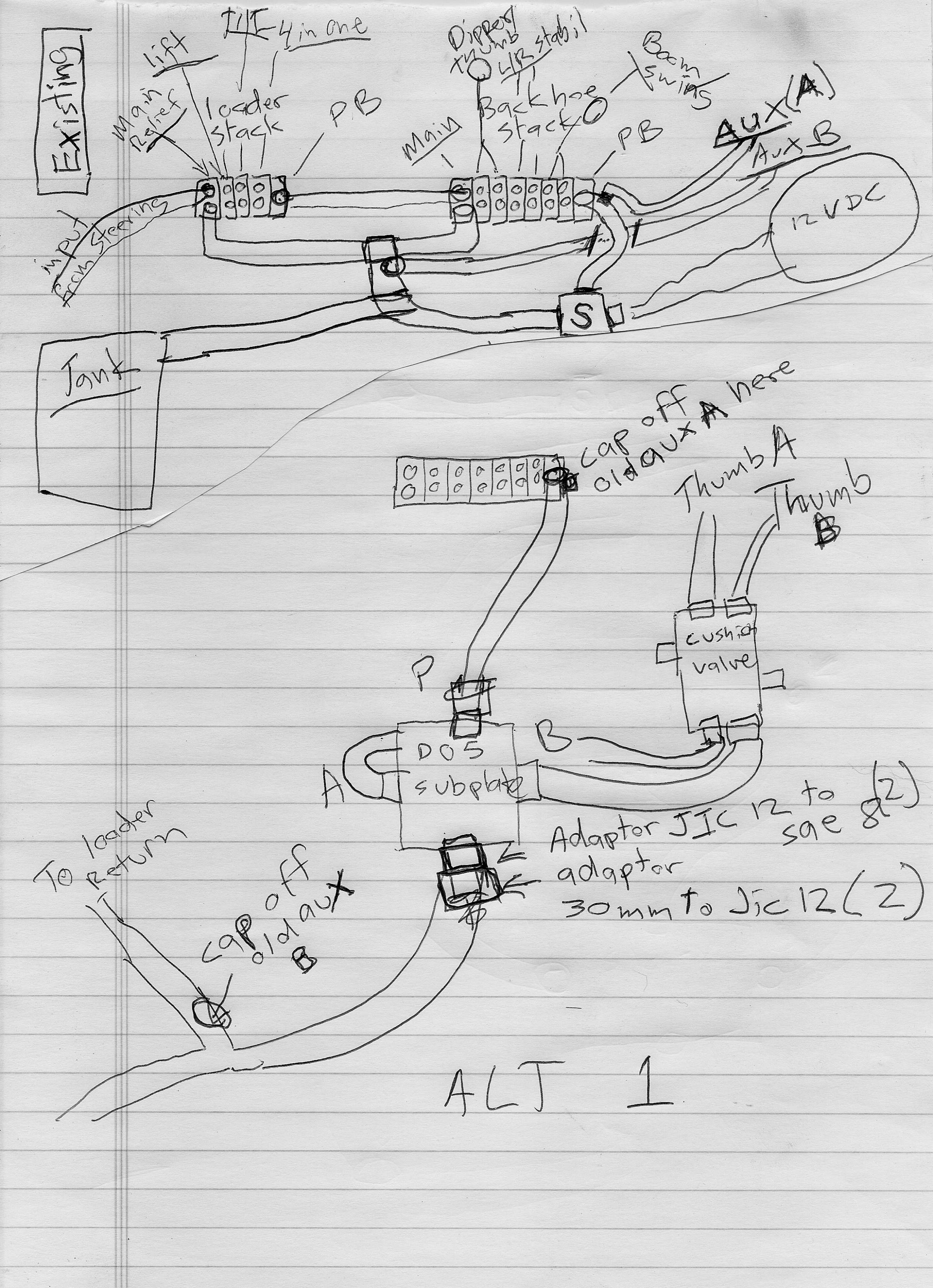

Ok this first drawing shows the existing setup above, and alternative 1, using a D05 sized solenoid valve and subplate, relief valve, and shows where old aux hose Ts shall be plugged. These hoses will mount to ports A and B with metric adaptors.
The in hose to breaker solenoid will go to P with metric adaptor, and the out hose from breaker will go to T w/ metric adaptor.

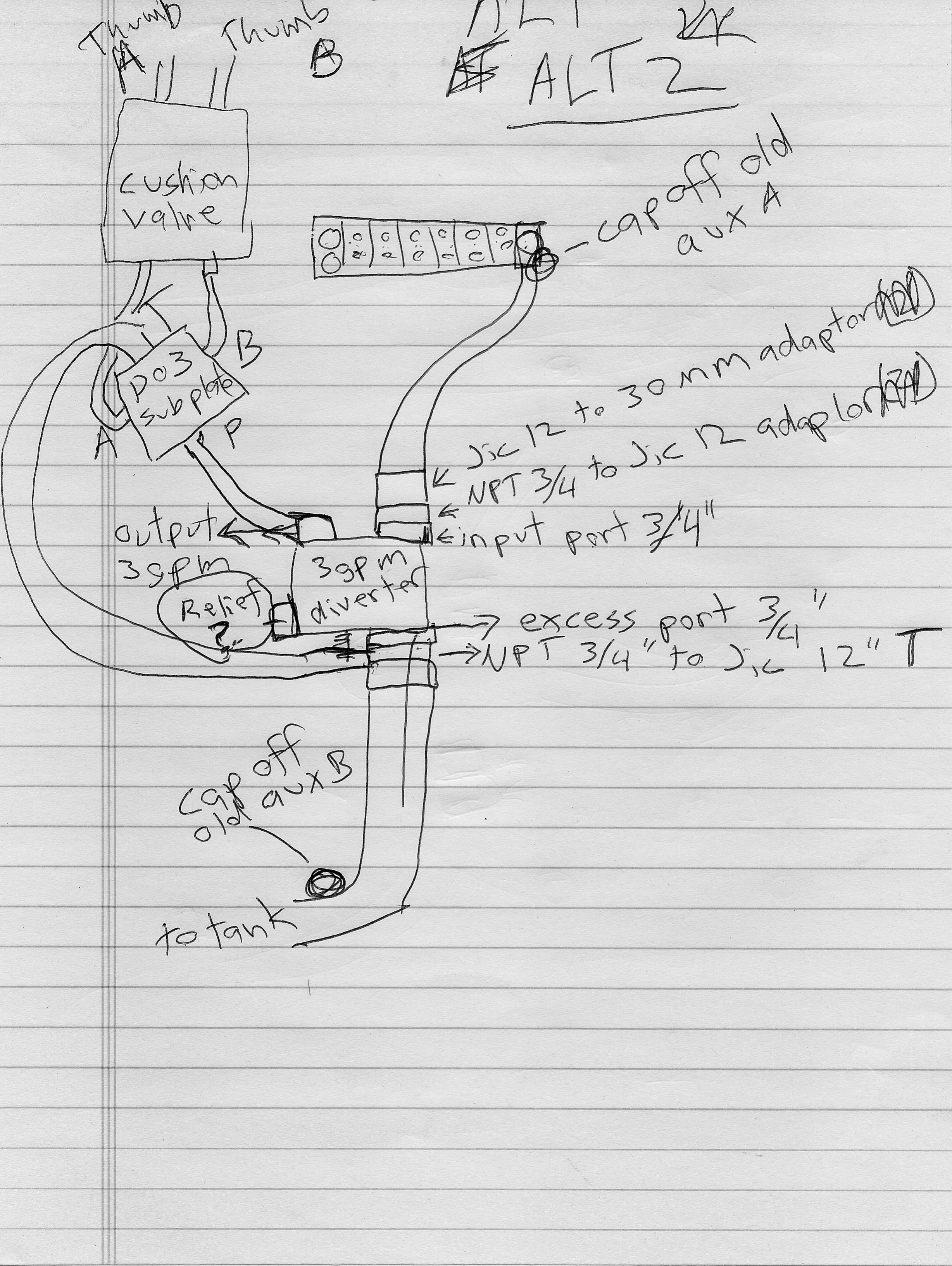

This drawing shows alternative 2, using an additional valve (diverter) and a few more hoses, but using the D03 size control valve.
In hose from solenoid will go to input on diverter valve. Out hose from solenoid will go to excess port. 3gpm port will lead to P on D03 subplate. T on this subplate will lead to tank via a T adaptor at excess port on diverter valve. A and B ports will lead to relief as in alt 1. In this drawing I am not sure what to do with the diverter valve relief port (if it can be plugged or must run also to tank). This alternative has the drawback of greater installation complexity and cost, as well as needing to find space to mount one extra valve, (if I understand the installation recommendation correctly)
But this alt 2 has the advantage of larger port size for freer flow when hydraulics are idling, and perhaps also a more controllable (slower) thumb movement.

In my last post I guess I forgot to ask specific questions:
--What would be the result of alt 1 vs alt 2 installations? I gave my guess but that is speculation on my part.
--For alt 2 (with divider valve), what do I do with pressure relief port if I don't need pressure relief here?
--What would actually happen if I just installed the 10gpm (D03 subplate) solenoid valve without adding the divider valve?
--Other suggestions different from what is described in either of these alts? If this was covered earlier than I missed it or did not understand.
I know a lot of people install hydraulic thumbs, some of them may be as daft as myself and benefit from the distinctions spelled out here. If successful I will be happy to post pictures of results.
Thanks.
   / installing hydraulic thumb #34
Why would you not want relief?
The divider valve is to allow a lower GPM flow to the thumb.
The DO3 would work, as you are probably using the thumb intermittently.
If you use the subplate and not the divider valve, you lose your flow downstream of the thumb until you release the thumb.
You also restrict the flow somewhat.
You don't have to run the engine at full rpm and reduce max flow until you need it..
