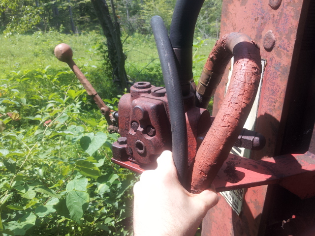

I want to run my post driver on my tractor. I got a power beyond block for my Deutz D4006. After I got it installed and had hoses with quick connect couplings attached to the pb I cranked the tractor. It makes a whining noise like its starving for hydraulic fluid and my 3pt hitch won't lift. I shut the tractor off after a couple of seconds. Then I realized of course that the terminal block that I removed to put on the pb block creates a loop for the hydraulic fluid to return with. Then I had an idea to make a short hose to create a loop on the quick connects at the rear while I'm not using them. However, the post driver for instance, receives fluid from the pb block but it returns fluid into the hydraulic fill port and not back into the pb block. Needless to say I have no experience with hydraulics. There aren't any shops close by for me to go to so I'm on my own unless I can get some advice online. Basically I need to be able to use the post driver and the 3pt hitch at the same time, to be able to lift and lower the driver. Here's a picture of the pb block with the hoses attached. 20140721_133625.jpg

Wait, the post driver has a PB out on it? In that case I'd like to take the flow valve out completely. This way I can run Out from tractor PB to In on PD, Out of PD PB to In on tractor PB, then dump from PD to fill port on tractor. Sound right?
I'm posting a picture of the PD valve. Can you indicate which port it the PB out from it?

Some post pounders have PB.
What brand is the post pounder.
What brand is the valve?
Valves are usually marked with letters stamped by ports.
Try and ID all the ports.
The post pounder OUT port can only go to tank.
   / installing power beyond on Deutz
#9
It is a Shaver HD-10. I emailed their tech support to see if if has one.
   / installing power beyond on Deutz #10

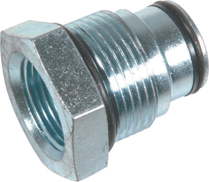

The newer Shaver HD-10 have a conversion plug to make the valve a PB
valve.
I believe the comes with just a plug which makes the valve a open center valve.
I believe a PB sleeve is available to make the valve a PB valve.
This valve can also be converted to closed center.
You may have an older valve.
Look at page 50 and see if your valve looks like that one.
