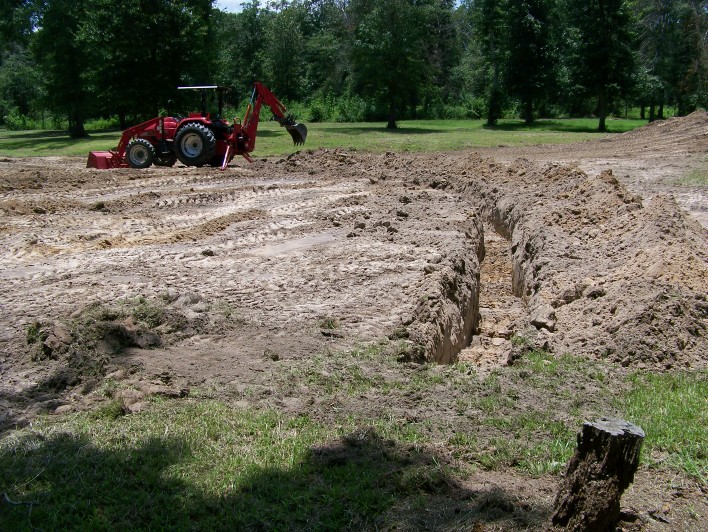

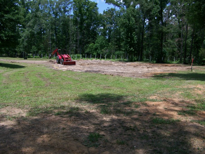

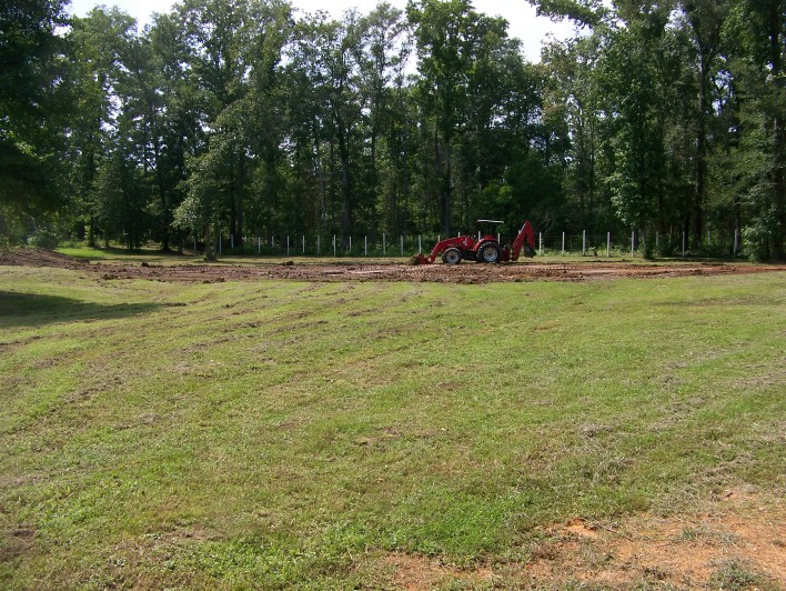

I've been wanting to dig another pond. You can read about the first one here http://www.tractorbynet.com/forums/projects/135413-i-finally-started-my-pond.html.One with an island for ducks. With 11 days off, I figured I could get'r done. First photo shows me clearing topsoil away. The 2nd and 3rd photos show me digging the dam core keyway trench. It was about 3 feet deep by 2 foot wide. I think that is enough as the dam is at the most, 5 foot high. I didn't have really a lot of clay, so I put clay in the core and the center of the dam and build up in 6 inch layers, packing each layer with my loader's front bucket full of clay. The 4th photo was taken from the dam of my first pond. The last photo show me digging a trench in the pond basin, looking for red clay. I found it in some places right below the topsoil. Other places it was under three foot of white clay.
hugs, Brandi 7-5-12 Clearing Topsoil.jpg7-5-12 Digging Dam Core Keyway Trench.jpg7-5-12 Dam Core Keyway Trench.jpg7-5-12 View from Existing Dam.jpg7-5-12 Searching for Dam Clay.jpg

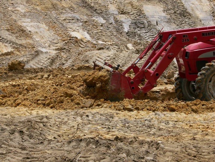

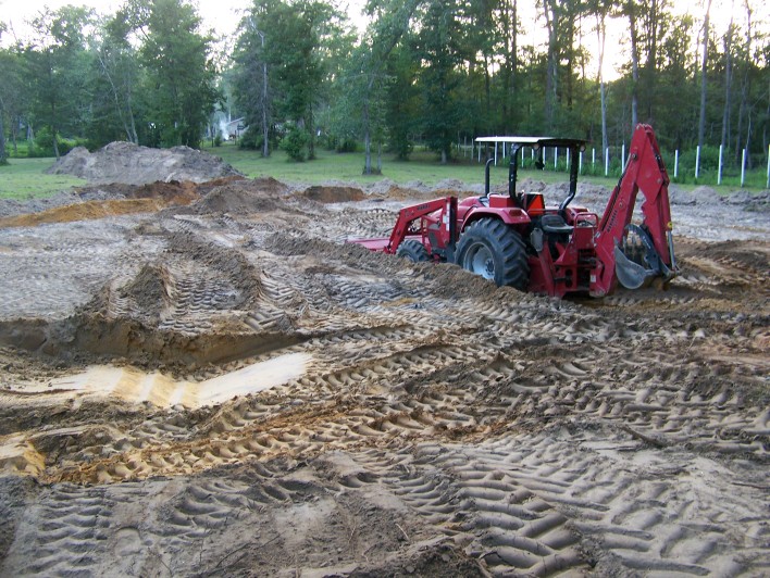

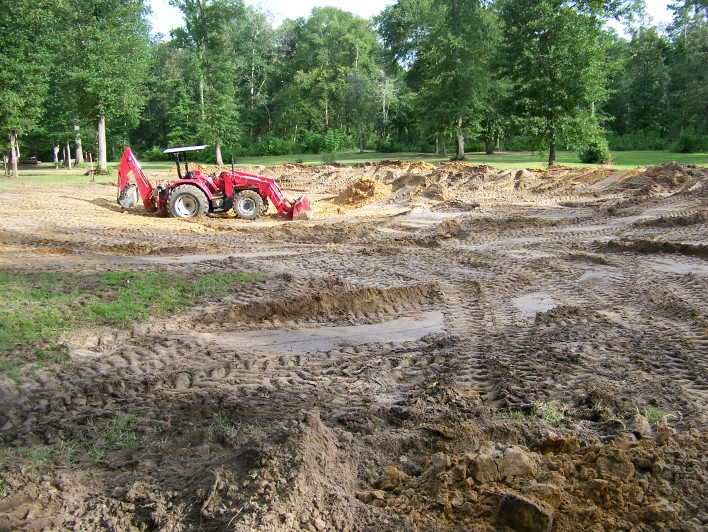

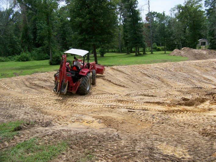

One thing you need for pond dam's is clay. My first pond was all clay after the topsoil, so I pushed huges loads of clay up the dam. It makes a nice slope and less hauling this way. On this new pond, I had to dig clay and fill at the same time, so at times I was dozing clay and fill dirt and at times I was hauling clay and fill dirt on the dam. The center core of the dam is all red clay, with fill made up of red, white, and yellow clay. This all shown in the first 5 photos. The last photo is showing Booger, my constant tractor buddy, wanting some attention.
hugs, Brandi
7-8-12 Pond Taking Shape.jpg7-9-12 Pushing Clay.jpg7-9-12 New Pond with Barn In Background.jpg7-9-12 Big RED Beast going up dam with clay.jpg7-9-12 Big RED Beast in Pond pre island.jpg7-9-12 Booger Wanting Attention.jpg

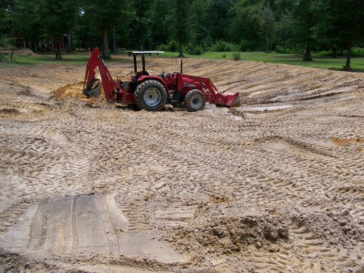

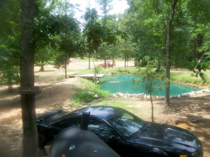

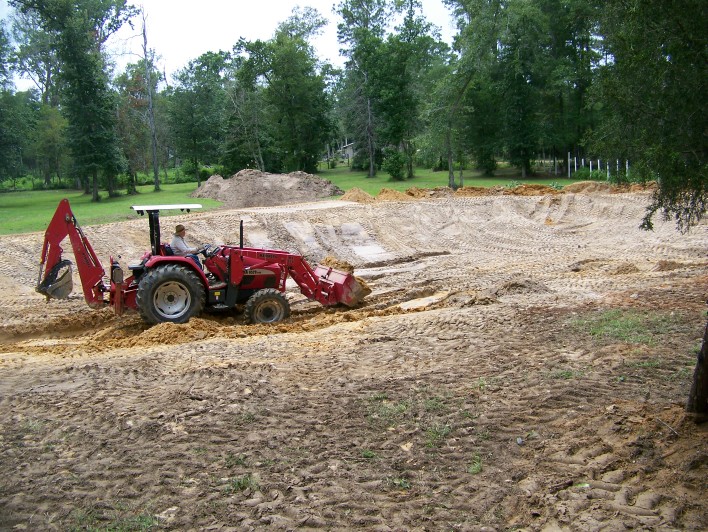

First photo shows both ponds can be seen from the kitchen window and the back porch. My driveway curves between the ponds. 2nd photo show the underground pipe from the first pond. It runs through the dam and under the driveway. I wanted it supply a water trough I thought would go there. Now I can hook a pump to it and fill the first pond, or just open it and fill the second pond.

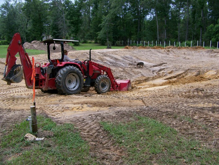

3rd photo show me going up the building up the dam. I love doing all of this, but after a while, it all wears you out in the hot weather. Turning and going up the dam is slow going with the bucket loaded. I would rather travel up and down the dam, at an angle, with the bucket loaded then empty. Dropping that loaded bucket makes a great anchor when a rear tire dips down too low and moves the seat of your pants!
I really wanted an island in this pond. I decided my area was too narrow to build a pond, with an island, with the Big RED Beast. I did not want to use the backhoe digging this pond. I did that on my first, smaller pond and it ate up around 90 hours on the hobbs meter. I wanted to dig this pond with only the front loader hauling and dozing clay. So far this pond is about 80% finished and I have right at 28 hours on the hobbs meter. So I dug the pond to depth and shape, then piled the island back in. Since it is narrower than I wanted, I only have sloping end. No side slope for ducks to come and go at various water levels. The last photo shows the island taking shape. This all took place on the 9th. So 4 days and counting. So far I only had an 1/8 inch of rain Saturday night, the 7th and 1/8 inch Sunday morning, the 8th.
hugs, Brandi
7-9-12 Both Ponds viewed from Back Porch.jpg7-9-12 Digging clay with Booger and flagged faucet.jpg

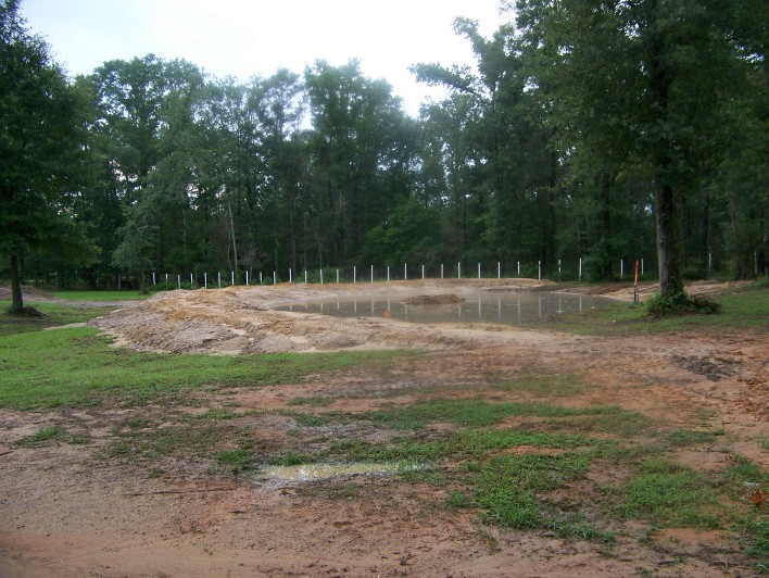

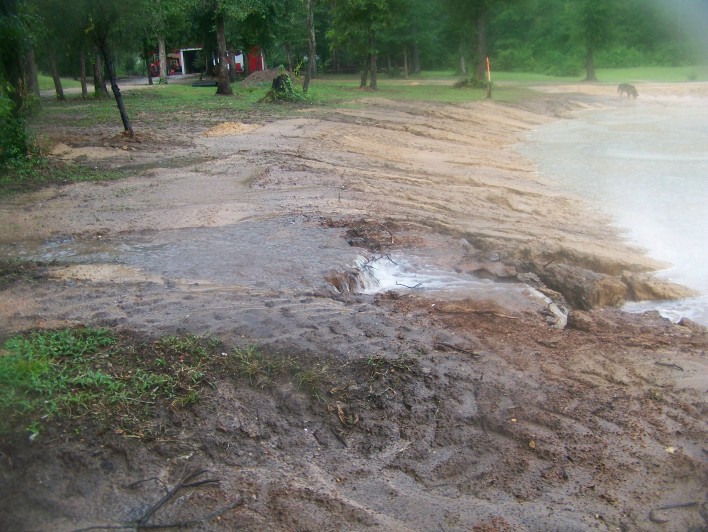

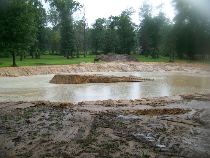

So by now I am guess you wonder why I named this thread instant pond. I started it on the 5th and today is the 10th. I had to go to town this morning for more off road diesel. Before I could get the diesel supplement added and into 5 gallon cans, a thunderstorm dropped the bottom out and put 2.5 inches in my rain guage. I kept watching the new pond from the barn, noticing water about 1 foot deep. A few minutes later I looked again and got scared. The pond was about half full. By the time the rain stopped, the pond was full. Tomorrow I go buy the overflow pipe. I am thinking I need a 24 inch culvert for overflow. My smaller pond only has a 12 inch overflow culvert. My plan was to add an elbow to the first ponds overflow culvert and build a berm to direct it into the new pond. But not now. I have way plenty of water for the neighbor's water shed and the far side road ditch. The near side road ditch feeds my smaller pond via a earthen berm. Needless to say by the photos below, I have some major maintenance to do on the new pond. I was hoping to finish the dam this morning. The top 6 inches of clay wasn't even packed with the loader bucekt full. Just a lot of trips along the dam. I also need to seed real quick.
hugs, Brandi

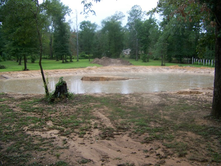

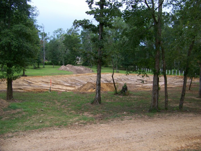

Well, I just got back out to the pond and flagged where I want the overflow pipe to go and a couple of other photos. I am going to have to get a boat, as I want to plant a cedar tree out on the island, along with a small house for the ducks.
1st photo shows the new pond from the old pond's dam. My driveway is in the foreground. The 2nd photo shows the pond full and the orange ribbon stake I marked for the overflow pipe. I guess I will install a 24 inch overflow pipe. Compare this photo with the first one in post #1 where I am removing topsoil. Big difference.
Third photo shows a good shot of the sloped island that was not finished!
hugs, Brandi

Help:begging:.........it's been raining:umbrella: all morning.:shocked: The last hour I was out on the BRB digging up clay spoils I put in the gully from the first pond. The BRB doesn't mine the rain, but my pasture sure turned into a pig's sti. I added the clay and some topsoil to the end of the dam in a "J" shape to let water overflow around the end of the dam. The water is about a foot higher than where I staked the overflow pipe to be, last night. I also added some topsoil on the dam in a low spot to add mass. The island has about 6 inches left above the water. Going to get an overflow culvert after I put more dirt........and clay if I can get to it, on the end of dam. Looking at weather radar makes me sick right now.:worried:
When you come for all my excess water, bring two extra buckets and a :boat:!
