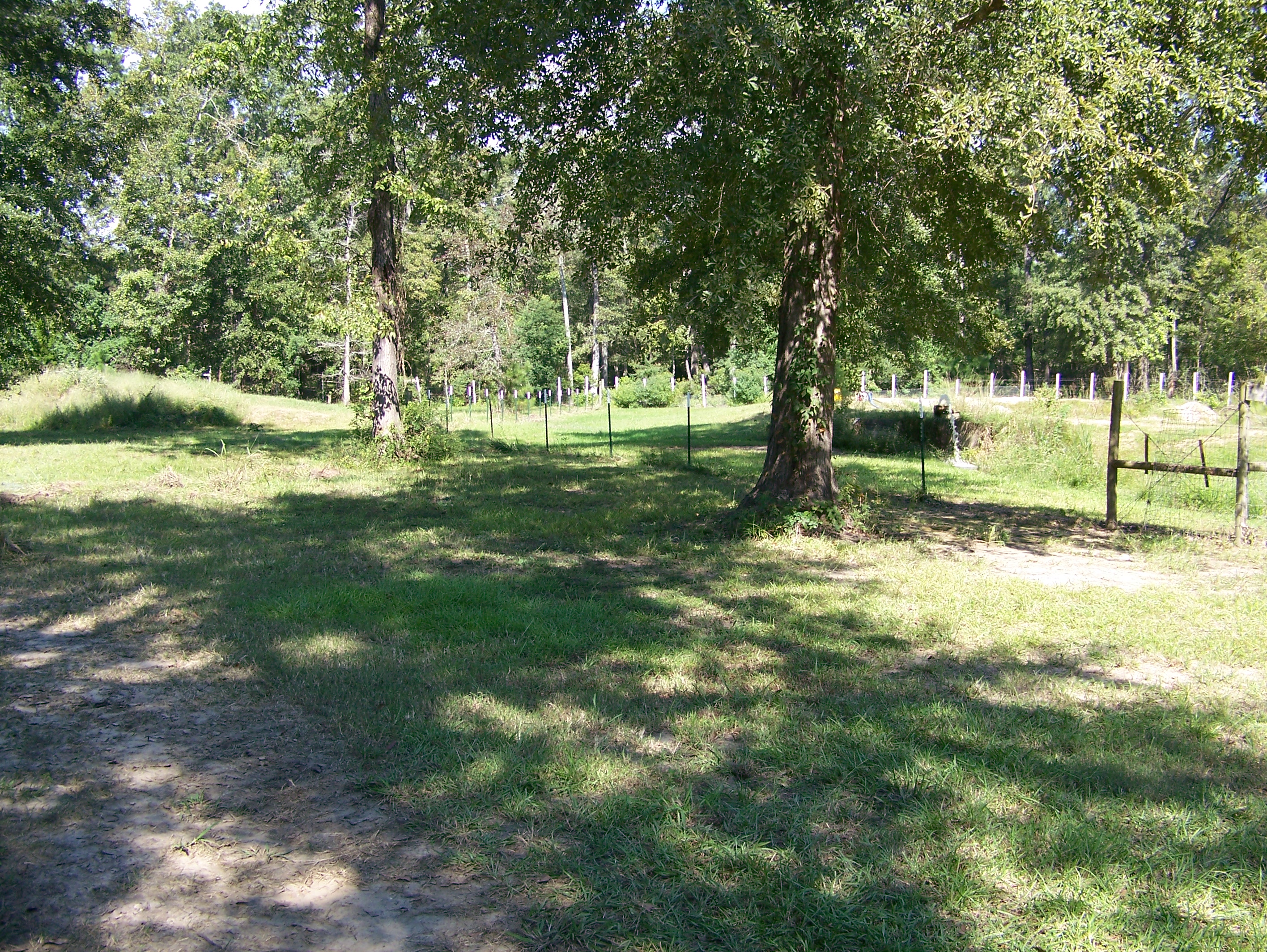

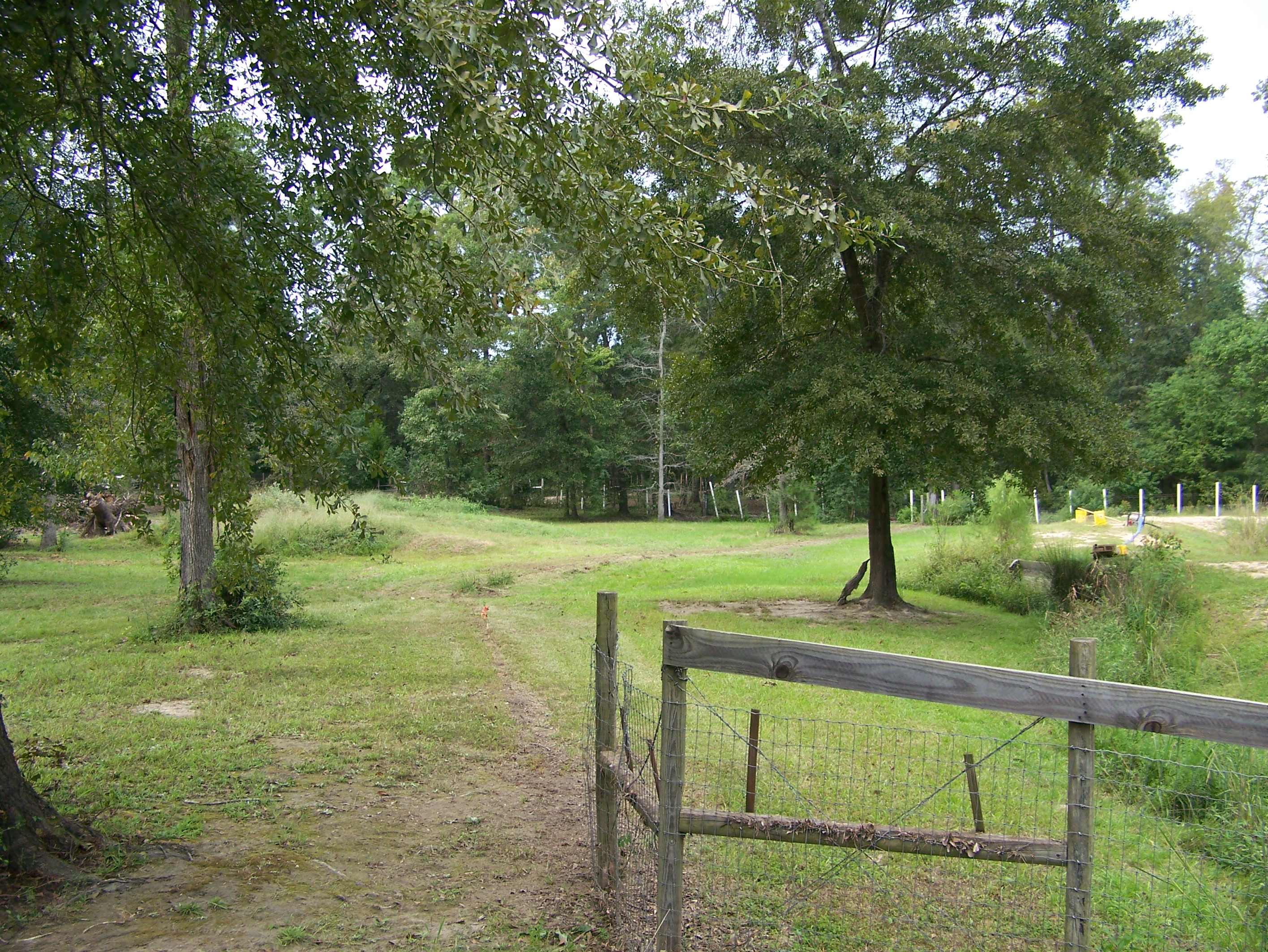

I took down the fence behind the dam. It was easy as I used steel posts. Guess I knew in the back of my head this fence was temporary. 10-1-16 Fence Wire Behind Dam Down.jpg10-1-16 Fence Behind Dam Gone.jpg

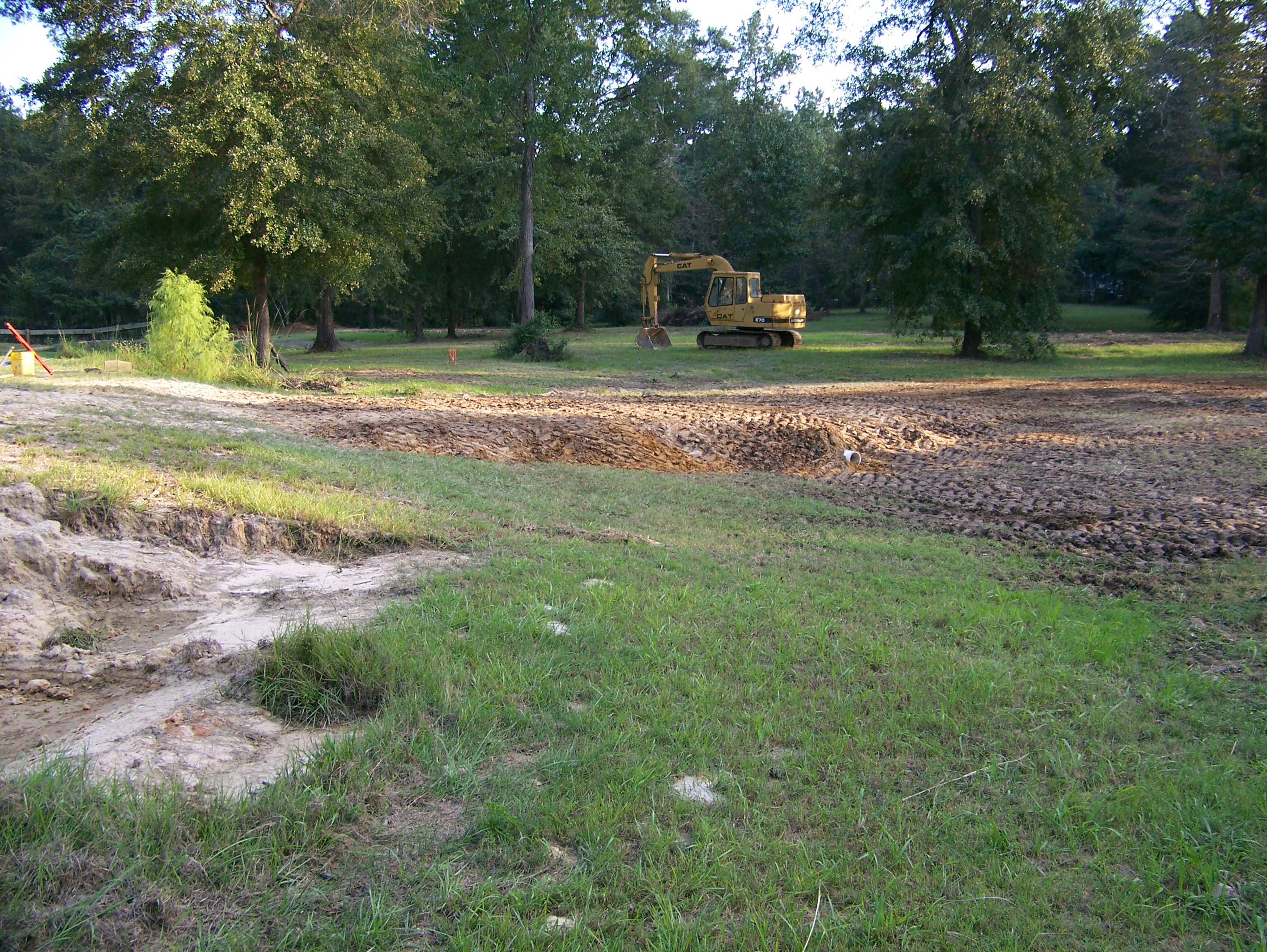

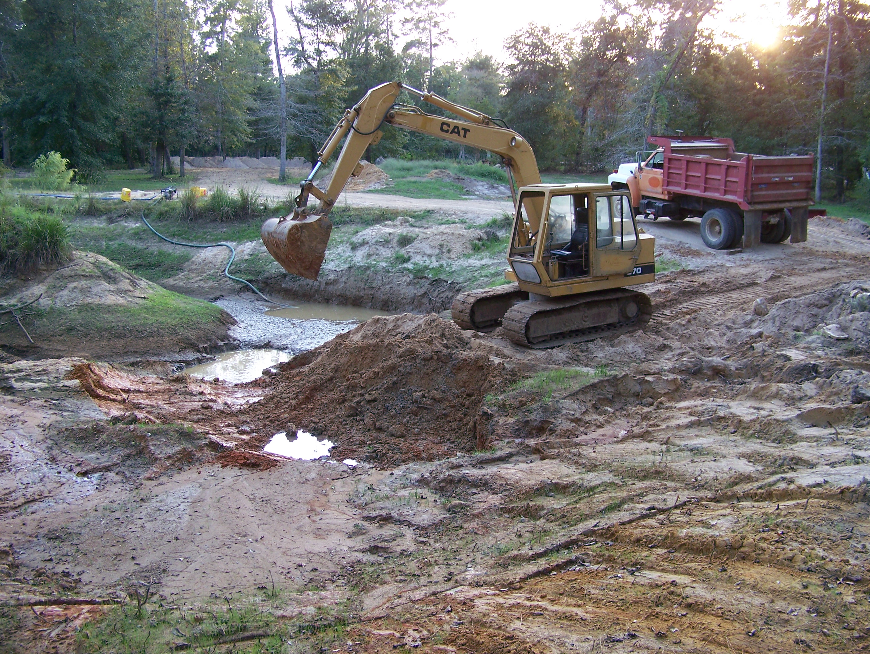

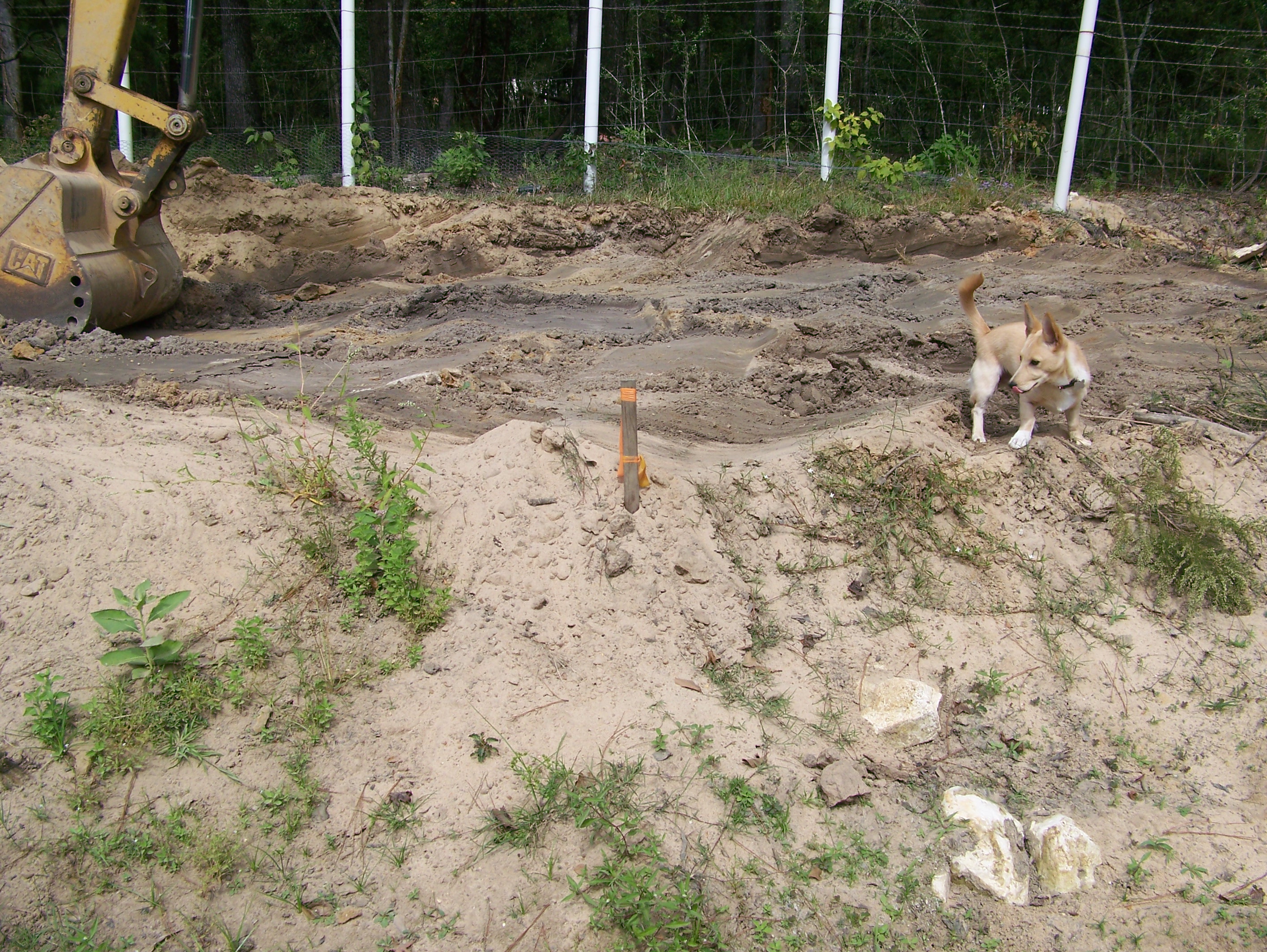

Friday, I knocked down the top crown of the dam so the dump truck has a flat surface to load on. I then started taking out the end of the dam down to the water line. 10-14-16 Taking Dam Out.jpg10-14-06 Dam Coming Out by Sump Hole.jpg
This stake by Fritz is my full water line. 10-14-16 Pond Full Water Marker and Fritz.jpg This is where I'll take the CAT down into the pond's basin.

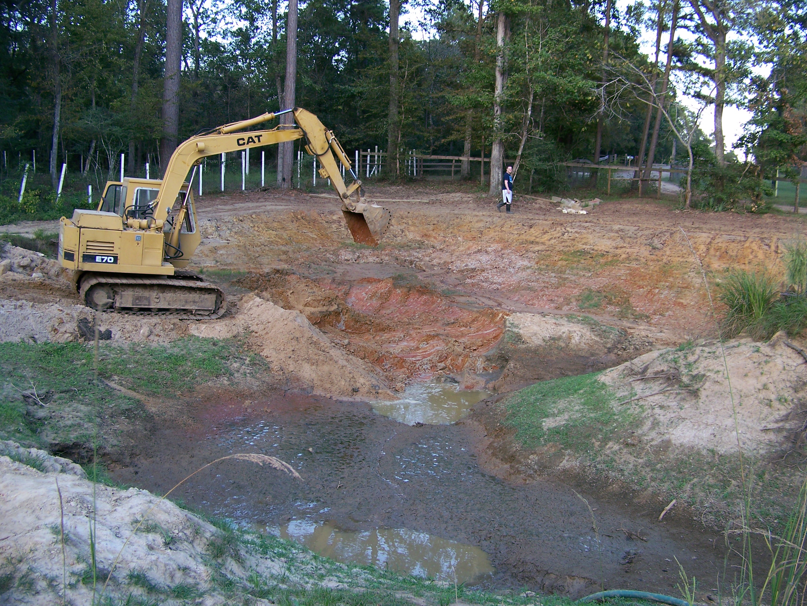

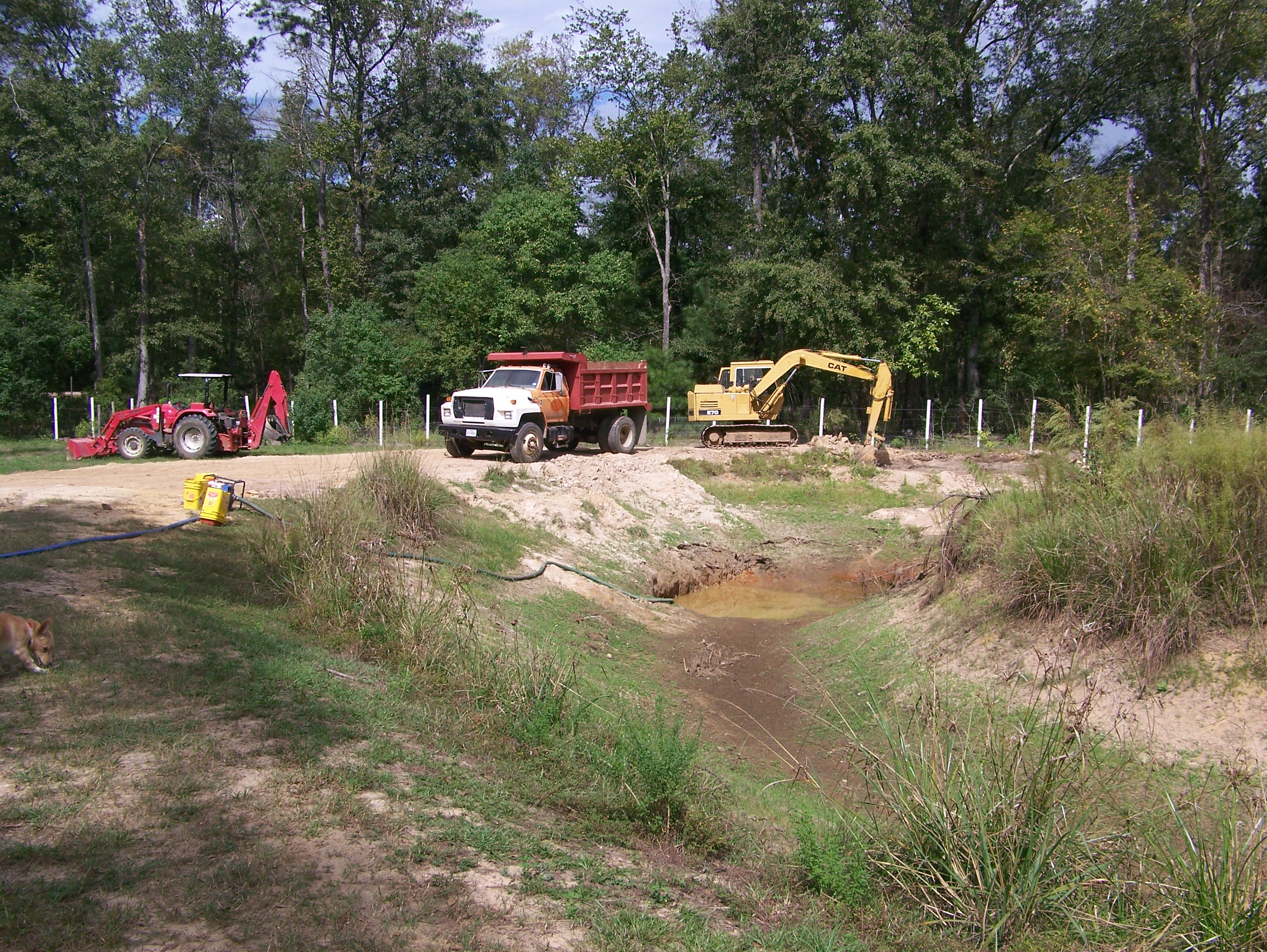

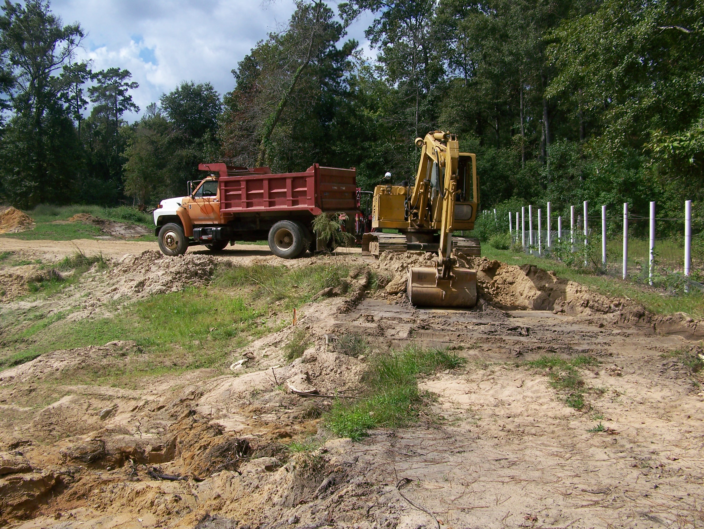

I finally got CAT down into the basin. I'm getting a lot of red clay here. I'll be saving it to line the pond where I'm finding water seeping into the pond. 10-15-16 CAT Cleaning Out Silt and Clay.jpg
I am piling dam spoils in the background here. 10-15-16 CAT Doing Her Thing.jpg
I'm building it up back there to match my neighbors property, where he raised it two feet. This will keep the overflowing gully away from the dam, when I move it. Yes, I will be moving half of the dam to take in all water running behind the dam now.

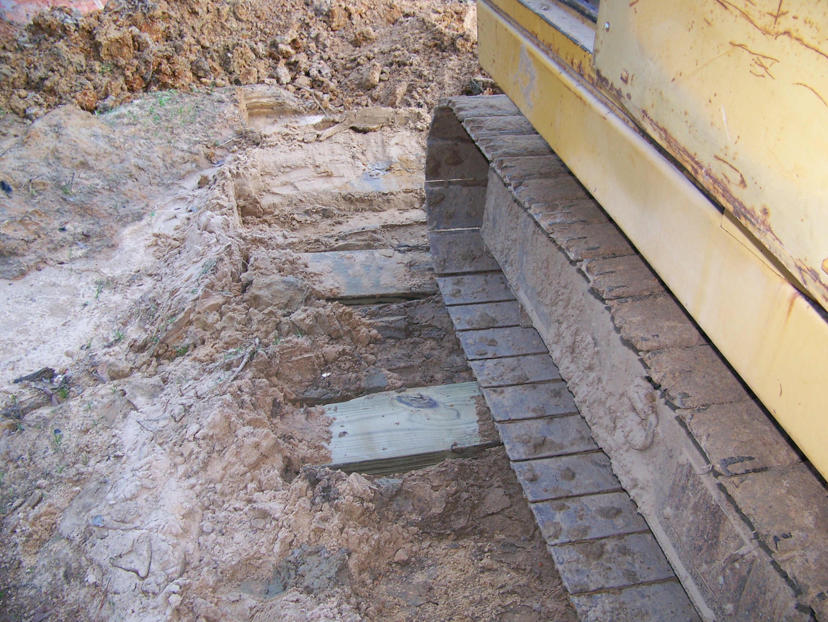

I made mud mats out of treated 10 foot 2x10s. 10-15-16 Mud Matts.jpg I nailed two 2x6s to each 2x10. So far they are doing the job keeping the CAT out of the wet sand that silted in. But they are HEAVY. I really need a thumb on the CAT if nothing else than to position and remove the mud mats.
