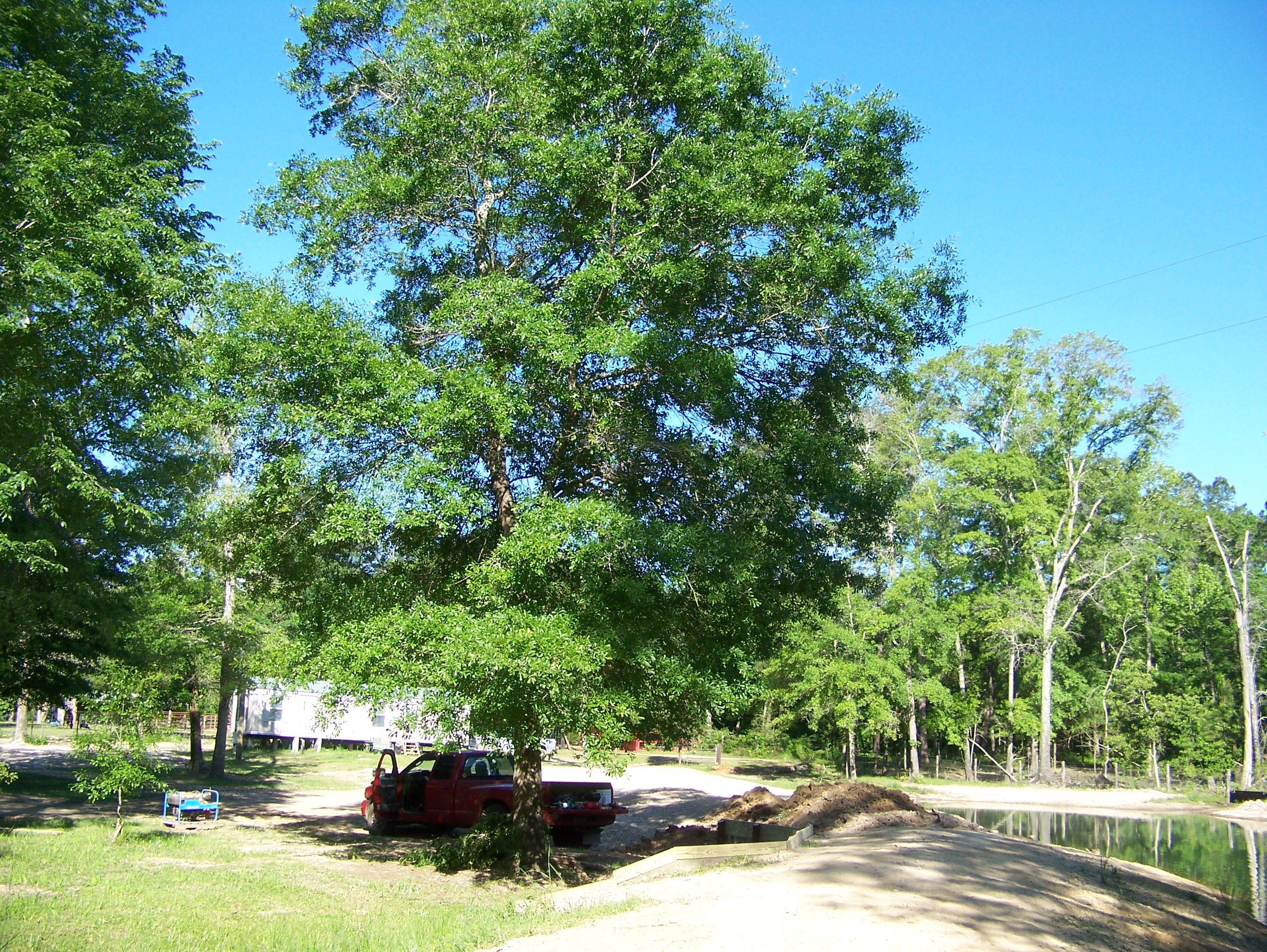

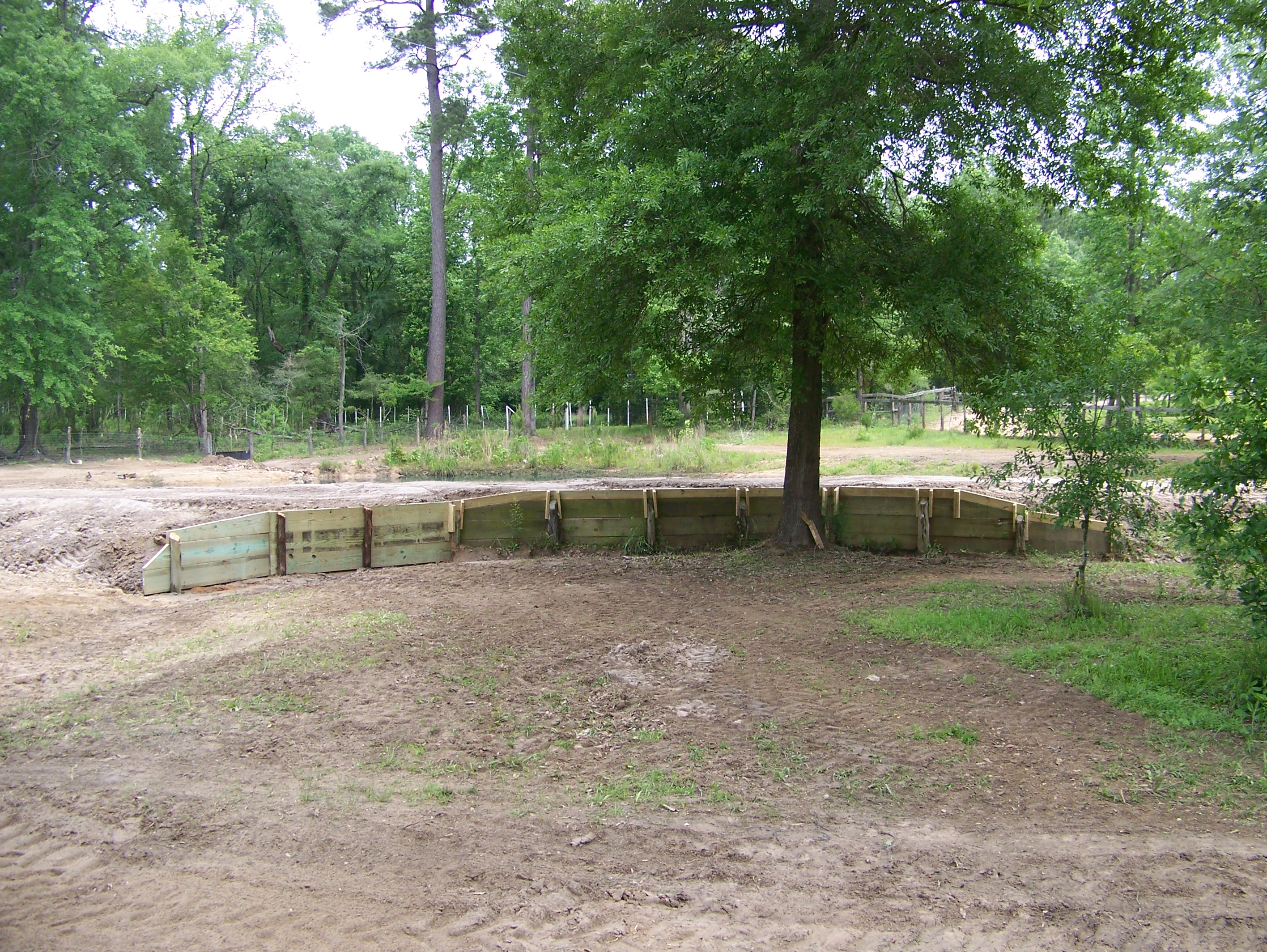

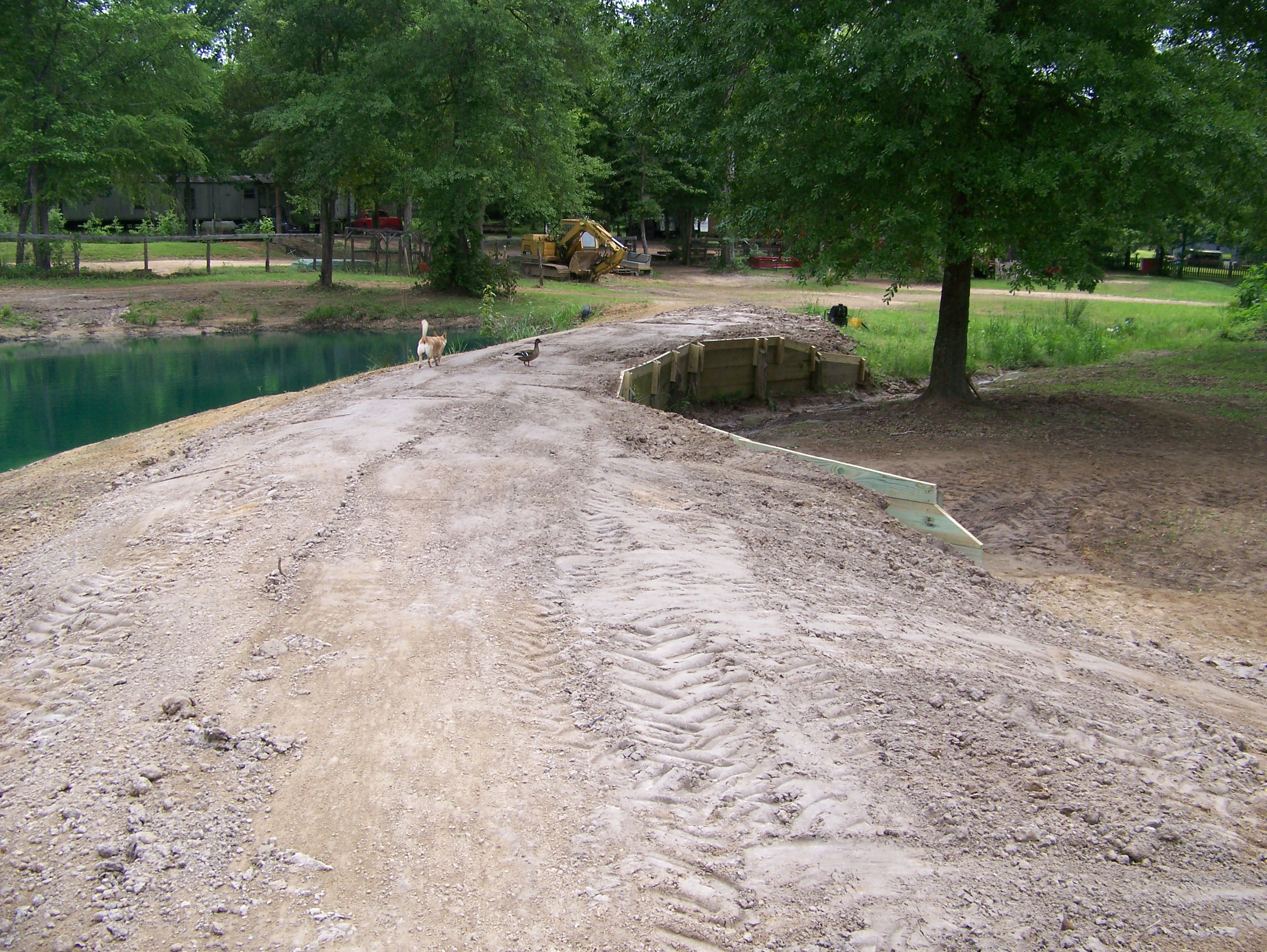

I was able to remove all the spoils pile on the fence line side of the pond. 4-21-20 Spoils Pile Removed.jpg I moved this pile to the bulkhead that I extended for a little wider dam just past the bulkhead.4-20-20 Bulkhead Extension.jpg4-21-20 Bulkhead Profile.jpg4-21-20 Bulkhead Extension.jpg The bulkhead is there to save this tree's roots from the dam. 4-20-20 Bulkhead Tree.jpg

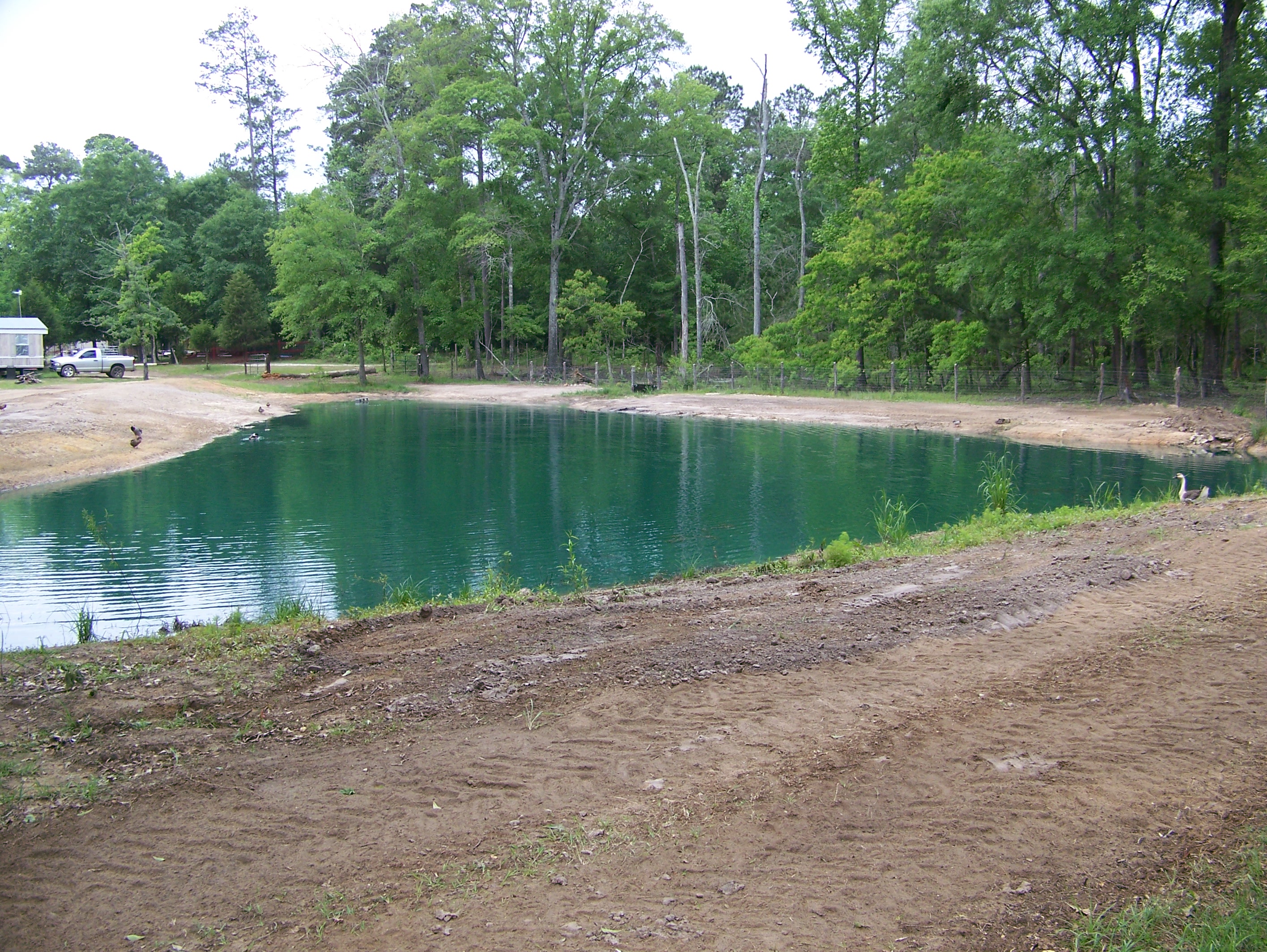

Hey Brandi. Awesome looking pond. Does the water stay clean enough so you can swim in it ?
   / Instant Pond
#448
Yes. Without the pond dye in the water you can see down also 2 feet. The Blue Bayou (TSC) pond dye to rid algae blooms. Which reminds me to add more, as it has thinned out since the last rain.
