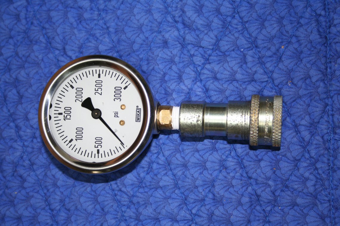

Before any adjustments to the relief valve, one should know the pumps psi limits, and stay about 50 to 100 psi below that.
You will not know the PRV set pressure unless you install a hyd gage in the system, or make a plug in gage setup.

I agree w/that, I would love a plug in gauge setup and remotes front and rear but all those parts add up quickly, but I will definetly be adding a grapple someday, most likely homemade

Oh that's not bad, maybe i'll get to that sooner than I thought, thanks
