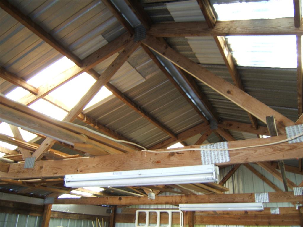

Hello all! I'm considering a project on an existing pole barn and thought I would ask some advice from TBN'ers. It's a typical pole barn, metal siding and roof, 24x36x8 tall with trusses on 8 ft. centers & concrete floor. I'm wanting to insulate walls and ceilings. The trusses have held up for 22 years but with the added weight of ceiling and insulation I plan to build extra rafters in place so they will be on 4 ft. centers. I will then add 2x4 purlins (if that's the correct term) between the ceiling joists to nail 4x8 osb to. I would like to blow wood cellulose in ceiling but am not sure if the weight of the ceiling and wood cellulose will be too much. I then plan to add studding on 24" centers and use fiberglass insul. and vapor barrier on inside and then use osb for walls.
Question #1: Am I addressing the structural ceiling issue correctly?
Quesiton #2: Any better ideas for insulating walls?

Ralph it looks to me like the bottom cord of your roof trusses are 2x8, is that the case? If so I think you will be fine with the added weight. I would run 2x4 purlins vertically like was done for the roof panels.

Ralph,
Can you post some pictures of the actual truss?
By building another truss in between the existing one, and then adding purlins to the trusses, you are probably going to be fine. It sounds like allot of wood and money to go this route.
The 8ft spacing of your trusses makes it hard to span the distance between them to add OSB, so I'm wondering if you've considered using metal R Panels?
Your building is 24 feet long, so you could buy the panels in 12ft 6in lengths and screw them into your bottom chords. Overlap the panels and screw them together will make them plenty strong. If the trusses are engineered, they will be able to handle the weight. If they are not, it's anybodies guess.

I have attached a pic of the truss. They are engineered 2 x 6 trusses. I like your idea of putting purlins between and adding metal for a ceiling. It would make it a lot brighter. I'm still a little hesitant to rely on the 8 ft. span between trusses; I would rather be safe than sorry...it may just take me a little longer to build up the piggy bank. (it's been uninsulated for 20 yrs. - another few months won't hurt) I think I'm going to also look into pricing it for the walls also. How had you planned to cover and insulate your walls?

Looks like you have some very strong, well built trusses. No worries there.
I'm just guessing here, so it might not work, but I don't think you need any purlins with a metal roof. It only has to be strong enough to span 8 feet and the insulation. The ridges on the panels should be able to span the distance, and with screws, you shouldn't have any problem supporting the weight of the insulation.
