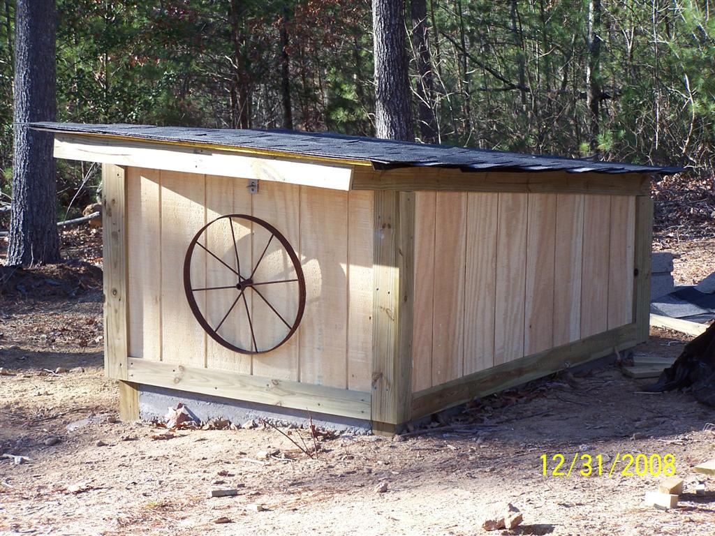

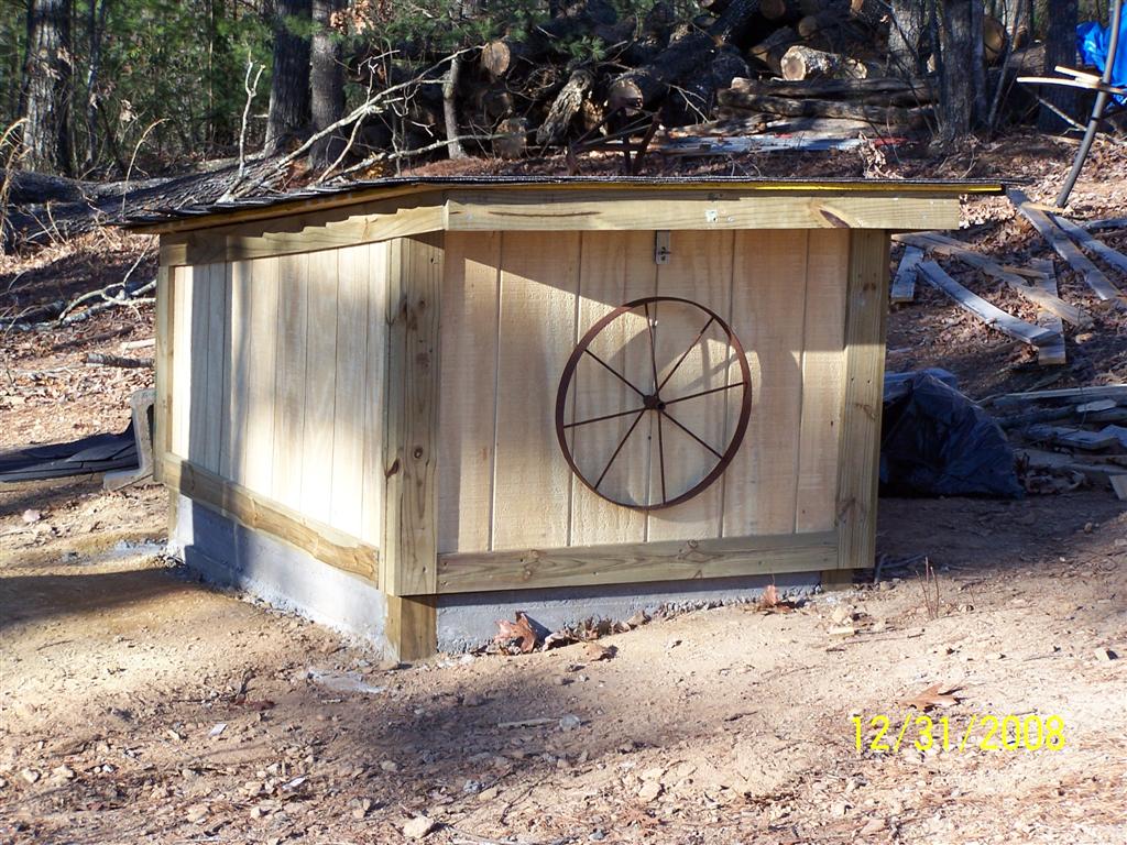

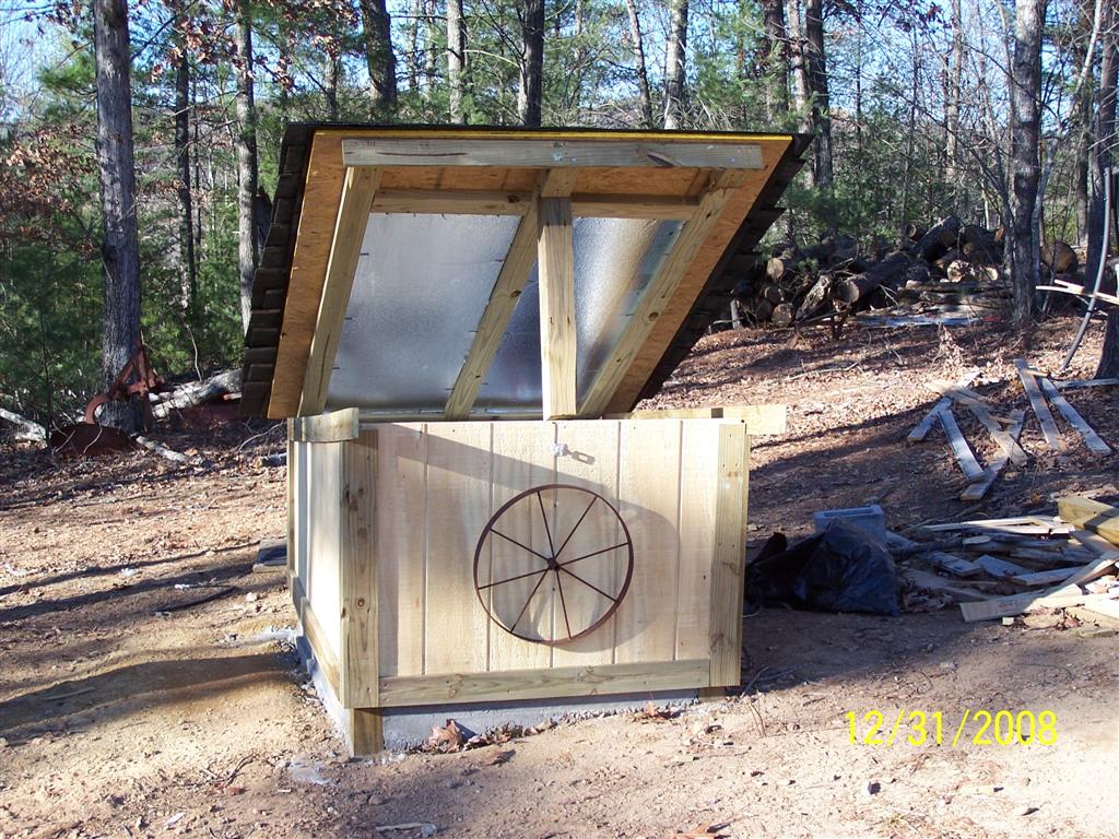

Well house is finished except for paint.:) As soon as we have a warm day I will trim the shingles around the edges of the top. Top is heavy but if I need to remove it I can take the hinges off.
I also plan on making a hinged brace for when the top is raised...so it don't fall on my head when I need to use the receptical:(.

David, your well is gonna feel really cozy in there. Nice job!
One thing I noticed and it immediately jumped out at me. I've had some experience with roofs over OSB and I can tell you that you need a drip edge around the top and sides of the shingles. If possible, even seal between the drip edge and the shingles. Water will get under the edge of the shingles and your OSB will soon start to rot for 4-6" all around the edge of the shingles. You can help by leaving 1" of shingle overlap on the sides, but water will still find its way to the OSB eventually. Drip edge metal edgeing is very cheap and should be installed before the shingles, but I think you can add it successfully afterwards, especially since your roof is so easy to get to.
One thing I noticed and it immediately jumped out at me. I've had some experience with roofs over OSB and I can tell you that you need a drip edge around the top and sides of the shingles. If possible, even seal between the drip edge and the shingles. .
Jim,
You are right, that was an oversight on my part. I thought I had forgot something:eek:. But I should be able to add it with no problem.
Thanks
David

I would think if you put the drip edge it wouldn't really bother it for many years. Mine stood for about 6 years before crumpling when Hurricane Ike hit, although we only suffered 40-50 mph winds here. I guess rain and moisture got to it eventually.
I like your hinged roof idea. Many people forget about the time the well goes out and they have to cut a hole in the roof or find some other method of getting the well out. I just planned on putting fork extensions on my FEL and pick my whole well house up.
