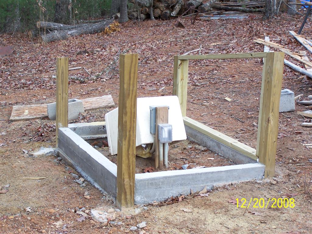

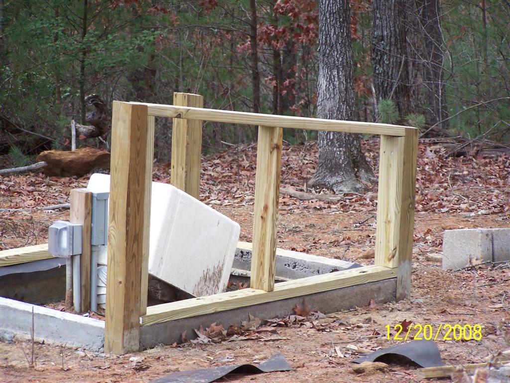

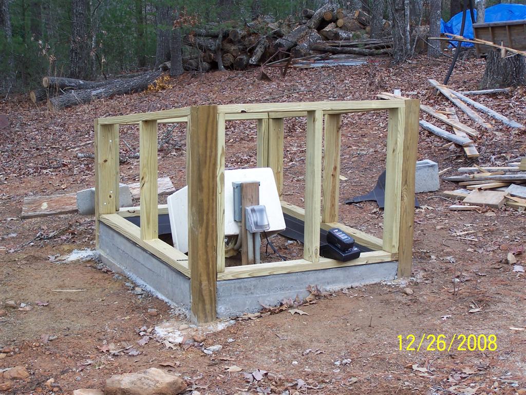

Finally got started on the well house! Hope to have it complete in the next few days.
First pic shows 4x4 in ground and footing poured between. I wanted to make it easy to take apart if needed. The footings between the post are about 6" below grade with rebar driven into the ground and laid in the footing. This way if I need to trench fir the work shop hook-up I can remove the sides and lift the footing out.
I might have went a little overboard on the design:eek:
2nd and 3rd pic shows framing. all held together with screws, all treated wood. My design will allow me to remove any side by removing 4 screws on the inside and some screws on the outside.

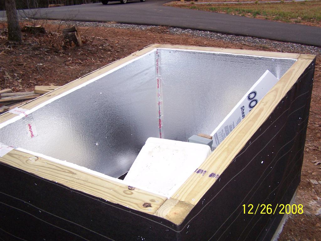

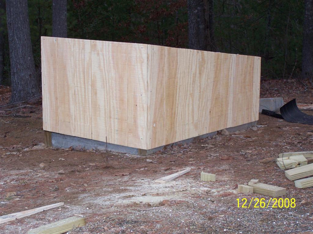

I wraped the frame in felt paper and put two layers of insulation. One layer was cut to fit inside the frame the second layer was to fit inside nad cover the frame.
Second pic shows wood side. The wood is screwed to the post and nailed to the frame. I should be able to remove the screws on the frame inside and the screws on the post and remove the side.
If all goes as planned I should complete the top and trim work tomorrow.

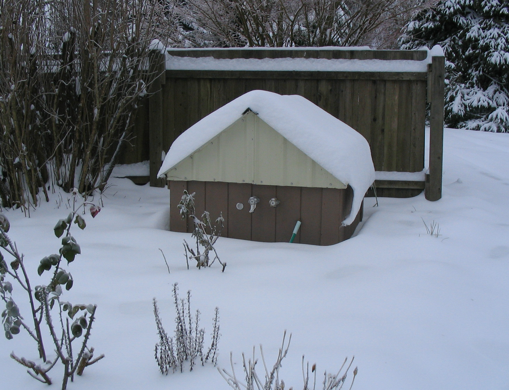

Your project's looking good...Here's a pic of my pump house in the snow...The hose bibs are freeze proof and the clamshell top for the house is insulated...The complete cement/wall/floor foundation goes down in the ground over 4 feet...So far it's kept us with water.
Don

some more lessons learned:
1. top HAS to be removable so they can pull the pump out of the ground every 10 years or so to replace bad pipe sections or the pump itself. some nice I-bolts or hooks bolted into the framing will really make your well guy appreciate you and cut down on the number of hours he is onsite when trouble comes.
2. a dehumidifier goes a long way in the summer keeping things dry. dry equals less rot and less interest by insects. the cold water pipes will condense ANY moisture out of the air in our july summers. even the smallest dehumdifier will run only occasionally once the air inside the pumphouse is dry. a ventilation fan or extra vent holes on the other hand will only make things worse causing more humid air to enter and be condensed by the cold water surfaces. if you do add ventilation, you will need a way to close it off in the winter anyway. the only place i would use ventilation is above the insulation in the roof to keep air moving in the rafter space.
3. a drain in the floor will also be a nice feature. you can run your dehumidifier output into the drain.
4. make the building tall enough so you can put the bladder tank out there by the pump. not only is that a better design, it frees up space in the house. a large bladder tank in an insulated pump house will keep things from freezing from normal use. here in zone 6 (SE kansas/SW missouri) all we need is a 100 watt light bulb on the very coldest nights to keep things from freezing.
5. if you are out in the boonies, add a transfer switch and plug to your wiring inside your well house so you can plug your generator in and power the well when the power goes off during ice storms. keeping the electronics inside keeps your cost down as you don't have to buy weather rated nema enclosures.
6. as for tapping off one leg of the 240, it might be ok for a very small load. you don't want to do it for larger amp draws as this will lower the total amount you can pull from your breaker (ie if one leg pulls 20 amps and the other is only pulling 5, you'll still pop a 15 amp dipole breaker) and might cause low voltage to one leg of your pump motor which will burn it up quickly. not a cheap motor to replace. if you want to minimize wiring, run larger cable from a bigger service breaker (say 50 amps?) into the well house, then put in a load center box and take a 20 amp dipole to the well motor and use the other breakers to run outlets and lights.
done correctly, the well house can become the center of your yard electrical service and can even be the only place you plug your genny in to get water plus some power to the house. you can run sprinkler controls, light controls, pond pumps, outside circuits for power, etc. all from the well house.

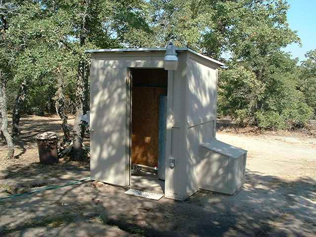

My well driller made a point to tell me that I should leave the wellhead out of the wellhouse if possible for future well servicing. He related that it was often not fun to have to tear down a wellhouse to pull the pump. My well is 386' deep, and that's a lot of pipe.
So, for my wellhouse, I built it so the tank and controller are in the main wellhouse, but there is a little removable "dog house" on the side. That way the service truck can back up over the well to pull the pipe and leave the main wellhouse in place. Here's a picture from 8 years ago when it was first built. Luckily, I have not had to use the "dog house" yet. Actually I put anchor bolts into the foundation so if the whole thing has to be removed, all I have to do is unbolt it and lift it off.

The tallest point on my well house is 3 + foot. The top will be hinged in the back so I can fold it over with the top on the ground. Since my bladder tank is in the basement I made the house as small as possible with enough room to get inside and work.
If we ever need to pull the pump the truck should be able to back over the house without removing the sides. The design took this into account. At my old house we had to replace the pump after 20 years. That well was bored and was a little taller than my current well house.
