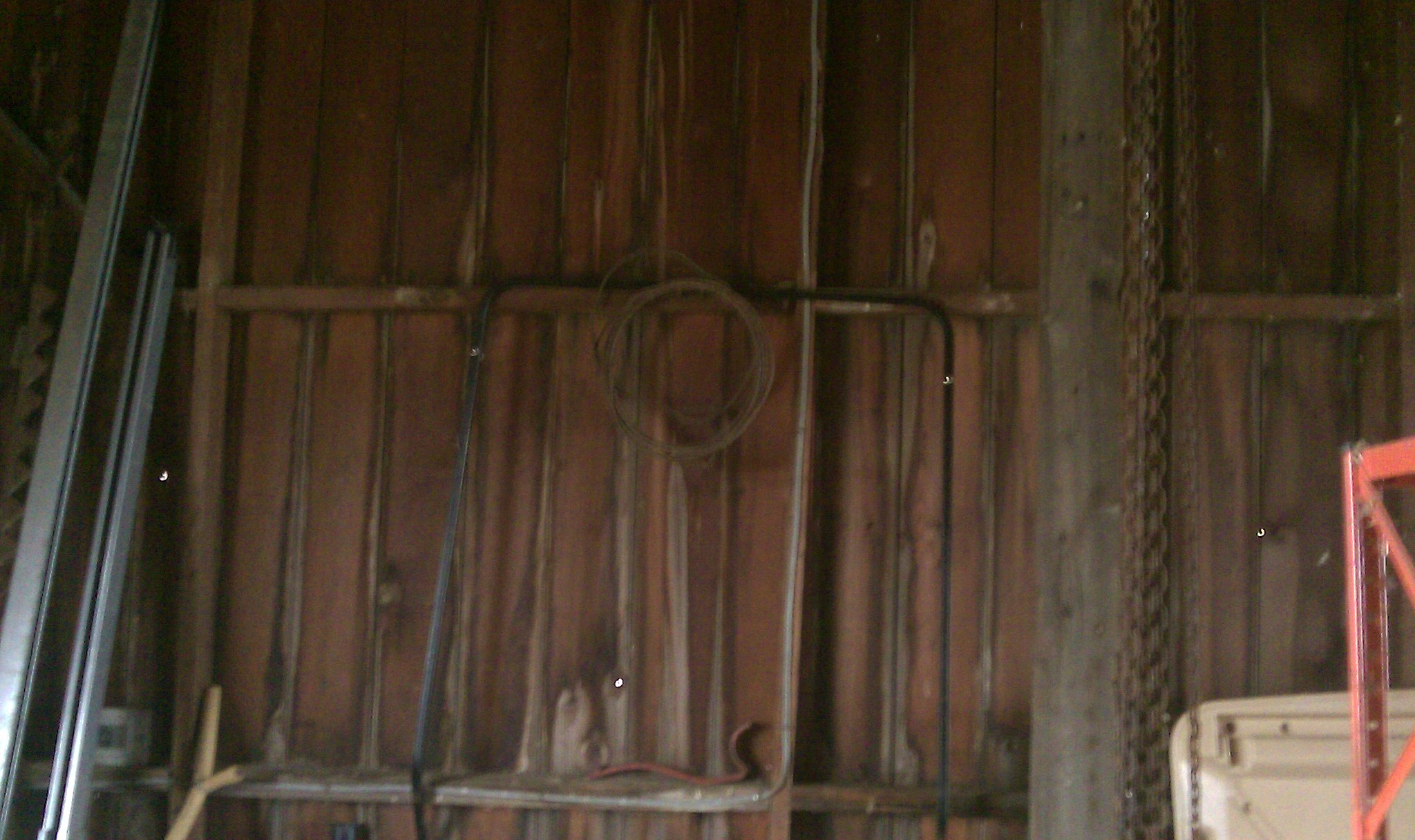

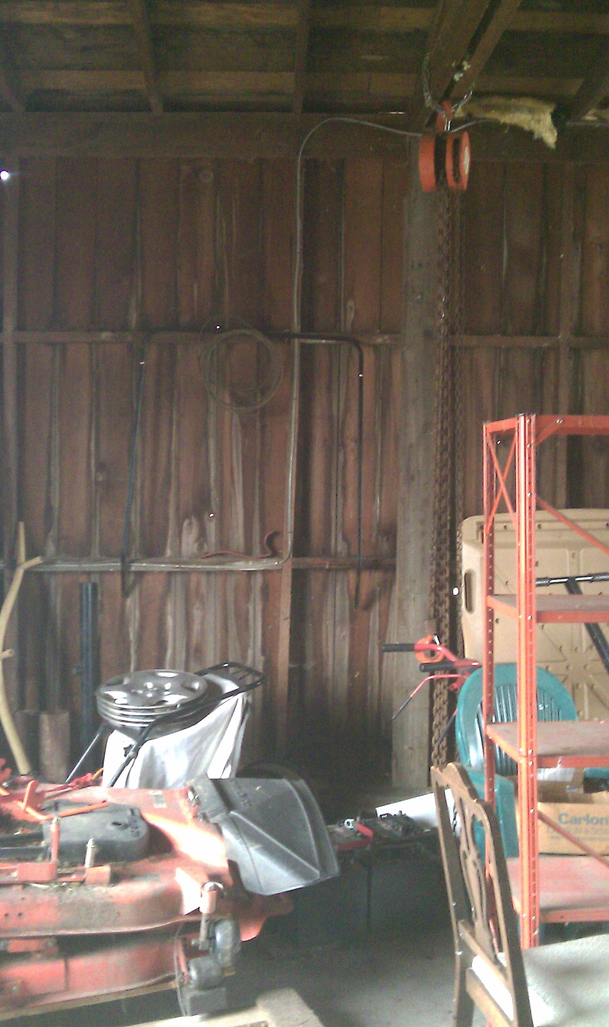

I have noticed the air infiltration. On the old (long) wall there are 30+ knotholes that I have found. No water leaks on any walls that I have found though.
How well would it work to wrap the inside of the studs and posts with Tyvec (or similar) after filling all the knotholes/cracks I can find with foam and/or calk?
Covering foam wont be an issue as I plan to put plywood over the walls at ~8' and put something else (sheetrock? metal roofing?) over that.
IMO when the ends went on, they should have covered the walls with Tyvec.

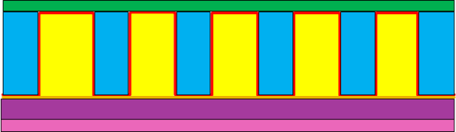

Here is a picture of what I am thinking of doing now:
From the top down (outside in):
Green with a black border is the outside T1-11
Blue with a black border is studs/posts
Red is Tyvec
Yellow is blown in cellulose
Orange is plastic (needed with foam?).
Purple with a black border is foam insulation
Pink with a black border is the inside wall covering (plywood for the first 8 feet, then possibly sheetrock or metal).
Does that make sense? Any suggestions on changes? I suppose I could skip the foam and just fill with blown in Cellouse, but then I would need to stud out the long wall...

As Kenny mentioned, Tyvek breathes, which makes it an AIR barrier but NOT a VAPOR barrier. Plastic is BOTH, because NOTHING passes it (unless you make LOTS of holes in it :) )
Here's the main thing to watch out for - when you heat a space, the moisture in it wants to leave - water vapor is so fine it will go thru pretty much ANYTHING that isn't non-permeable. So the moisture in the room tries to exit thru anywhere it can.
Rule of thumb for occupied spaces is that the vapor barrier goes toward the HEATED side, in order to prevent moisture in the wall or ceiling - so in Florida, a vapor barrier would go on the OUTSIDE of the wall but in your area, you want it on the INSIDE.
MOST IMPORTANT - you NEVER want more than ONE vapor barrier, because in the REAL world, moisture WILL get into the wall at times - so if you accidentally end up with something that works as a vapor barrier on BOTH sides of a wall, that pesky moisture that makes it into the wall (one way or another) will get TRAPPED inside and will cause rot, mold and mayhem.
By limiting actual VAPOR barriers to ONE side, the wall can eventually dry out inside, which is what you want.
For normal house materials, even a good coat of latex paint will act as a vapor barrier, as will "trailer trash" plasticized paneling. Paper or foil as used on fiberglass batts is also a vapor barrier, especially if it's installed according to directions (overlap the backing on studs for a continual surface) - Foil on the foam insulation is the vapor barrier, so if you use that and cover the SEAMS with foil tape, that's your vapor barrier.
On the "vintage" side, tar paper on the OUTSIDE, if overlapped like shingles but NOT sealed, works as an AIR barrier but allows breathing - so it would work similarly to Tyvek.
Point being, if you're aware of what DOES act as a VAPOR barrier, just make sure you only use those materials at the INSIDE of your walls and use BREATHABLE stuff elsewhere, such as Tyvek for an AIR barrier on the outside.
I purposely didn't try to tell you exact materials to use, only an idea of which ones work where and why. I've seen enough of your posts to know that's probably more than you need :thumbsup: ... Steve
