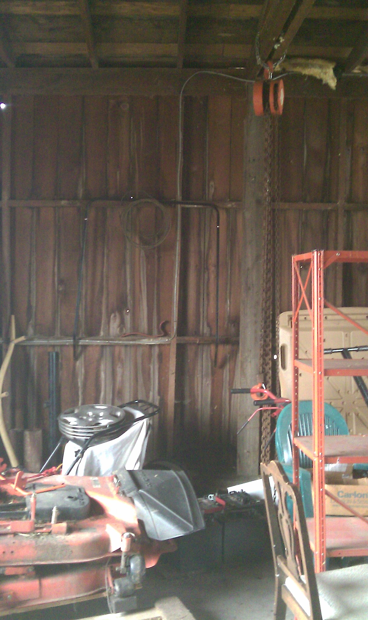

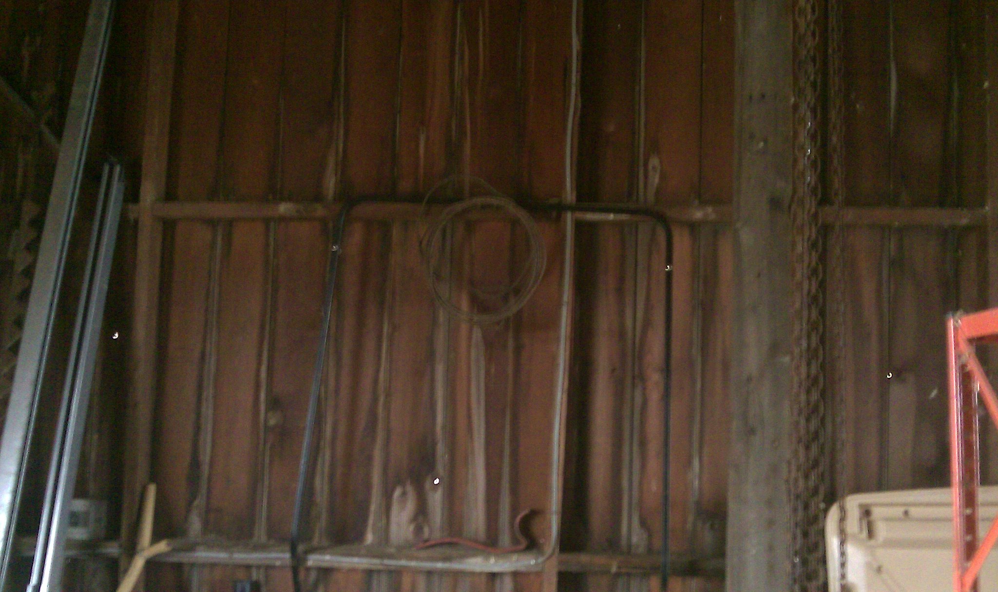

Here is my thought after looking over the shop today:
Long wall:
  • Calk or foam any major holes
  • Wrap the inside of the wall (over and around each beam) as close as possible with Tyvec
  • Put 2x4s vertically on the wall every 24". Probably flat (4" side against the wall), I might put 2x6s over the existing uprights to help tie things together better.
  • Cover with heavy plastic
  • Top with horizontal sheets of plywood (blowing in cellulose behind each sheet as it goes up)
  • If the CFO approves funding, I would put the foam on top of the 2x4s instead of plastic, then blow in cellulose behind it
Long wall pictures:
The "grid" of 2x4s is ~3' tall by 4' wide and yes, the grey wire on the wall is going away (just need some time to pull it out).
Short wall:
  • Calk the few holes (its pretty tight now but there are a couple of spots that need attention)
  • Possibly wrap with Tyvec (not sure it will gain us anything, but it might be worth doing)
  • Top with vertical plywood sheets
  • Blow in cellulose after the 8' of sheets is up as there is a "header" at ~10' up
That should give me R19 on the long wall and R15 on the end wall. If I can get the foam insulation it would go up to R34 on the side and R30 on the ends.
Aaron Z
   / Insulating a wood sided shop? #24
I think your plan is good except that the foam on the walls is probably not cost effective. I would put that money into ceiling insulation.
