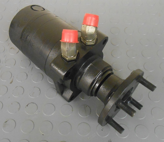

/ Integrated ZTR transaxles #11
The next step up would be individual hydraulic motors: Surplus Center
Here is one from a TORO traction unit: #2 – Used Toro Hydraulic Wheel Motor – 95-8694 – Cutter Equipment Company Leaders in Pre-owned Turf Equipment –

#13
Indeed... but I'm trying to avoid the associated cost, parsitic power loss, leak points, parts count, noise... you get the picture.
I'm fairly certain I can keep the working weight within 2,200lbs... but the added 300lb capacity of the Parkers would go a long way toward loader attachment capacity.
/ Integrated ZTR transaxles #14
You could add a axel shaft and only drive it with the hydraulic motor. You'd then have unlimited weight range with the only short coming being the power to move it.
