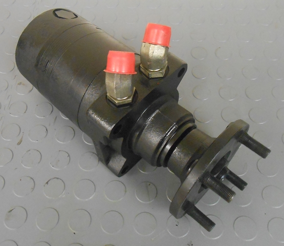

The next step up would be individual hydraulic motors: Surplus Center
Here is one from a TORO traction unit: #2 – Used Toro Hydraulic Wheel Motor – 95-8694 – Cutter Equipment Company Leaders in Pre-owned Turf Equipment –
