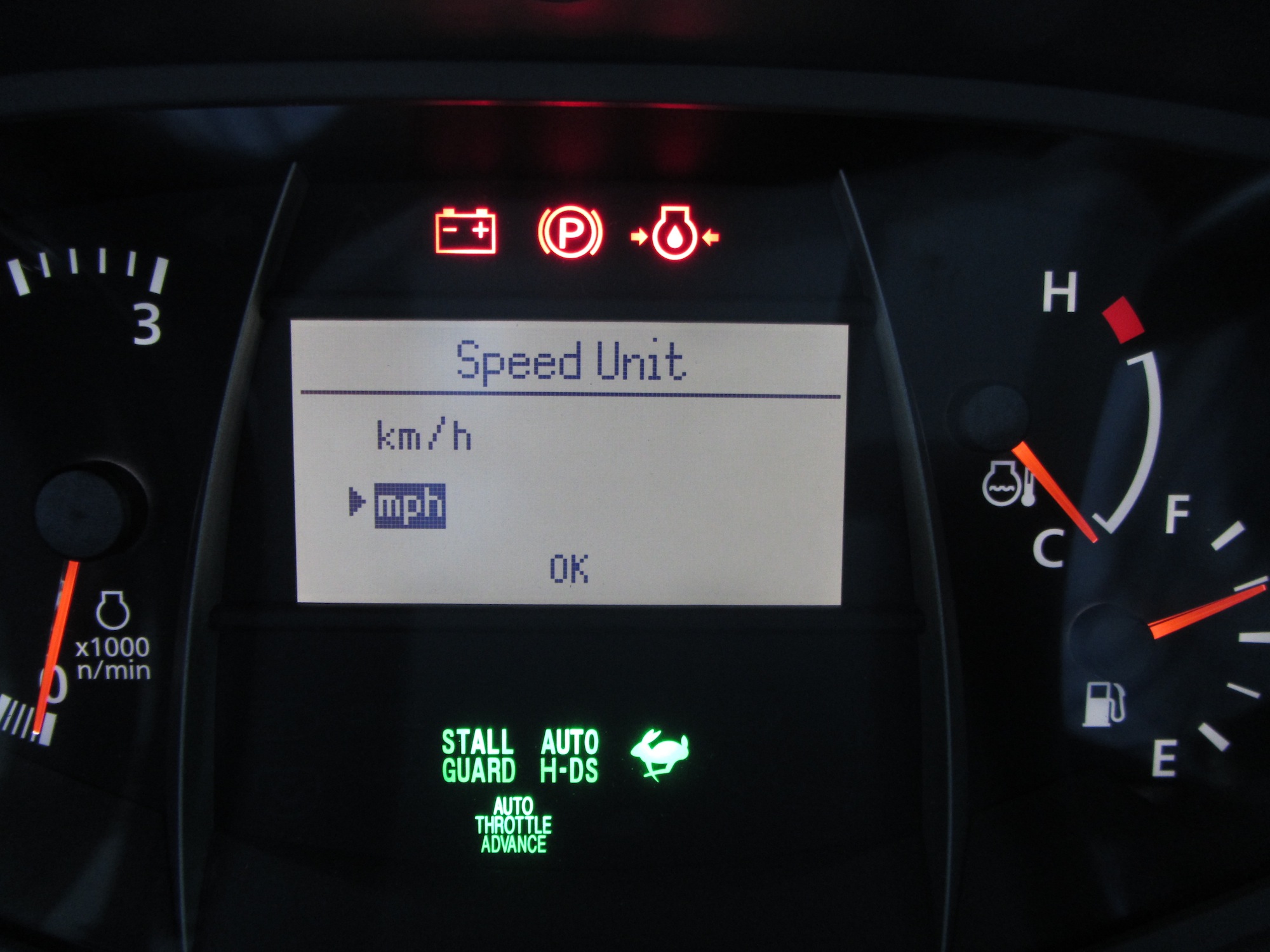

I played around with it some more this afternoon, and it's definitely not in any of the normal menus or settings.
The reason why it's not documented anywhere in the user manual is because the change needs to be done from the diagnostics / service menu. To access the service manual, you need hold the Display Mode button down and then turn the tractor on (but you don't need to start it though) while holding the button in. Once the service menu appears, scroll to option "J" and select it (by holding down the Display Mode button); from there you can either select kph or mph (once selected - hold button and it "OK" will appear at the bottom of the screen.)
I had to do a bit of thinking to figure this out! :)

What are the other selections that are available in the service menu? Maybe one where I can set my clock??? :licking:

I know this is an old thread, but maybe someone can educate me. I have no idea what R4 means when talking about tires. I know what industrial, turf, and ag tires are. I just bought a new L4060 and I had my dealer take the industrial tires off and put on ag tires. How can I find the ratio for ag tires? I toggled through the display for 20 minutes tonight and could not find any way to change from metric to SAE. I will go back out to the barn later and try to access the service menu mentioned in this thread.
Edit to add: I found the service menu, and mine had the KPH/MPH setting under the J menu just like you said. But I still have no idea what tire ratio to use.
