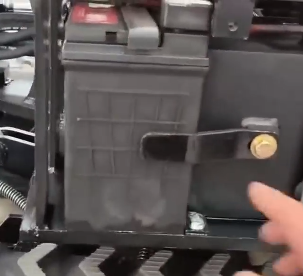

It's a bit shocking they'd put the battery in such an inaccessible location.

ETA: Yeah it is surprising how little thought seems to be put into future maintenance. You can not directly get at the oil filler cap or oil filter. I am planning to use an oil pump in order to refill when that time comes. The oil filter I will need to remove the coolant overflow fill bottle and mounting bracket. That is another thing you can not access is the radiator cap. At least the oil drain plug is accessible at the bottom of the engine and machine deck.
Yeah, Kubotas and Yanmars are excellent engines.
I suspect your machine was designed for another engine. There has been a lot of pressure on the makers to use CARB-certified engines, so shoe-horning a Kub into your machine is likely what they did.
Maybe some sort of access tray needs to be made so the engine can slide out a bit for maintenance. Kinda like generators on motorhomes.

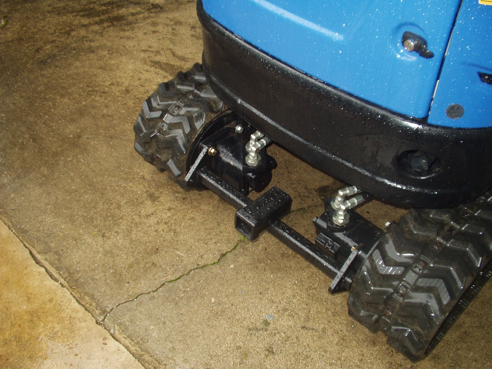

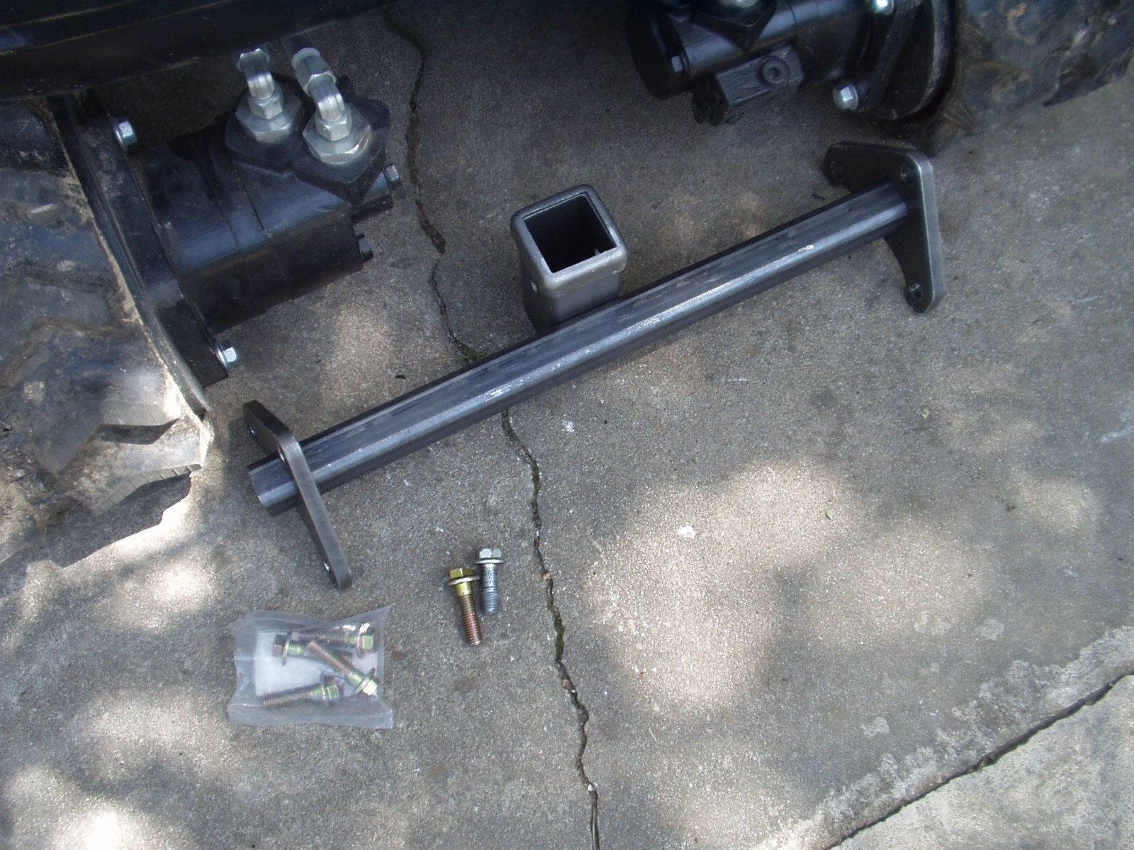

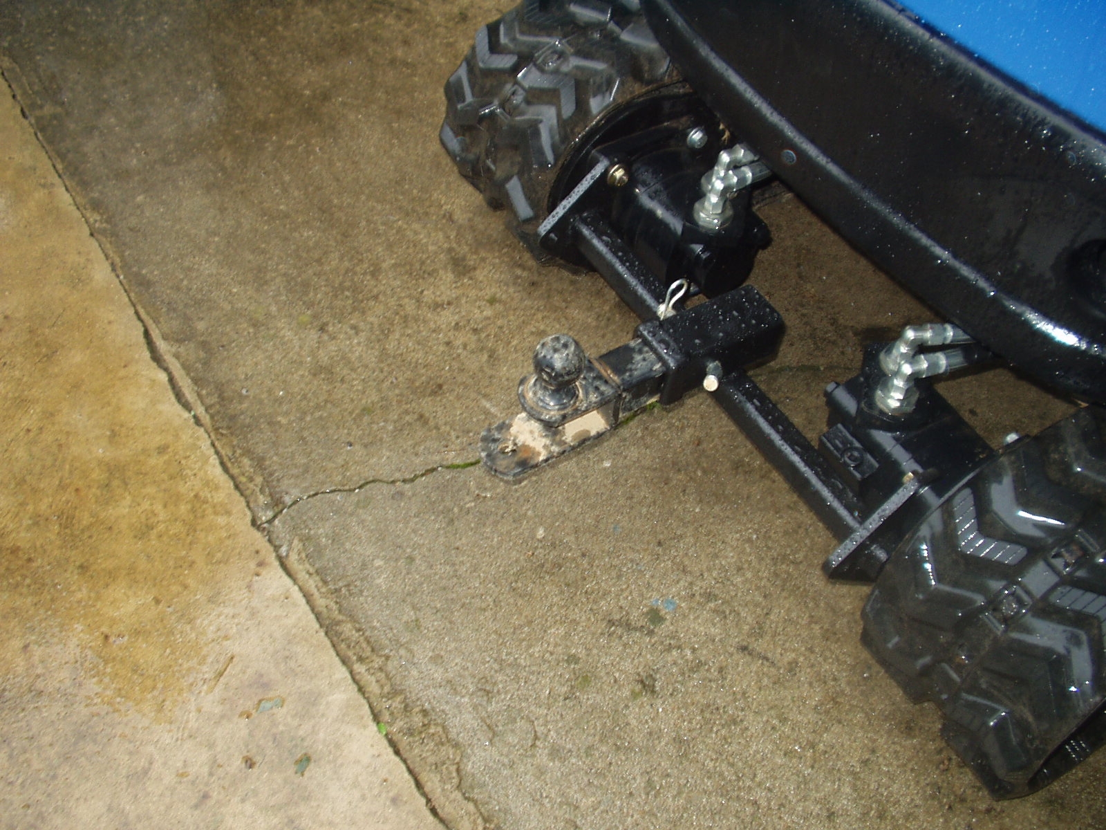

Went ahead and built the drive motor brace. It mostly came out good once I got all the parts I needed to build it. One error I made though, when welding on the trailer receiver hitch, was I allowed myself to get hurried by an approaching rain storm. I had spot welded in place the tube but one side was not good enough and as I welded around from the other side the spot weld broke and the tube lifted a small bit. This meant the tube is not perfectly level to the cross bar. You can not really notice it but it bugs me.

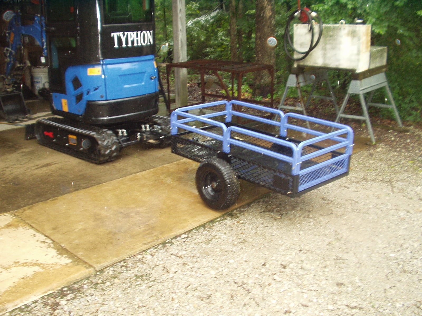

Looks good from here - and you have a cart to load rocks and stuff! I got the same plate and found a bolt on hitch plate from off TEMU 45$ for two so used on on the mini.
Have a HF receiver hitch platform 24x48 to carry spare buckets etc, if needed too.

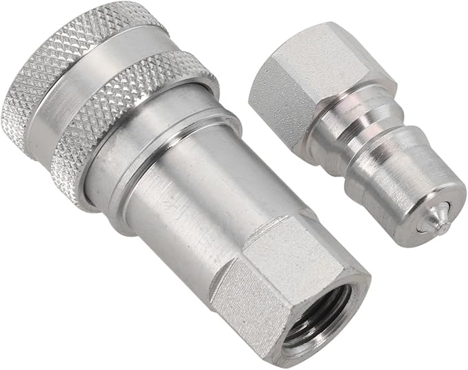

Anybody have a source for an adapter from the Thumbs auxiliary flow selector to a Hydraulic quick connector? The fitting on the selector is designed to connect to a 14mm DIN light hose. I find many female 14mm QC's but they are not DIN and lack the o-ring seal.

The selector already directly hooks to the hoses that came with an auger I got but having a quick connect would allow for containing hydraulic fluid when swapping attachments.
