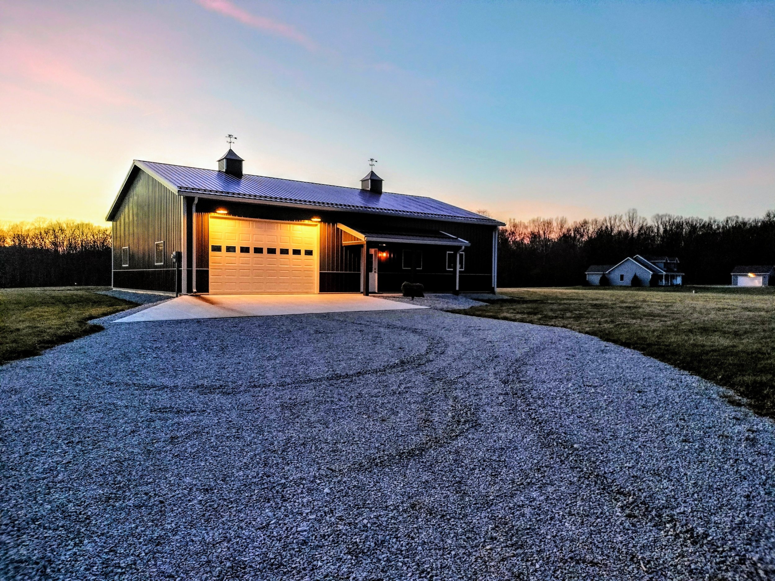

I ran Cat6 Direct Burial from the house to the barn for poe security camera's and home network. I plan on installing a long range wifi extender with an external antenna off the roof where wifi can reach all areas of the property.
   / Intercom to shop #25
I ran ethernet in conduit out to my shop….failed in less than 2 years. Even in conduit. My wifi extender solved all the issues.

No clue what happened. I needed it to run my plasma table. And it was in conduit. I was going to try repulling it, but a friend showed me his wireless setup, and i was impressed. Super easy install, and its been trouble free for over 5 years now.
it a radiolabs shop extender.
   / Intercom to shop #28
My metal shop building has almost no radio or cell reception in it. Only near a window, but the in the direction of the cell signal there are no windows. When we gave up our land line phone there was no way to get a hold of me in the shop.
We recently installed a wifi 6 mesh system in the house. The signal was good outside the shop but nonexistent inside. I solved this by installing a small window in the attic on the end facing the house, a small shelf inside the window and an electrical outlet completed the modifications. A mesh unit on the shelf and I now have internet and cell service (over wifi) in the shop.

What I liked about running a CAT6 cable was it's cheap, no electronics involved in the transmission point-to-point and I can get 1G data rate. It's the same as any Ethernet wall jack in the house.
   / Intercom to shop #31
Fiber is so cheap you can just run it to your shop, get a network switch and access point and be set
   / Intercom to shop #32
Did you find out why it failed? Normally direct burial will last a long time unless it's damaged somehow.
I buried a run of plain old RG-6 coax from the house to my shop when I built it in '83 so I could watch SAT TV if I wanted to. Never used it until a couple of years ago when I wanted to have internet access in the shop. was going to run direct burial CAT6 cable, in fact I bought it, but remembered the coax. I tested it, and it showed good, so I bought a pair of transceivers that run ethernet over coax, and have been using it ever since.

I just priced 300.ft of fiber and 2 switches. About $300. Less if you only need one switch or go into just an AP
