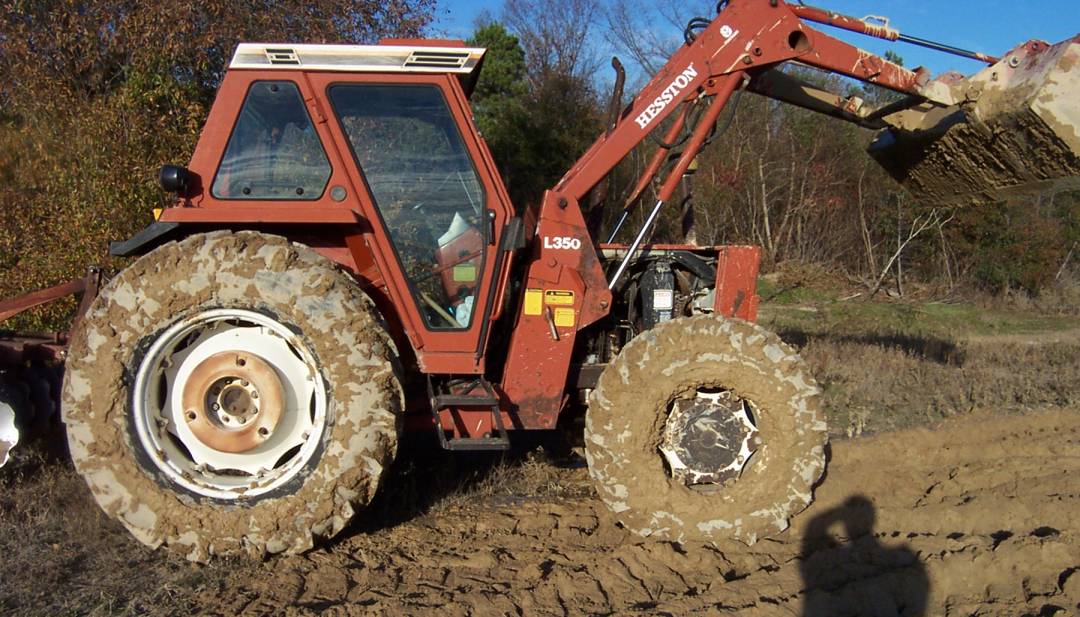

Included is a picture of it. This was last year when I was digging and clearing some land. It was my grandpa's tractor and since then, we've found the side and front covers and fixed them so they stay attached, fixed the broken hand and foot throttles and diff lock linkage, fixed the Air Conditioner, cleaned and degreased the engine compartment, fixed leaking cylinders, changed the filters, and the list goes on. It is an early 1980s model and has 2700 hours on it (original clutch) and has spent most of its life sitting unused in the weather. It is older than me (born in 84) and some of my fondest memories are me riding on my grandpa's lap as he operated the tractor, so it is more than a tool to me....though it is a necessity for caring for the 100 acres of his land and cattle he left behind when he passed away in 05.
