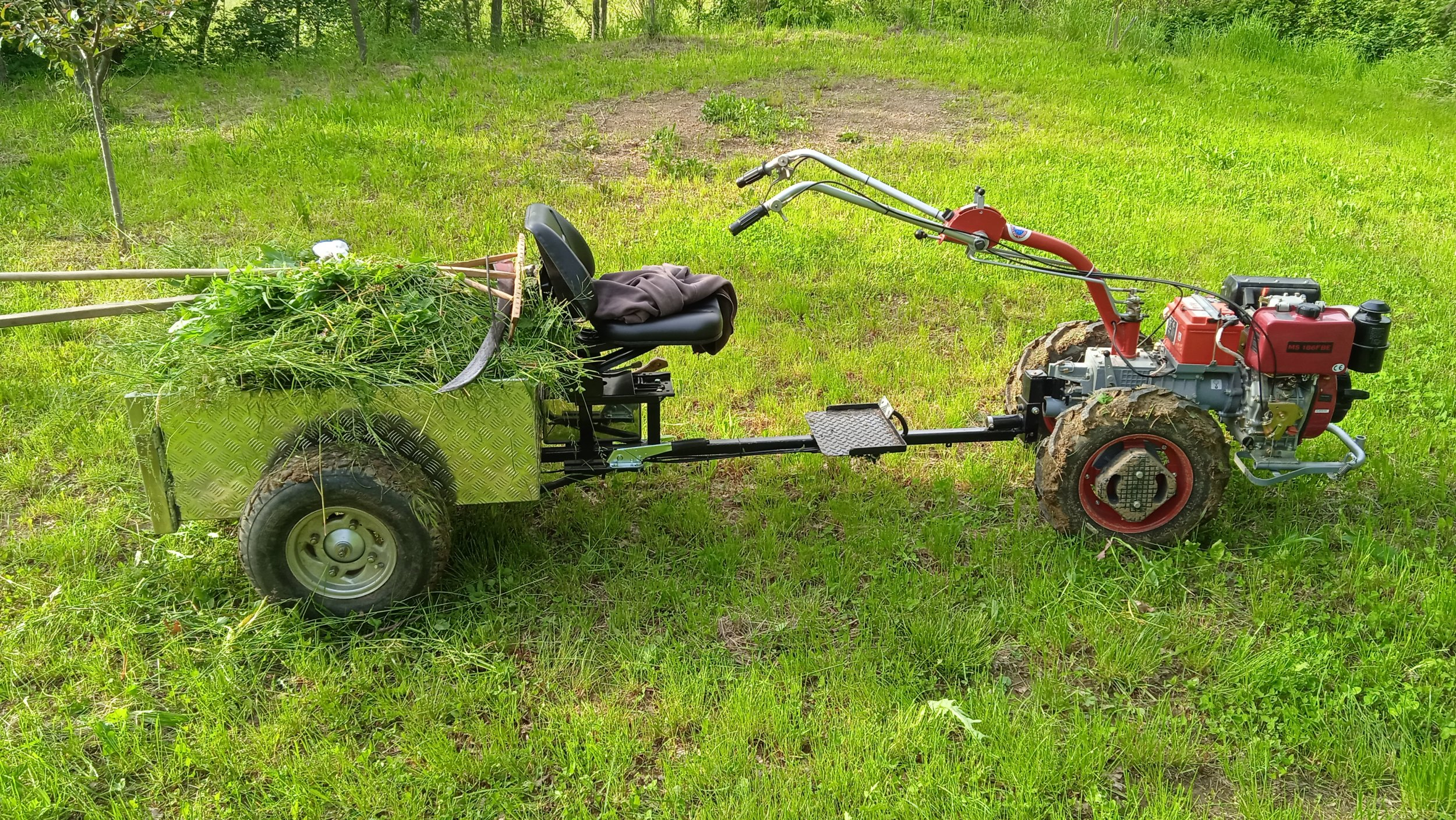

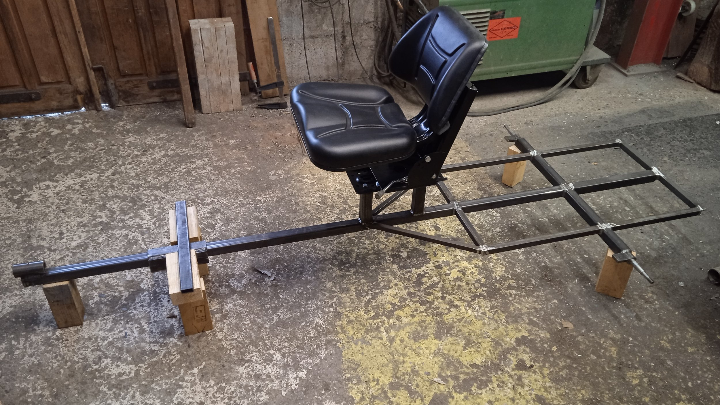

I just finished my trailer for the Ukrainian motor sich mb9. Though I did not bother with driving rear wheels with PTO, since the tractor weights 300 kg, and has no problem driving me and 200 kg load on the trailer.

Nice! I currently have a mowing sulky that attaches to the wheels of my BCS, forward of which I usually have a mower mounted. Then behind the sulky I often attach a cart. It's quite a little train. There are 8 wheels in all when they are all connected. I'll try to remember to get a pic when it is all set up next time.
