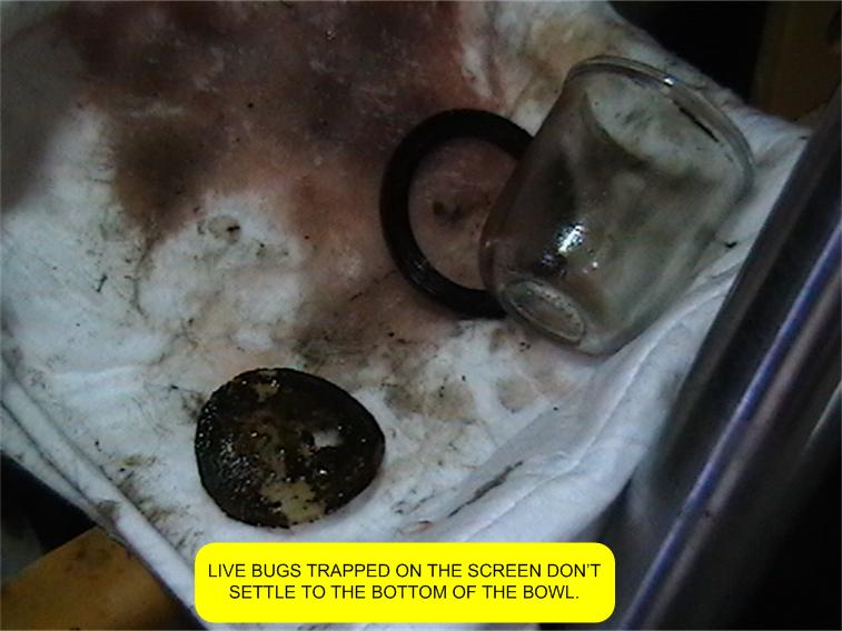

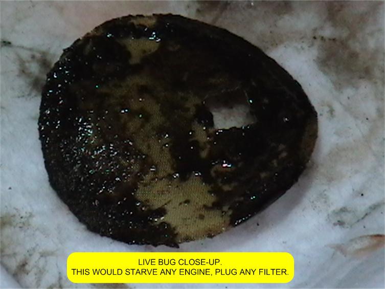

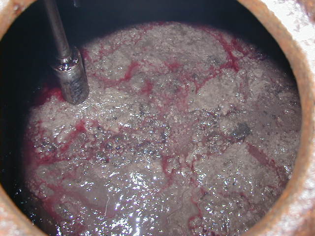

I have personally witnessed diesel bugs bring a 14,000 HP diesel engine to it's knees, and subsequently $125,000 in fuel system repairs. They are very corrosive and can destroy injectors and injector pump plungers and barrels, not to mention steel fuel lines. I use this test kit periodically on my storage tank. https://www.amazon.com/Biobor-HUMBU...eywords=humbug+test+kit&qid=1572051131&sr=8-1 I think the first thing to do is determine if you do have a dose of the "bug" because that will direct the course of action.
Many articles have been written on this topic.
Microbial contamination of diesel fuel - Wikipedia
Here is one of my personal experiences with the slimy sludgy critters (the pink stuff is fuel).
/ intermittent fuel problem #4
WOW BOB.. I've NEVER seen a tank THAT BAD.!!

There is another less expensive possibility, and that is there is something in the bottom of the tank that gets sucked onto the line line and block it until the sucction stops(engine died) then floats clear and you can restart and it will run perfectly until the obstruction gets sucked uver the fuel line again.
Take wagtails advice and put an inspection camera into the tank so you know one way or the other.

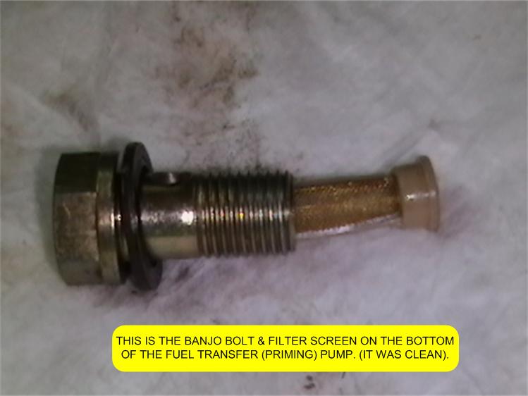

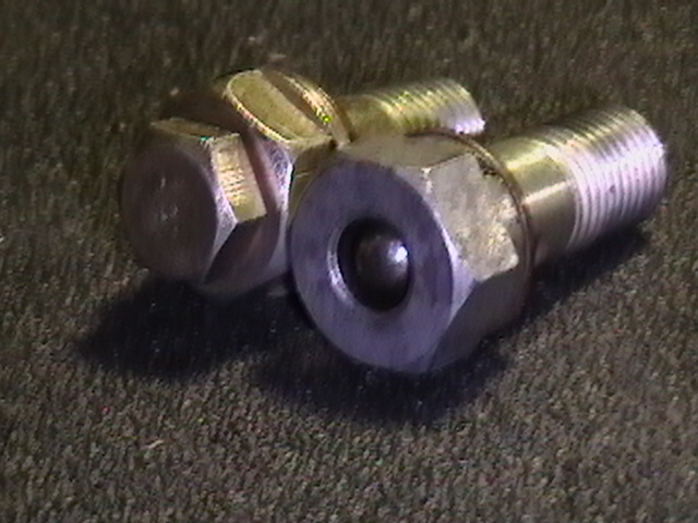

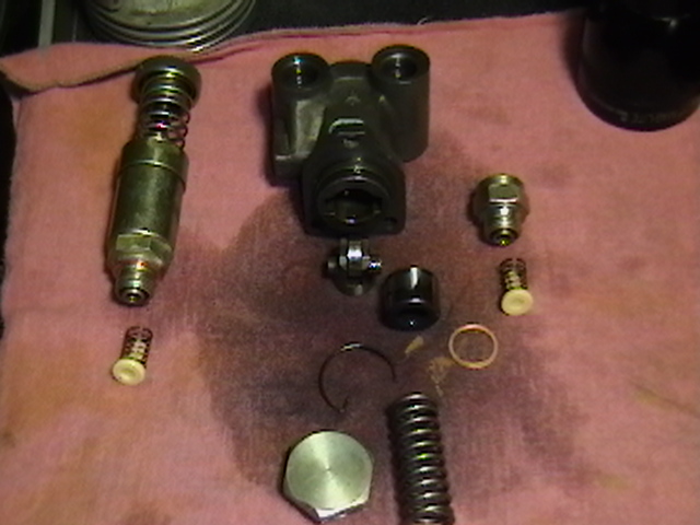

Don't know if I mentioned it before, but I too was stuck in the woods with bug issues once. That prompted me to install a fuel pressure gauge connected to my alarm system. There is a ball-check pressure regulating valve on the injection pump (every diesel engine in the world has some such valve). It maintains a nominal 22 psig fuel pressure in the injection pump fuel cavity and assures the plungers have adequate fuel under all conditions. Some are adjustable, others look like a ball is swaged into the banjo fitting. Corrosion from bugs has been known to cause the spring to fail and to cause pitting of the ball seat, lowering or shutting off the fuel pressure. I personally had to replace the lift pump because the valve seats were so badly pitted that it barely pumped fuel.

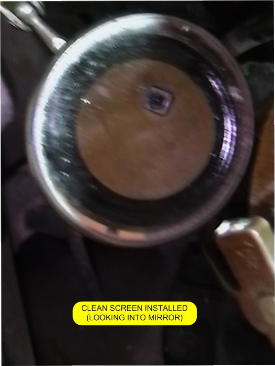

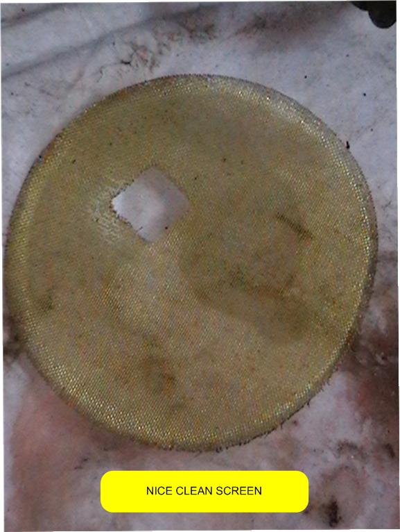

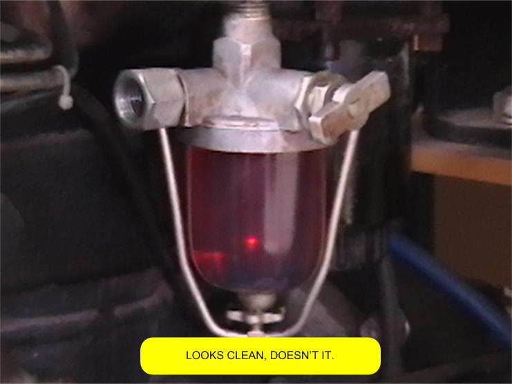

As a side note, these machines do not have a primary fuel filter per se, just the screen in the sediment bowl so this must be maintained intact and periodically inspected because they can catch some bugs.

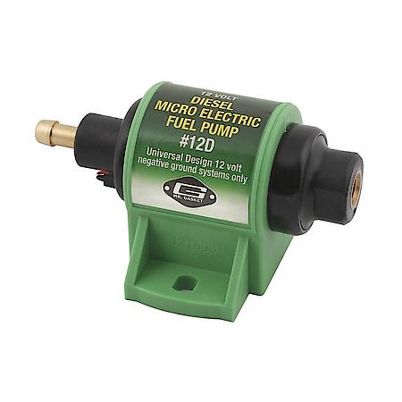

As an over-kill precaution against any further fuel related interruptions to my seat time I installed an electric lift pump.
Note: My Mitsubishi excavator and Yanmar powered skid steer both use an electric lift pump instead of a mechanical one.
