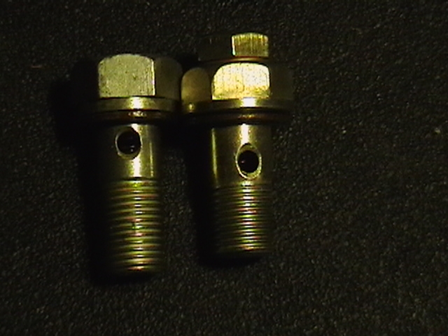

Just to clarify.
There is a pressure relief valve in the IP that keeps incoming fuel to about 40 to 55 PSI?
This valve was failing and dumping pressure in the 15# range until you replaced it?
In the first video, as the engine rev'ed up, was the IP actually drawing fuel faster than the lift pump could provide it.
IP pumps seem to be simple yet finicky.

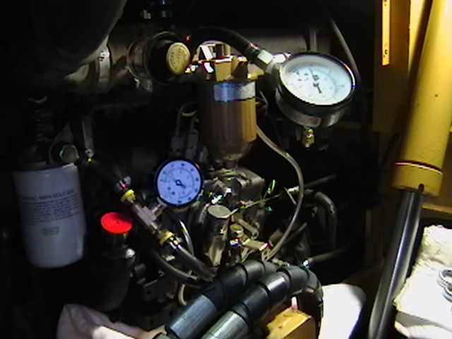

I am curious as to where you tapped into the system to attach the gauges in the two videos.
Thanks for the post!

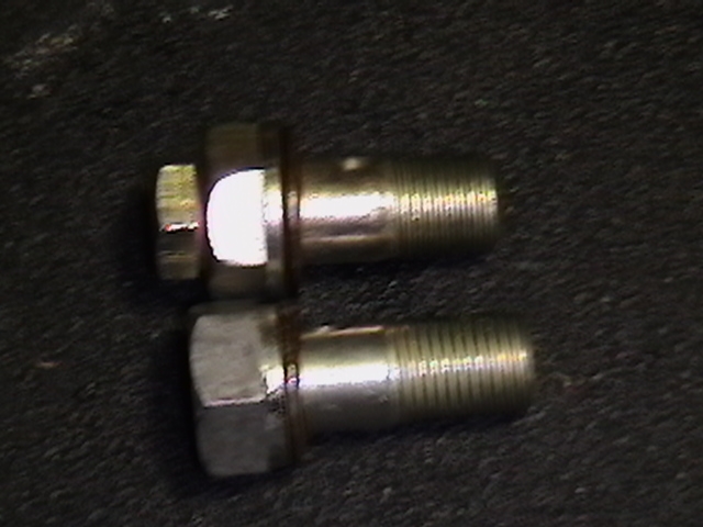

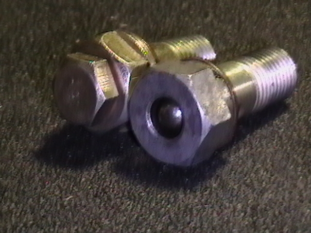

There are two types of relief/ball-check valves used. They are nominally set around 10 psig. The one with the hex plug is "adjustable" by stretching the spring. These are located on the outlet side of the injection pump fuel cavity. The main purpose is to maintain a positive aerated free flooded fuel supply to the barrel and plunger assemblies, while preventing any flow back from the fuel return line.

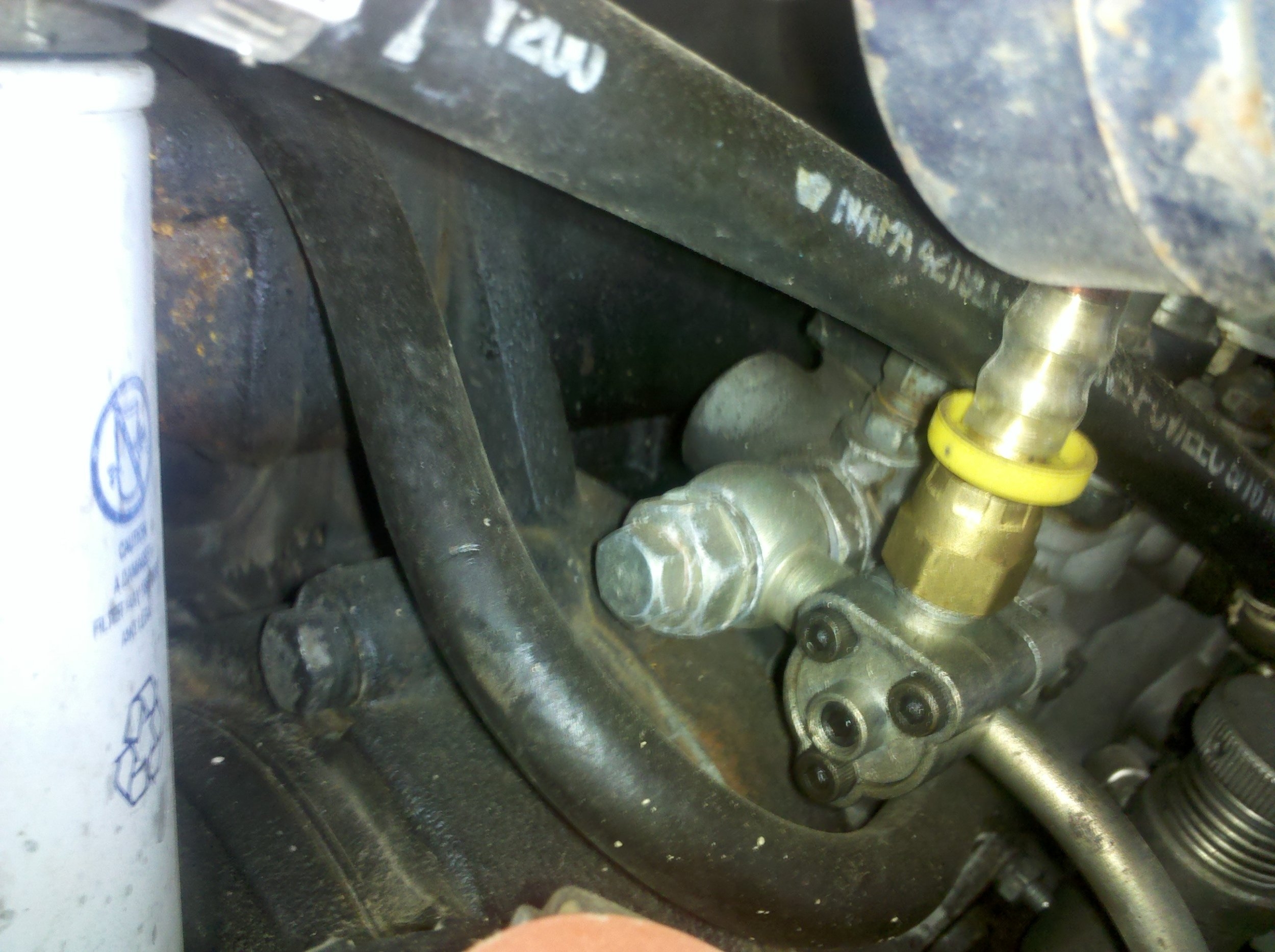

Pretty poor pic, but this is the temporary gauge installation. For the vacuum gauge - between the sediment bowl and lift pump suction. For the pressure gauge - between the lift pump discharge and the injection pump (I used a refrigeration line tap on the metal tubing).
