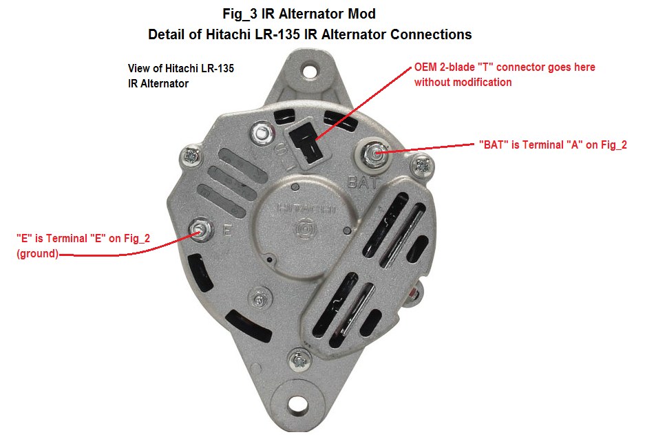

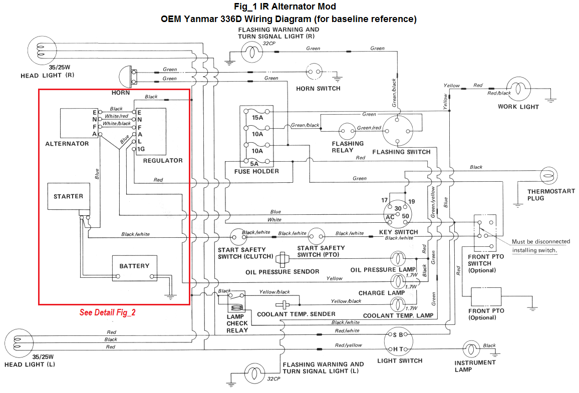

  • The 336D shares the 35 Amp alternator and external mechanical voltage regulator found in several '60s and '70s Datsun/Nissan cars/small pickups.
  • Datsun/Nissan later went to an internally regulated (IR) alternator of identical capacity, yielding simplified wiring and more reliable operation (the IR alternator uses a solid-state regulator system)
  • The Datsun 1200 Club Forum has popularized and fully documented the upgrade from the older alternator+mechanical regulator system to the more modern IR Alternator system
  • This post builds on that information and documents my implementation on the Yanmar 336D application
Cost and Fitment
  • As of this date the price of the Hitachi LR-135 IR Alternator I used is $47.79 including the core charge but not including shipping from RockAuto (note too that 5% off codes for RockAuto are widely available via internet search)
  • That price is competitive if not better than many of the Yanmar voltage regulator only replacements or alternator only replacements, while serving to replace both the alternator and the voltage regulator
  • That's for a Hitachi alternator remanufactured by AC Delco and shipped in AC Delco packaging with 24-month warranty
  • The alternator is complete with pulley and for me was an exact physical match bolt-on with zero modification required to any of my Yanmar mounting brackets / adjuster; the threaded adjuster-bolt hole in the alternator casting was exactly as OEM Yanmar
  • See this link for the RockAuto detail page including dimensional data to verify mounting fitment for your situation RockAuto ACDELCO 3341571 = Hitachi LR-135
  • In addition to the alternator, the mod requires a few inches of wire and 4 standard crimp-on male 1/4" blade connectors (to DIY two 'jumpers' installed at the OEM Yanmar 6-blade voltage regulator harness connector upon removal of the OEM regulator)
  • Yes, the OEM Yanmar 336D 'charging warning lamp' will continue to function exactly as original.

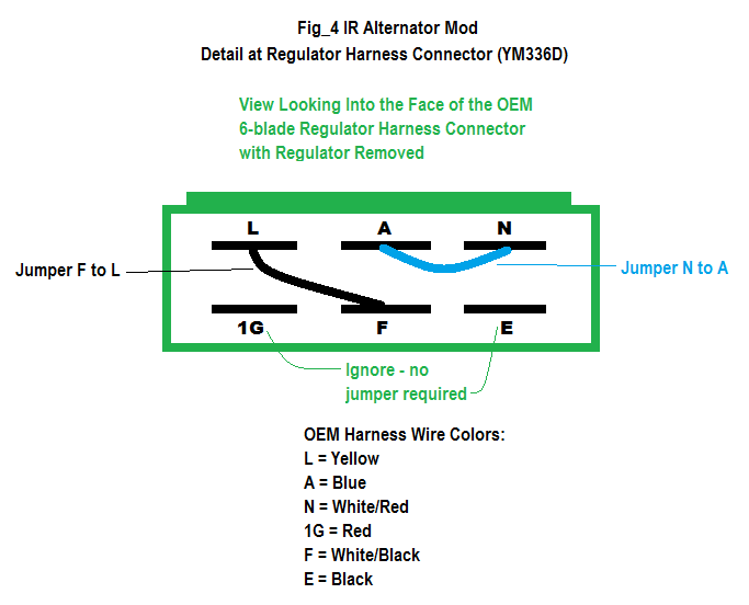

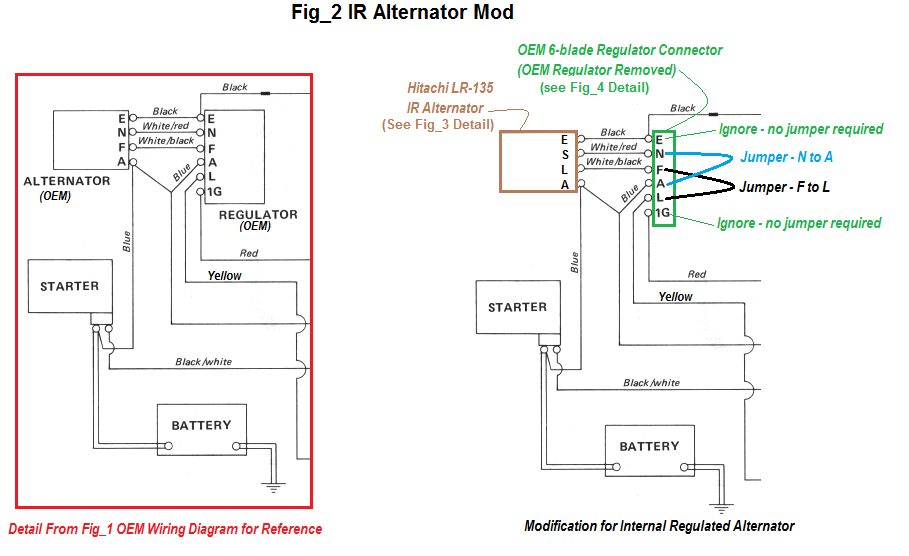

See and study the attached Figures 1 through 4 .... post-up if you've any questions.

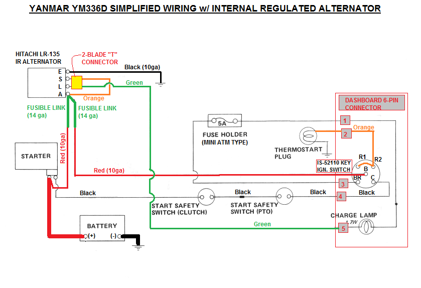

For me, the above mod was prompted by an 'iffy' OEM voltage regulator. I also was dealing with very 'crispy' wiring insulation throughout my 336D.
I'm an inveterate long-time car and motorcycle modifier with fairly decent experience with electrical systems. I like 'em KISS whenever possible.
In 30 years of ownership/use of my 336D I've never worked in the dark, never used any of the lights, never touched the horn.
So, after 'proving' the IR mod described above with my OEM harness and jumpers I undertook a total electrical system overhaul on my tractor, including installation of mechanical gauges for water temp and oil pressure (eliminating the electrical sending units and 'idiot lights' for those functions while keeping the 'charge lamp' warning light).
It's amazing how simple and clean the wiring can be on a tractor when all it needs to do is start the engine and charge the battery (while retaining all the original starting-safety interlocks).
Compare this to Figure 1 (OEM wiring) in the post above:

The "Going Overboard" schematic in post 2 is a complete custom replacement DIY-from-scratch harness which as shown eliminates all of the OEM lighting, electric gauges and horn.
For your 'typical' situation I suggest you please ignore that and after confirming that your 3110D wiring matches my 336D, follow the instructions in post 1 (including jumpers).
Please understand I'm trying to be very careful, and asking readers to do the same, to avoid pitfalls for everyone. Though I suspect many Yanmars are similar I do not know that the wiring colors or pin-assignments, particularly at the voltage regulator harness connector, are all identical.
Is the T connector already being used on the OEM alternator, or will I have to make just a 2 wire connector there ?
Assuming that your 3110D matches my 336D, you'll find your alternator harness already has a "T" connector with the "S" and "L" wires correctly situated - just plug it into the replacement IR alternator.

Ignore post 2 completely (sorry now I posted that in this thread).
Use post 1 and the four figures included there.

.... It appears to have 2 white wires going to it. .....
Note "White/Red" means white with a red stripe; "White/Black" means white with a black stripe; etc
Tip: Quite often our old Yanmar wires are sun-bleached so the original colors are no longer apparent where exposed at the connectors.
Don't be mislead ....
If you'll peel-back the tape wrapping on the harness a few inches you'll usually find the 'protected' wire insulation proudly displaying its original glorious colors, helpful to confirm things against wiring diagrams ;) :thumbsup:
You can of course use a simple continuity tester / VOM to confirm pin-to-pin relationships between the alternator-end and the voltage regulator connector-end.
Incorrect wiring risks damage to your new alternator - disconnect the cables at your battery before starting the project, take your time, check everything thrice, then only when confident you've got it all right reconnect your battery and 'take her for a spin'.

Based on a very good idea kenmac suggested while we were talking on the phone yesterday, here's how to use your abandoned VR plug to make the jumpers required for the IR Alternator conversion.
Bob's-yer-Uncle, a sanitary, secure, and easy way to accomplish the required jumpers ;)
Just plug this into the harness where your VR was plugged-in and bolt-up the new IR Alternator.
