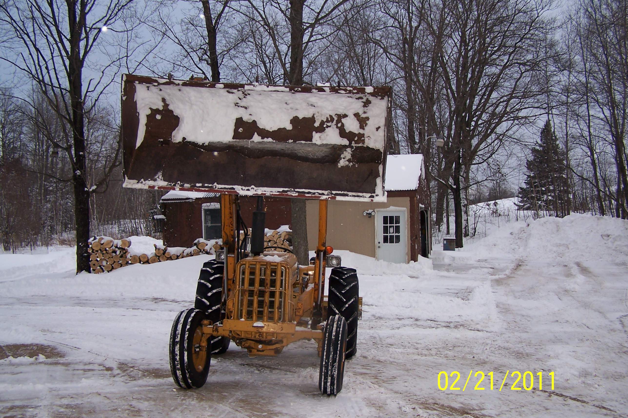

International 2500a with Loader

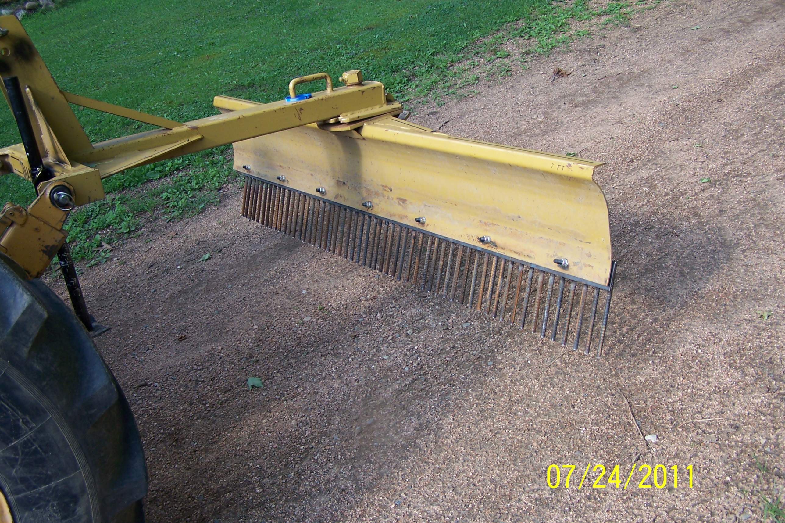

this is my international 2500 ready to go to work.i did some yard work there was a lot of small rocks so i took my back blade and turned it into a landscaping rake,it got the job done.

Nice tractor. Those things are beasts! Can you give some more info on the conversion of your blade? It looks pretty cool.

i took the bolts out that held the grader blade on the back blade and then cut a piece of 3/8 the length of the back blade and welded the re bar rods every 1/2-3/4 inch apart.then drill the holes to match back blade and bolted it on back blade.i hope i made it clear if not get back to me.Ron i did have some bend just welded new ones on.it worked better then i expected.
