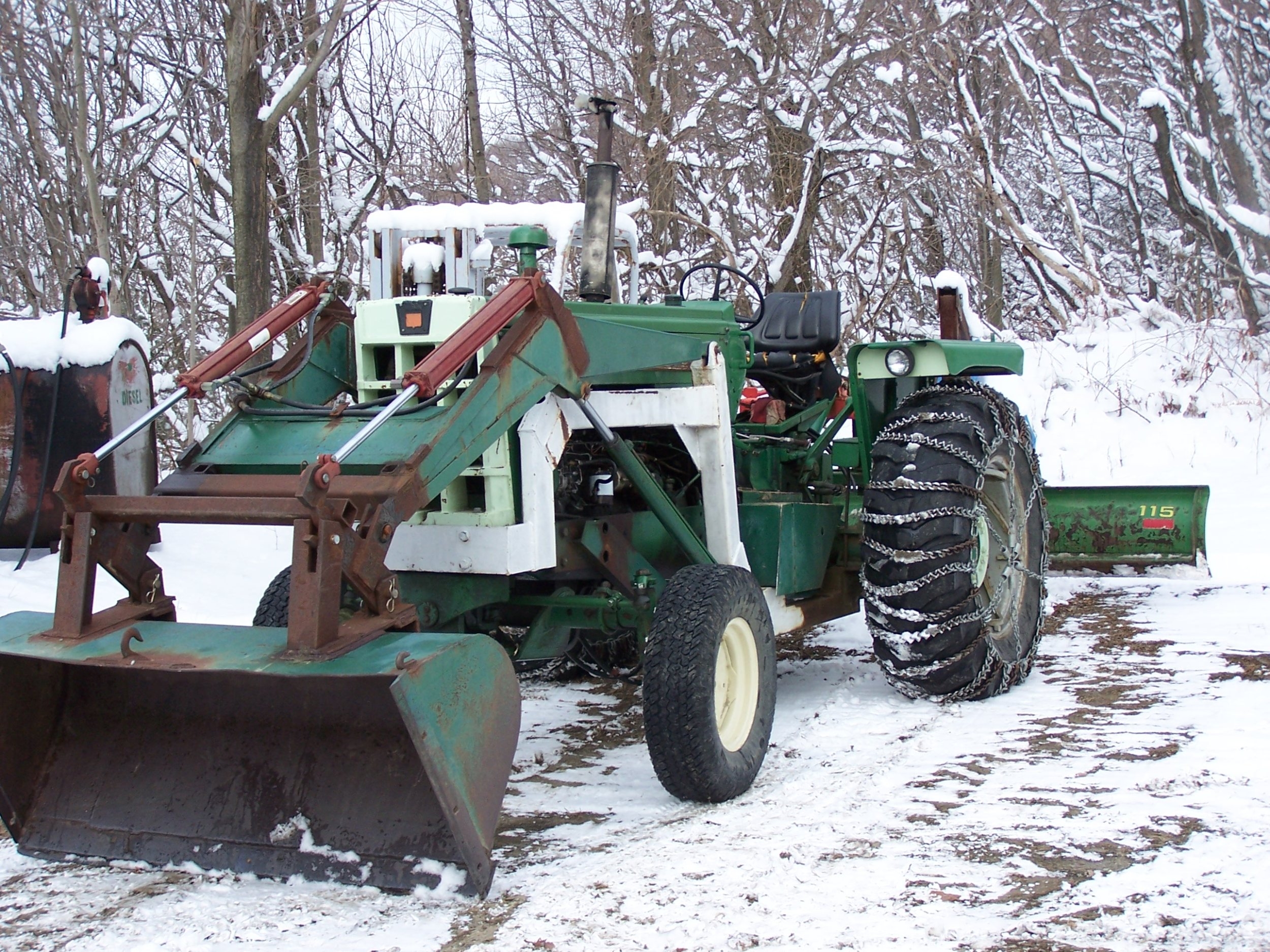

I used 2wd tractors for many years for my driveway work and snow removal. My driveway is mostly steep 14-16 degree slope, on ice 2wd could be a handfull to stop, often had to use the bucket.
The new style Euro studded chains do a much better job then any ladder or duo-grip could do.
Oliver 1550 and an IH 574

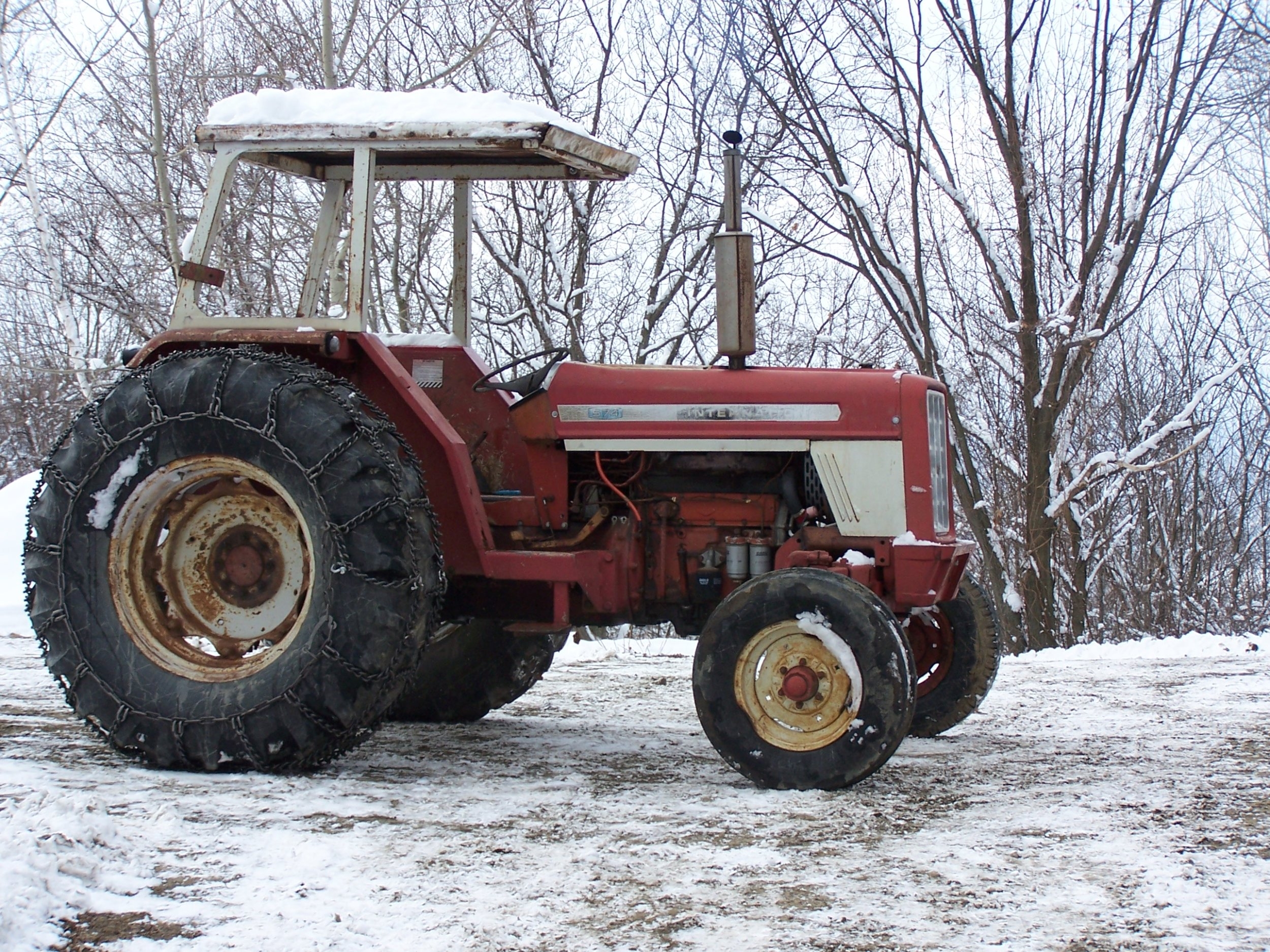

Hi there! My husband and I just bought a 20 acre property. We will be moving our horses there in a few months and also want to try our hand at the homestead thing.
We are looking for a tractor for our new farm. We will generally be using it to brush hog the fields, move round hay bales and plow/scrape snow (western NY winters.)
There are two older (1960s) tractors that we are looking at that are approximately equal in price ($3300-$4000.) All else being equal (assuming they both start and drive) is one better suited for the job than another? Is there any particular advantage/disadvantage to either (known issues, hard to get parts, etc?)
#1 - International Harvester 2424 - comes with bucket
#2 - International Harvester 606 - comes with bucket and forks
Thank you for your help!
2424 is more like 404 - 40 hp 4 cyl gas the 606 is 60 hp - 6 cyl is this gas or diesel both were available for 606. Parts are available as stated. Manuals for repairs available, tons of YouTube mechanics you can follow that work and restore these tractors. Cheap horsepower over compact diesel’s 4wd. Biggest thing to check is hydraulics, brakes and clutch. If hydraulics work power steering will to. You have to be mechanical inclined to keep these units running. Not like today’s compact tractors. Both tractors are heavy so don’t plan on running over septic field with these tractors. Where as compact diesel is lighter. Pick your challenges wisely, it was stated well these are 50-60 year old tractors they need tinkering with to keep running well. Much like old Volkswagen air cooled motor.
   / International Harvester Comparisons #30
The topic of 3 point hitches has come up, so I will add that the 2424 industrial may not have one.
That would be a deal breaker for me.
Also, if a primary use is moving round bales, make sure the loader can handle it. Otherwise, older IH machines are well built and easy to work on compared to modern machines.
