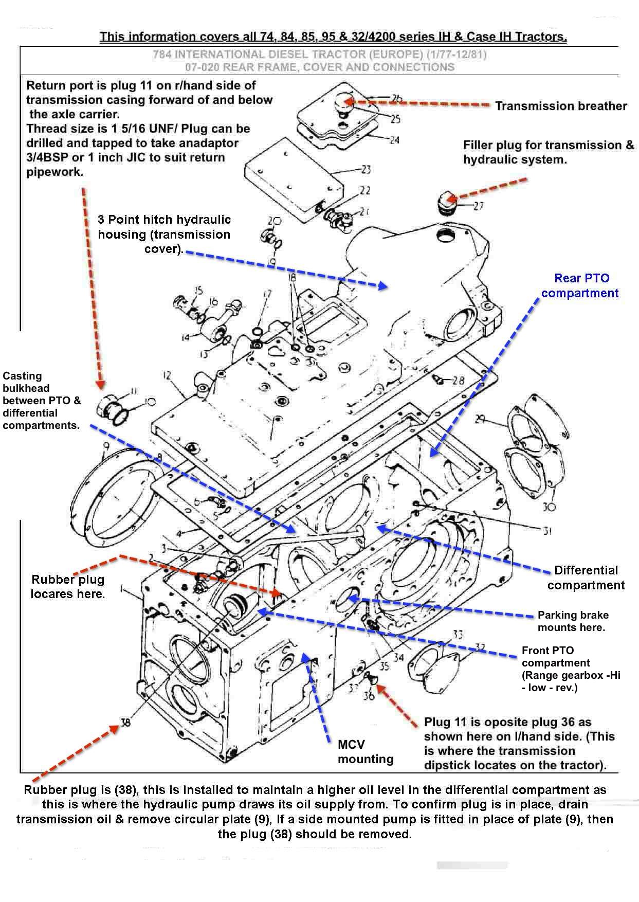

I will post some documents later, the correct way to supply loader from the (HPCO) high pressure carry over, which fits on the end of the valve bank, ( may be there already) and the return goes to the bottom of the transmission case, a large 1 5/16 AF plug under the r/ hand axle carrier.
This reduces noise and heating and ensures longer pump life by reducing cavitation and turbulence in the hydraulic system.

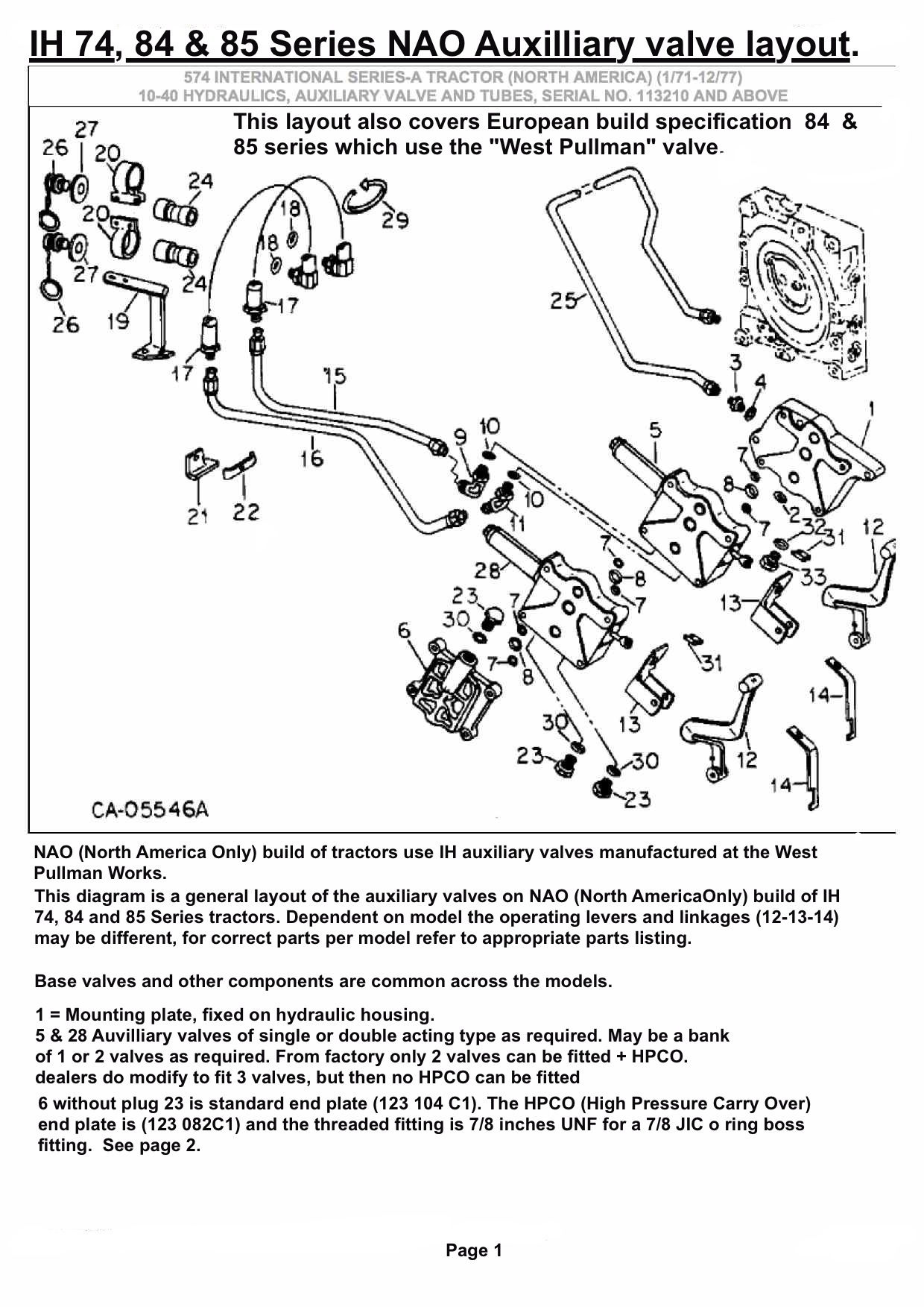

These att's show how to connect the loader using the HPCO and where to return oil !!
  • 74 & 84:85 series NAO Auxilliary valves.jpg
Thanks a lot for your att's they have solved my problem as where to connect the flow and return, much appreciated my friend. Will have to adjust the connections asap. If only I can get the flow problem sorted now.

The High pressure carry over (HPCO) is the correct method to supply oil to a loader or other valves
mounted on the tractor!!
How many spools are fitted to tractor 1or 2 ?? Question?? If loader is supplied from the SA valve, where is the return piped to ??

You seem to be the guy to contact regarding HPCO and IH 784 tractors. I installed the HPCO end plate on my S/A valve and routed to an external valve. The tank line is routed to the transmission plugged as commonly suggested. Also, there's a power beyond port on this external valve which is currently dead ended. I will tie this to my loader valve (a second external valve). The purpose of the first external valve is to add a pairs of auxilliary outlets. After a test run, I have flow coming from the HPCO (after cracking a line), but no high pressure. 3 point, steering work fine. I don't quite understand the HPCO. Normally this is plugged off. So if adding a HPCO end plate is same as adding an end plate with a port, why doesn't the tractor pump dump over relief valve when the HPCO is plugged or capped off (or in configuration with original end plate with no port)?
