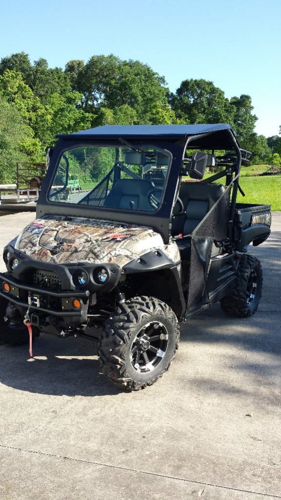

Well got the pictures posted but the orientation is all messed up. How do you get the pictures straight.
I'm guessing that you are using a phone, For the one that is upside down, rotate the phone the other way.
I rotated your pictures with Paint.net.

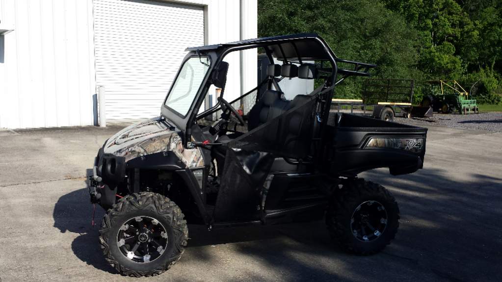

Dixiedog if you get a chance some detail pictures of the guards would be great. I'm still trying to come up with how exactly I'm going to build them. It will be a fun project once I get started. I should finish modifing the basket this week. I might haul the Intimidator to Houston in a couple of weeks so I will have more time to build the guards over the weekends. I only have a couple of hours during the week days to work on it. On the weekends I travel to Houston Texas to be with my wife. Another 6 months to go.

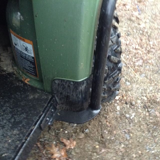

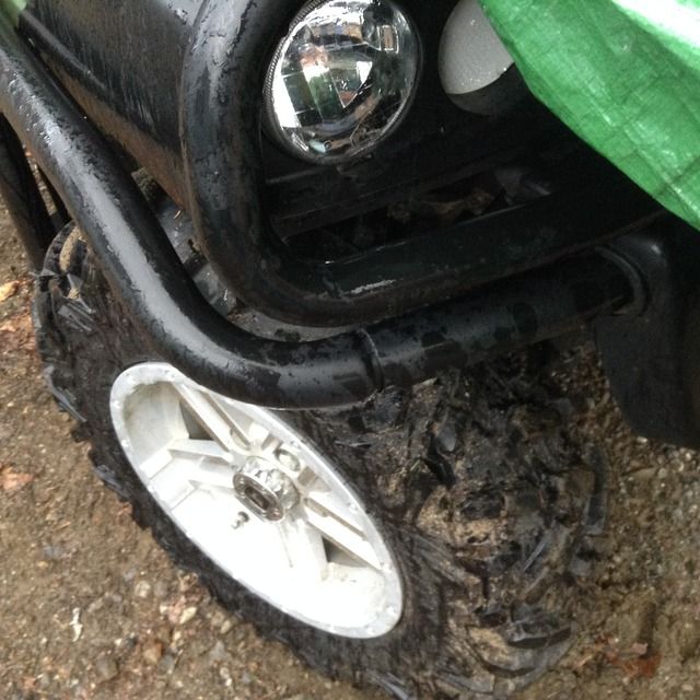

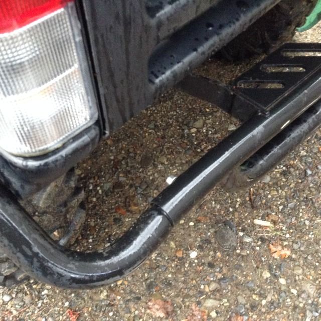

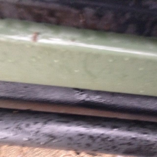

Here are a few pics, it's raining buckets so there are limited views but I think you'll see enough to give you a solid plan.....if you need more specific views or better pics let me know and I'll see what I can get you
Front rail coming off front bumper....the side rail just slide in the bumper and has a single bolt locking it in
This is how the front rail is hooked into the floor pan.....2 bolts with nuts there
Rear rail slipped in rear bumper and held with single bolt also....don't mind the odd fit my rear bumper is in a "V" shape originally it fit perfect. lol
This is the amount of clearance between the rail and rear bed....approx. 3/4"
This is where the rear rail bolts to the bed frame....two bolts here as well....when I power tilt my bed the rear bumper...bed and side rails all come up together

I like those rub rails - I wouldn't mind making a set for my Pioneer

Thankyou Dixiedog for the pic's, they look like they will be very helpful. I'm hoping to get started next weekend on the guard rails. This week will be finish leveling the basket on the back of the roll cage. I'll take some pic's when I get level & attached.

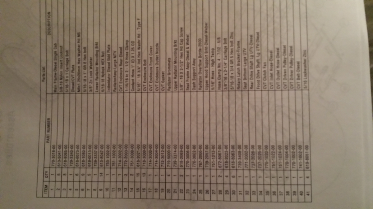

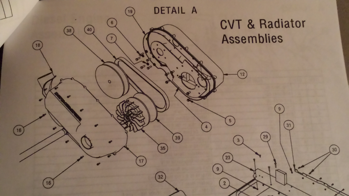

Poorplowboy, I attached pic of the clutch assembly from the Intimidator parts manual. Is this what you wanted to see?
   / Intimidator, 1000 cc Diesel #26
That helps. It appears to be much better designed than OEM Polaris clutches. I was hoping for a "live picture" to see if the belt stays tight and engaged to the primary sheaves full time or if the belt "floats" until the rpm rises enough to squeeze the belt in the sheaves.

The body rails really are a good idea for those of you that use your UTV's for what they were intended for. Me, I just haul a wiener dog and weed whacker around.
   / Intimidator, 1000 cc Diesel #28
I'm partly in that boat. I think it has more to do with your definition of UTV though. I bought my UTV specifically because the plastic body panels don't ding and dent like the body panels of a real truck. I have had some pretty decent impacts that have knocked the plastic loose, but it always pops back into the retaining clips like new. It doesn't seem I can hit anything hard enough to actually break it with my work related uses.
My definition of UTV is "UTility Vehicle" to do work. Some folk must think of them as "Ultimate Terrain Vehicle" and go at things like a tank or Baja racer...
When looking at it from a work vehicle perspective, all I can think of "100# of extra steel tubing is 100# less firewood hauled" and have a hard time thinking much past that... Beyond that, I always understood part of the safety factor of these sorts of machines is the way they pop apart when they take an impact (sort of like the crumple zone of a car). Mounting all these tubes and extra framework to the machine is going help the machine take the impact damage free, but is going to transfer more of that impact to the occupants...
   / Intimidator, 1000 cc Diesel #29
I have a Mule Fxt I use for work like hauling wood and such but my Pioneer is for trail riding and exploring so that is why I would like to build some for it . The rails are real handy in the tight woods where they allow the machine to pivot around trees in tight turns and if you ride rocks they something allow the machine to slide on rock faces where the machine panels would take a beating. Heck one of the first things I did to the Pioneer was pull the sway bar to gain a bit more travel, something that would be a bad idea on a work machine. All depends on what you use the machine for......
   / Intimidator, 1000 cc Diesel #30
I realize that there are many makes and models that are for pure play or work, with many models falling in between. I would say my RTV is a work model that I use for play. I've have had a ton of ATV's and as I got older I started thinking about a UTV. Thought its a work machine it was more up my alley as to what I wanted. I do think that if you are running thought heavy woods or working around cattle or livestock in general the rails would be a good investment.
