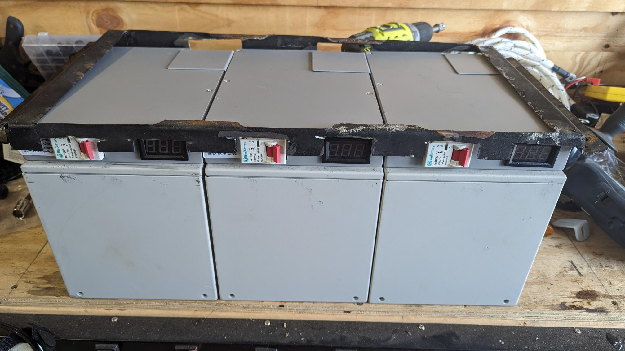

The batteries sit like this: 1 front to back, on the outside, then 3 left to right, stacked next to each other. This is repeated on both sides.
The battery holders needed to be modified slightly, with a little grinding and bending. The 3 batteries are about 3/16" wider than the holder, so I bent the ears a bit. Also, these batteries are connected using a forklift type plugs, on the side, so I had to cut the holders to make room for that, and there is a breaker and display on each battery, again, a little cutting and grinding to make room. The single battery holders just needed to be cut and ground to make room for the connector and breakers.
One of the tricky bits is that the motor is offset towards the driver's side. Through trial and error, I learned I needed to connect the plugs to the batteries before dropping them in. There is also limited space to cleanly wire manage the cables. So protect them, I double or triple loomed the cables. I put 1/4" loom over each cable, then put 3/4" loom over the two cables with loom on them already. Where the cables might rub a sharp area, I added a third loom of 1".
As a side note, one of the great things about working with Lithium batteries, is that they come with circuit breakers, so I could kill the power, and work with wires, without worrying about causing a short, etc.
I dropped in the batteries on the passenger side, and that has plenty of room. I still double loomed those, just to be safe. Also mounted the connector for the charger. There is a stock cable that runs from one battery bank to another. That was used to connect the controller to the negative side of the bus bar. The positive side of the bus bar connects to the stock location for the fuse and relay for the controller.

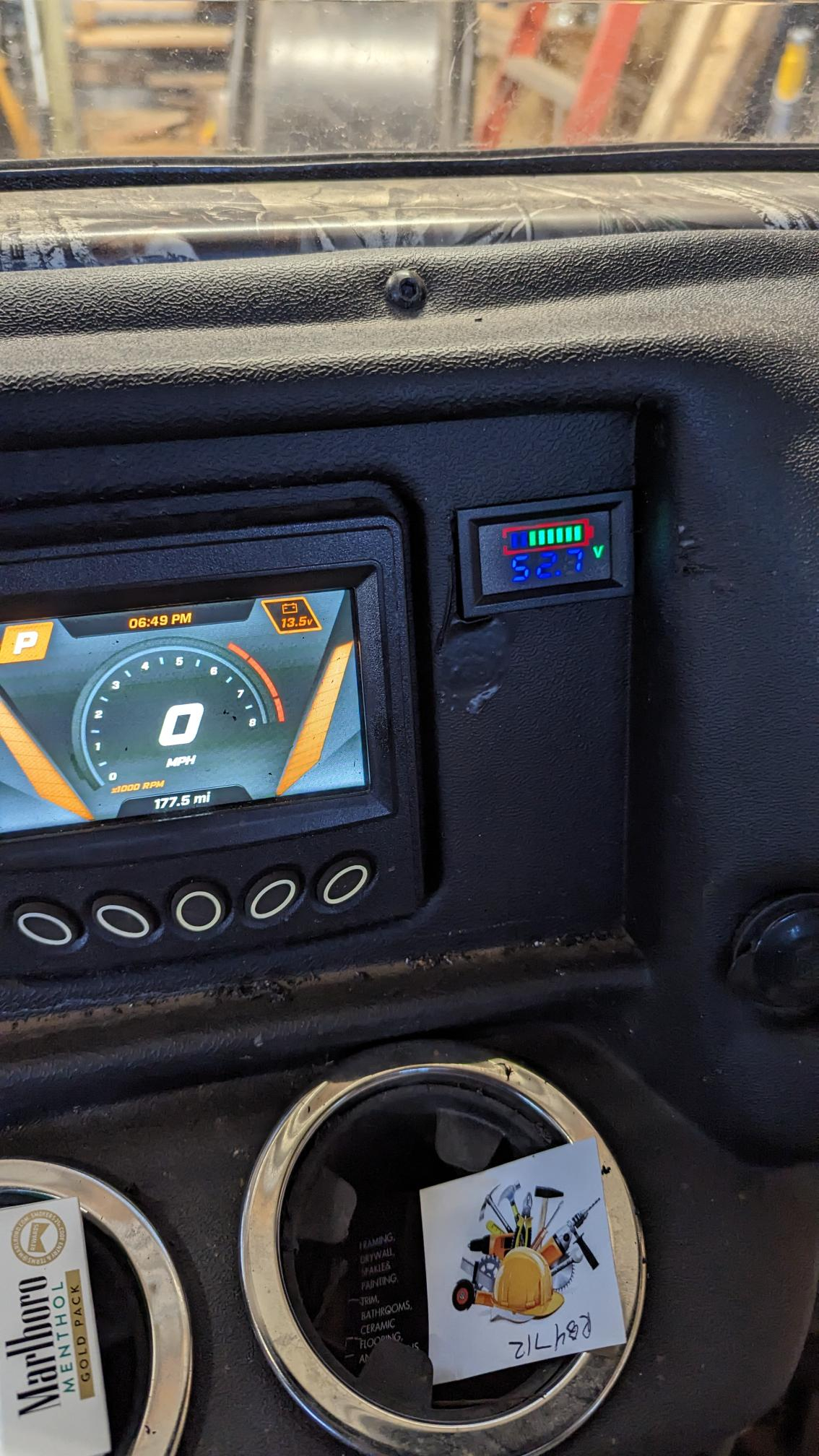

Next I ran the voltmeter to the dash.

I then braved out into the wide world for a run down to the local deli. Machine ran flawlessly and after a round trip of 12+ miles, through some large elevation changes, I came back home with at least 50% charge remaining. Lithium are hard to get an accurate discharge on, but in my case 52.8 volts = 70% charge and 52.4 volts = 40% charge. I returned with 52.7, so less than 70%, but more than 40%,so I'm calling it 50% to be conservative.

I,too,used lithium batteries from Big Battery to replace the worn-out lead acid batteries in my Polaris Ranger EV. Well worth it for many reasons. I did find that the included SOC (state of charge) meter was worthless, with lithium batteries one needs a "coulomb counter" type meter for useful results. I have a voltmeter and just rely on it and knowing what the battery voltage means in terms of available capacity. I really like that they use Anderson style (forklift) connectors, makes disconnecting them for service a breeze. I use electrical contact grease on all the connections, can't hurt with connections exposed to outdoors conditions.
