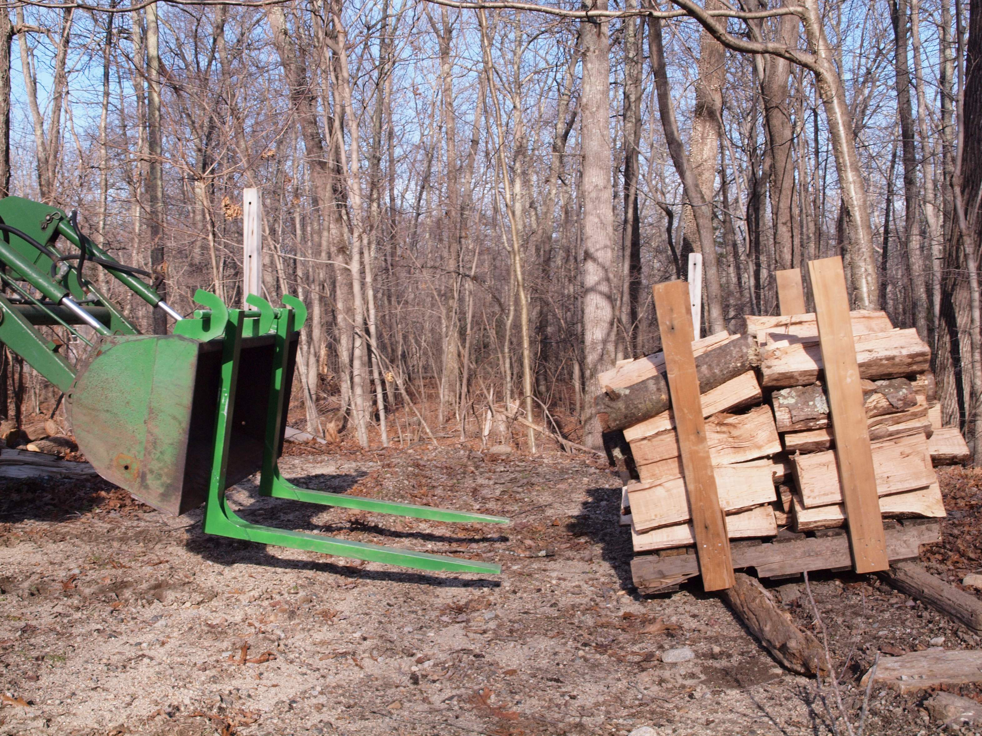

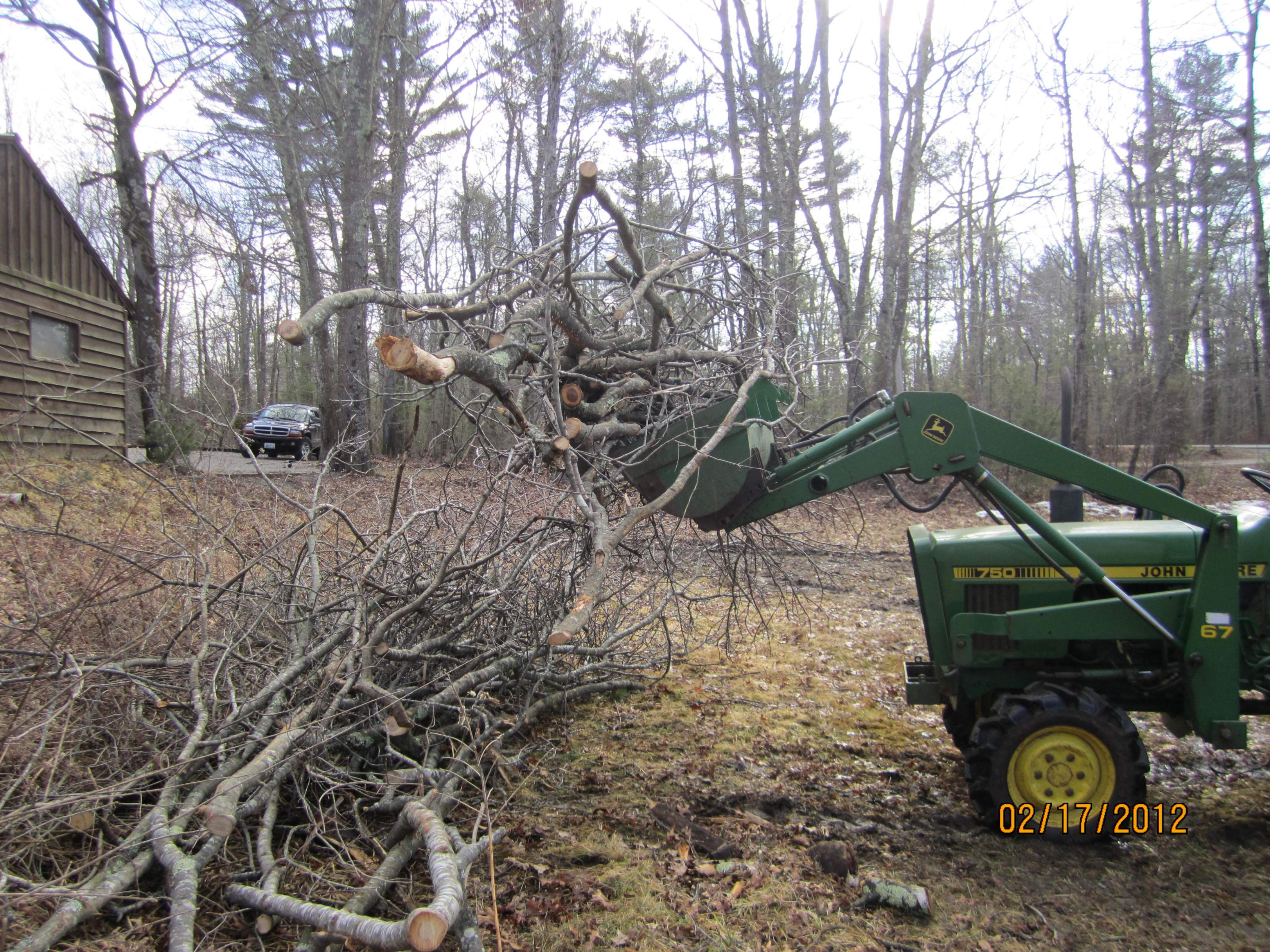

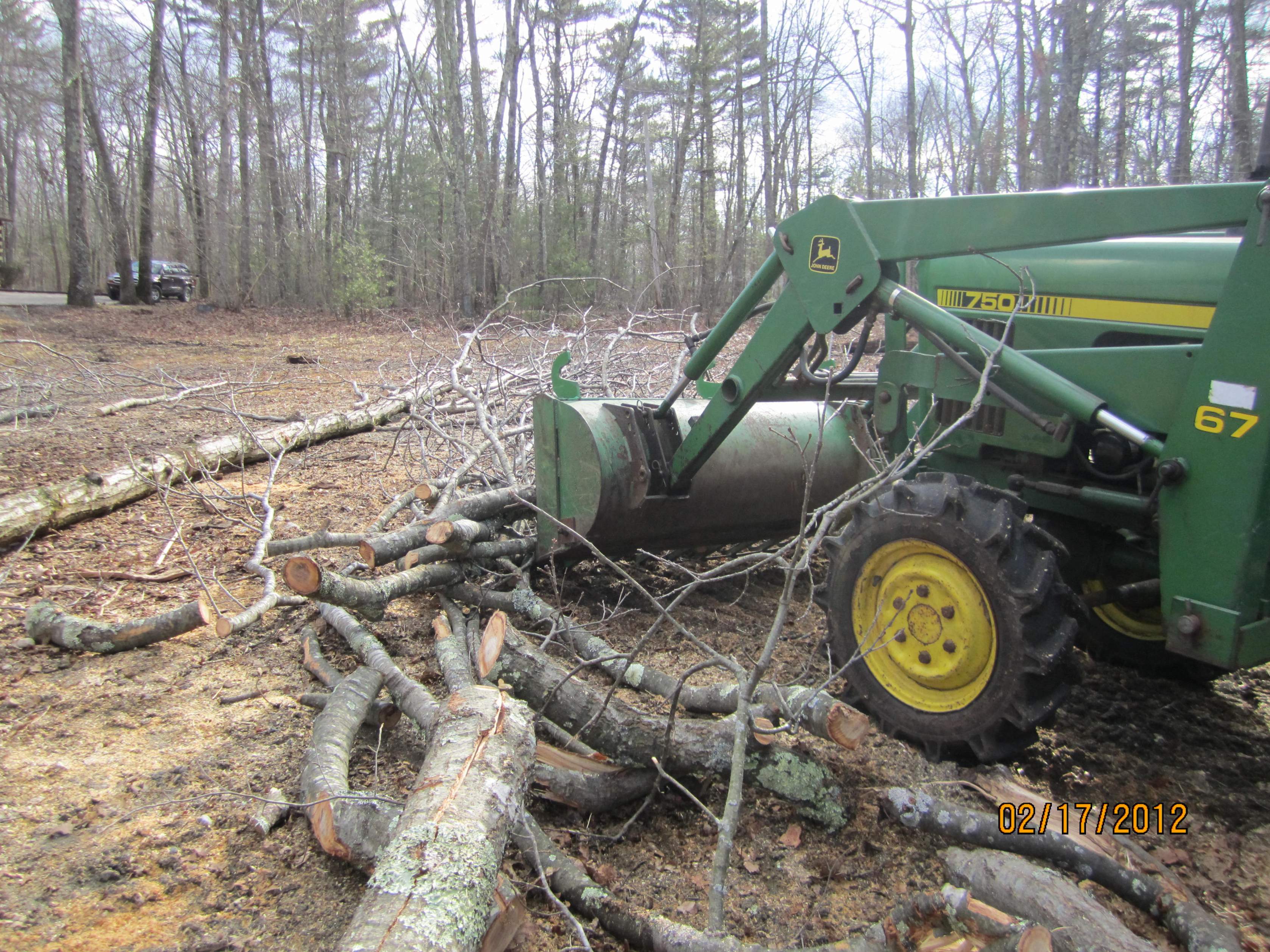

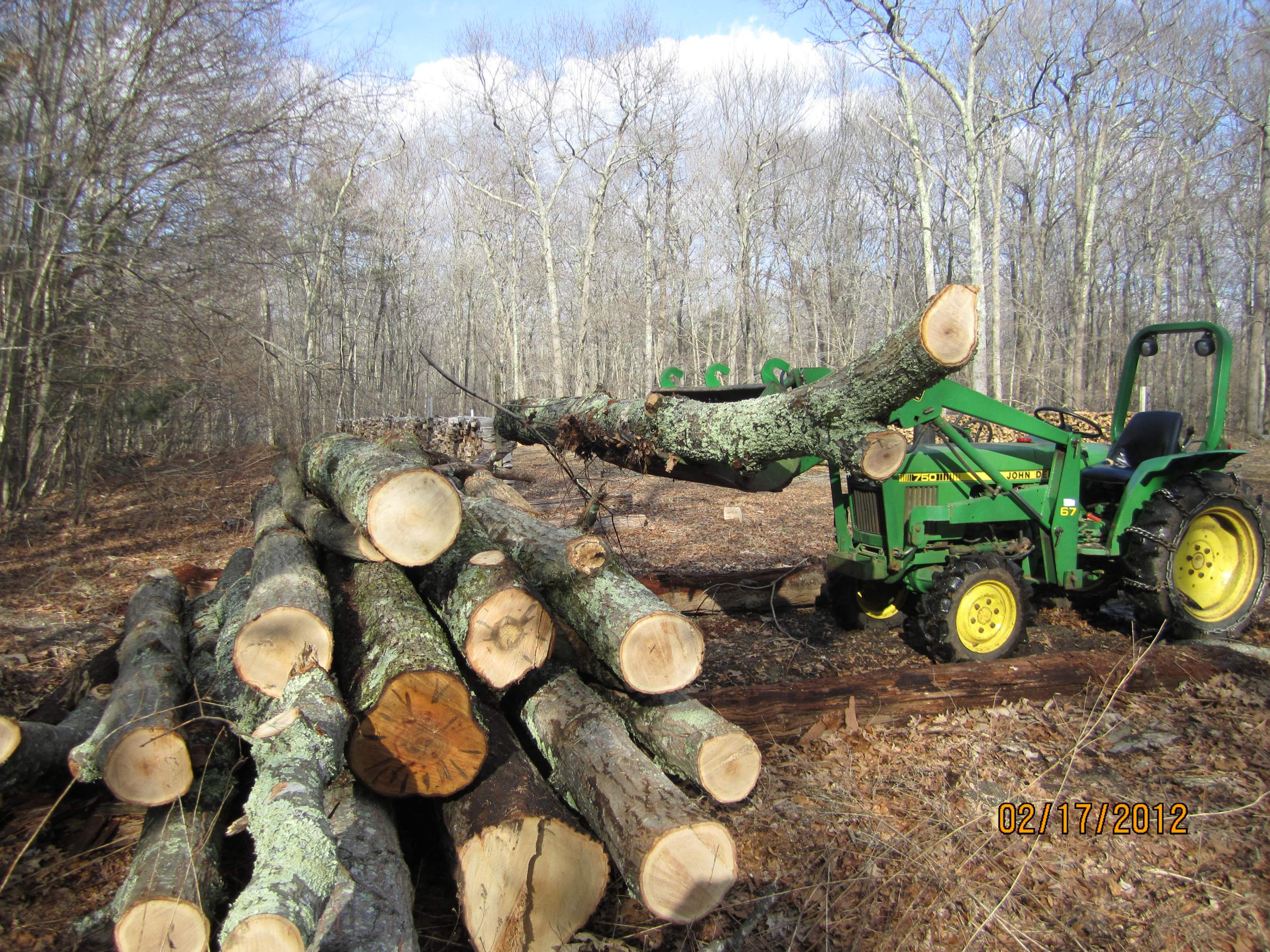

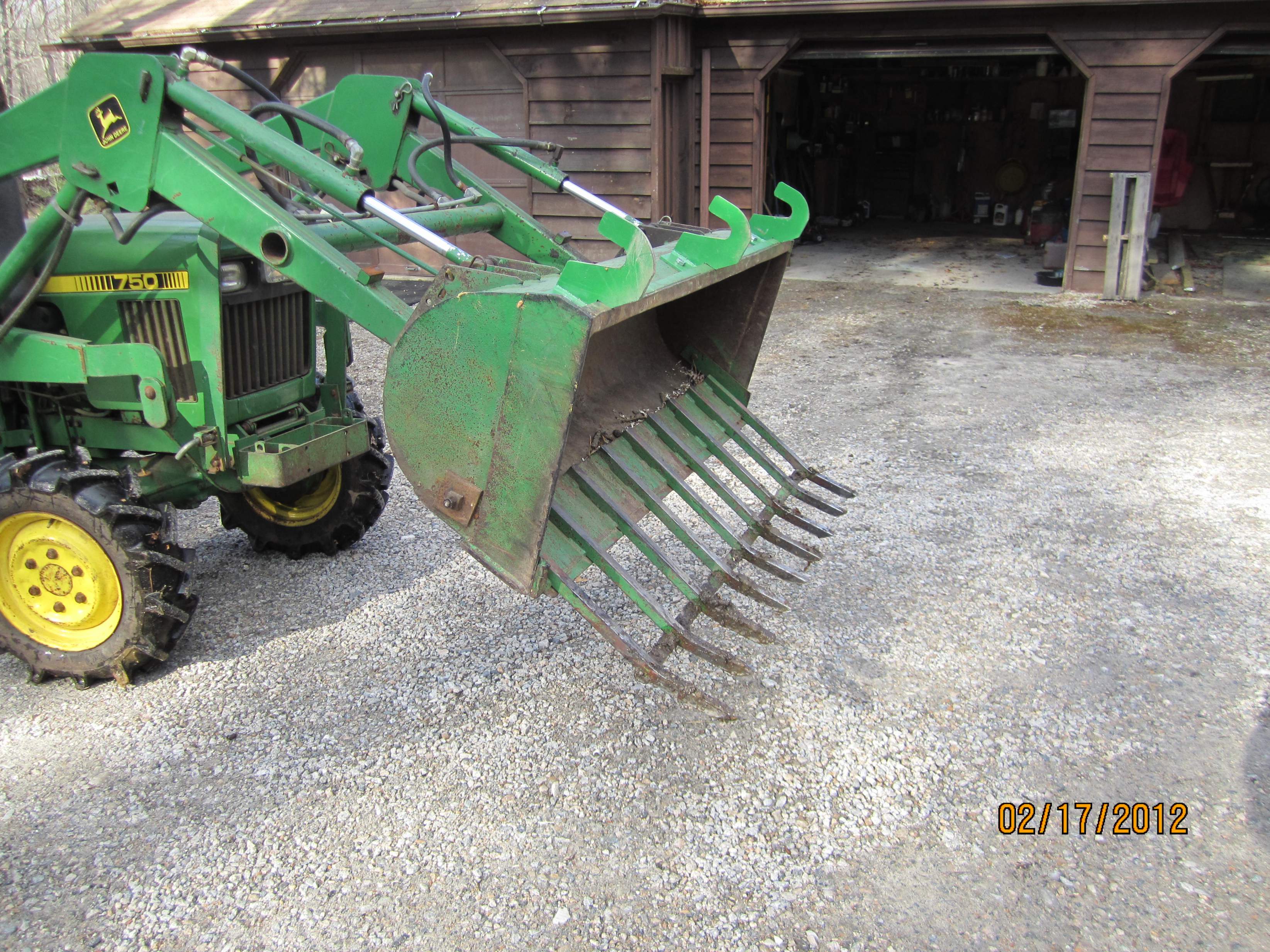

First if they say necessity is the mother of invention, I need a new mama. I do not have a quick hitch. I have a pin on bucket. Now a days, the bucket is used the least of everything I have but it has an important role in that it serves as a mounting platform for tines, teeth and forks. As I skid logs in winter, I need an attachment that A. is able to pile logs, B. is able to plow snow better than what a bucket can do. C. can mount forks to. D. can make any of these change overs in seconds. I wish I had C.A.D. to show what this might look like but I'm thinking of a 4' wide "blade" used to pile logs and go through the woods easier that one can quickly pin on snow containment sides (sort of like a snow pusher) that make it 6' wide. I already made dismount forks so that's the easy part. Its about how this can curl and hold a tree stem without getting in the way of plowing snow. Any ideas would be welcomed.

No you are right about the forks. They would have to be removed and not part of the attachment process. The forks would be mounted to the blade and as a result would actually increase lift capacity as they would not be sticking out so far as the current bucket makes them do. I cannot use the forks for stem piling as they have cut my loader lift drastically.

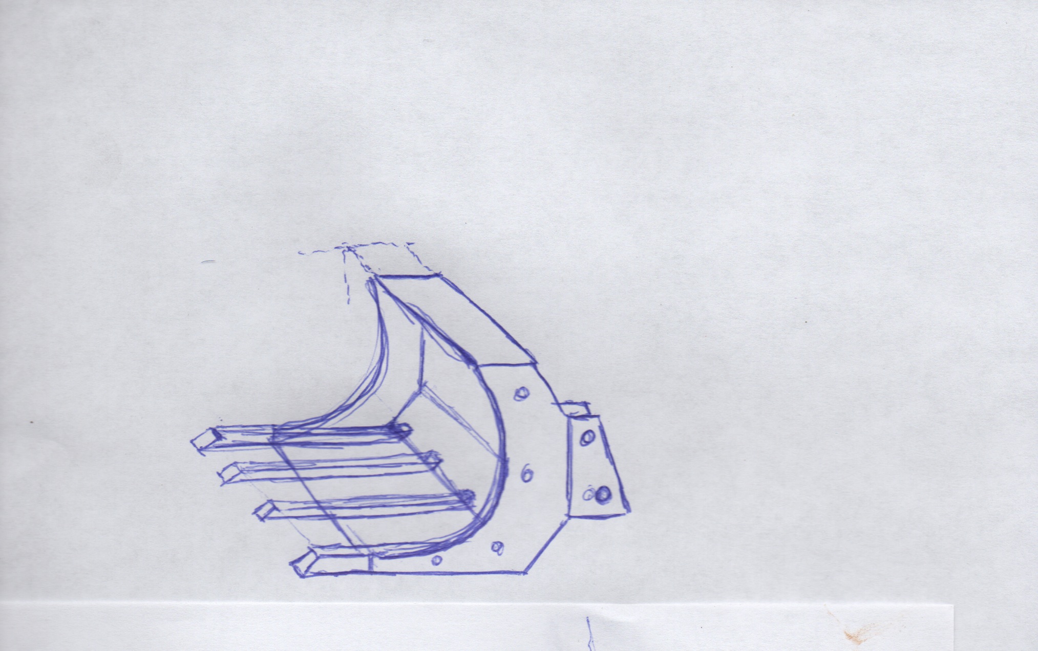

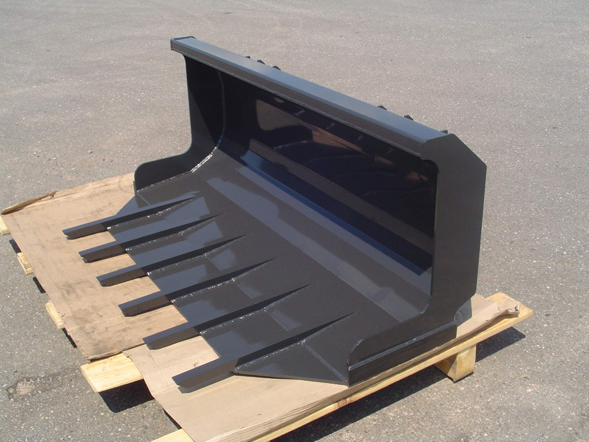

I wrangled this sketch to show what I had in mind. This is the all around bucket I'd probably use the most as I hardly use a bucket for material. This bucket would only be 4' wide with the ability to attach 1' wide sides to make it into a snow pusher. This bucket could roll tree stems and curl them up for piling. I'd never take it off as it would even suffice for a makeshift materials bucket. Have seen buckets close to this but they are over $1000. I could probably build this for half that with 1/4" stock

that looks like a rock bucket but that should do what you wont it to.

View attachment 298986 Ahh, Looks very familiar!
It does but there are things that need to be changed on my design. For one the teeth need to be curved upward about 30*. This makes flipping a log into the bucket much easier. The second thing is if wanting to also use this as a snow pusher, provisions for extensions of about one foot per side are necessitated along with the extensions themselves.
