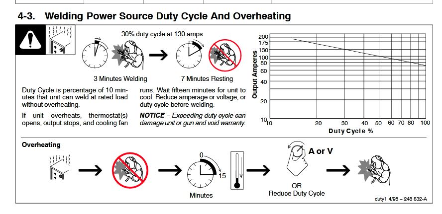

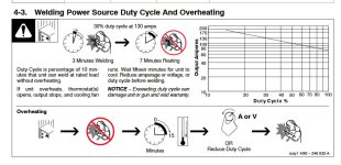

Check out the cost of the circuit board price. From what I see, you will pay (conservatively) between 200-300 dollars for the PC board, rebuilt.
The unit only has a 3 year warranty on the PCB board. Point is that if people have concerns about electronic failures on inverters, they are not exempt on transformer models. Electronics are electronics.
And the duty cycle stinks. Big time. They sell it as a 190 amp machine and it is really a 130 amp welder at a decent duty cycle. 190 amp is in theory only. And if you overheat it, the baby is yours according to this chart. Honestly, it's sort of like saying (back in the day), "Hey, I bought a Cadillac for cheap, and it was a Cimmaron."

+1 on the over rated small transformer Migs. The numbers keeping inching up on the front panel but most are way over rated. I remember the Lincoln SP100. one of the 1st 115v migs to get the market rolling. It put out 90 amps actual. within a couple years they were calling it a 125, then a 130 and now they call it a 140 but it still only puts ut 90 amps actual. If you are a non believer put a set of DC Tongs on the ground while running wide open. 90A.. Try it with any of your 200-211-212 machines. I think you will be surprised to see that they are 150-160A output.

87% of Buyers, or 9 out of 10, (74 in sample) on Amazon give the 220v Hobart Handler 190 a 5 star rating.

The first Hobart small transformer welder was built by Neil Hobart, in 1897 (121 years ago).
Hobart small (220v) transformer welders are still being built by Miller/Hobart.
The Cadillac Cimmaron was built for only 6 years, from 1982 -1988. Last Cimmaron was built 30 years ago.
Do you really consider THAT a valid comparison?

Hobart 190 welder should weld at 190 amps if needed. Even if it trips the thermal over temp switch eventually -it should not damage the transformer or cause a warranty to be cancelled unless done repeatedly.
Some of these transformer Migs seem to be rated conservatively - as an example the HTP 2400 when it was tested by Chucky 2009,
ran it at 200 amps virtually non stop for hours even though that is 60 amps over it's 142 amp 100% duty cycle rating. Obviously a higher dollar mig @$1500 but built very well probably last last decades.
For Low duty cycle, the new HF Titanium comes to mind -one model has a quoted 15% duty cycle at it's rated max amps.
And a full 90 days of warranty.
